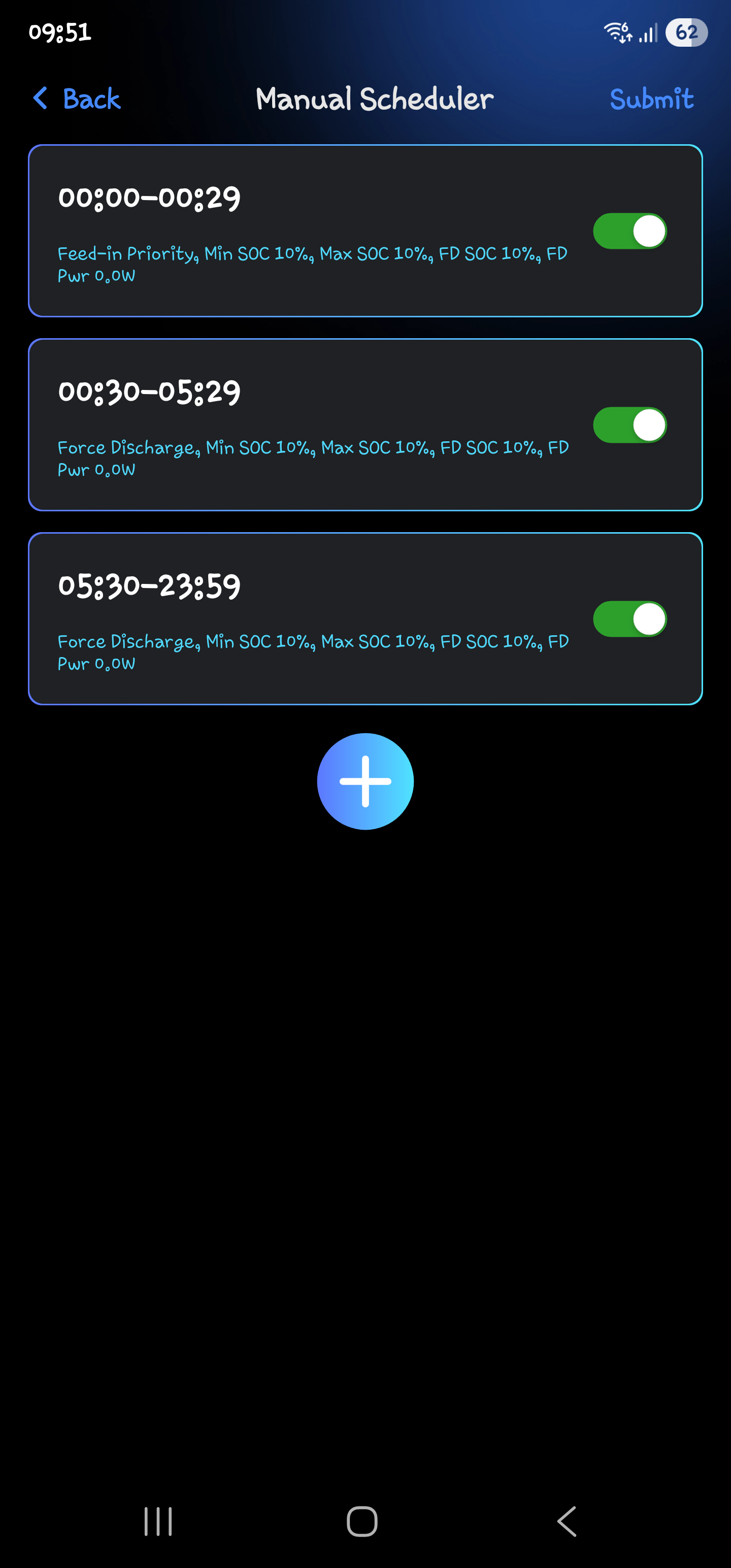

I had set the scheduler to Octopus Go tariff yesterday evening, and shortly after midnight I had to set the 00:30 - 05:29 Charge window again, as it had swapped to discharge.
When I woke up and checked scheduler again in the morning, it had set itself Force Discharge in slots 2 & 3 of the scheduler as seen here
I then decided to try and remove the schedules via the foxesscloud website to see if this could make a difference (as I usually set via phone app.) I am trying this way to see if there is some bug in the phone app (for me) or maybe it "sticks" better if I set via the cloud website.
It kind of worked, as when I first checked on the phone afterwards, it had set the 3x schedule entries, but with some odd settings. At first when I looked on the phone, it had all 3x schedules set with FD SOC as 20%, and FD Pwr as 100.0 W.
I corrected these values, to what I think should be correct, and have this now saved.
EDIT: I left the phone app for about 1hr, and when I checked, it had swapped the 00:30 - 05:29 Charge to Discharge again.
