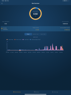

On the app, can you post the overview page when you have turned the heating element on (it takes 5 mins sometimes for the app to show it) and if you could swipe left from that page and screen shot the graph at the bottom of the page - just trying to work out what could cause that i.e. battery performance or similar.
Could you also let us know what batteries you have fitted please.

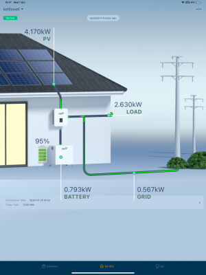

Thanks Dave. 2x H2600s. The older ones I think.
The app screen changes between about 4500w and 400w load. But mostly stays at the lower figure. Even with heating element reporting full power - which should be 2900w. This is a replacement boiler, both had same issue hence why I’m checking the supply. Boiler has a pid controller but I’ve checked and it is requesting 100% power.
With element on full power
Gone up now - batteries almost charged, element on full
Guess this confirms intermittent supply?

Ahh ok, if you only have 2 HV2600 batteries that will be your limiting factor - the 2 batteries will have a typical battery voltage of 102V and the H1 inverter has a maximum charge/discharge current of 30A.
So even on a perfect day with the temperature at 25C the maximum charge / discharge the batteries can provide is 3060 watts (DC), after losses that’s probably around 2800 watts AC that they can support, the rest would have to come from solar or grid - so that’s a yes, definitely make beer when the sun is shining :)
