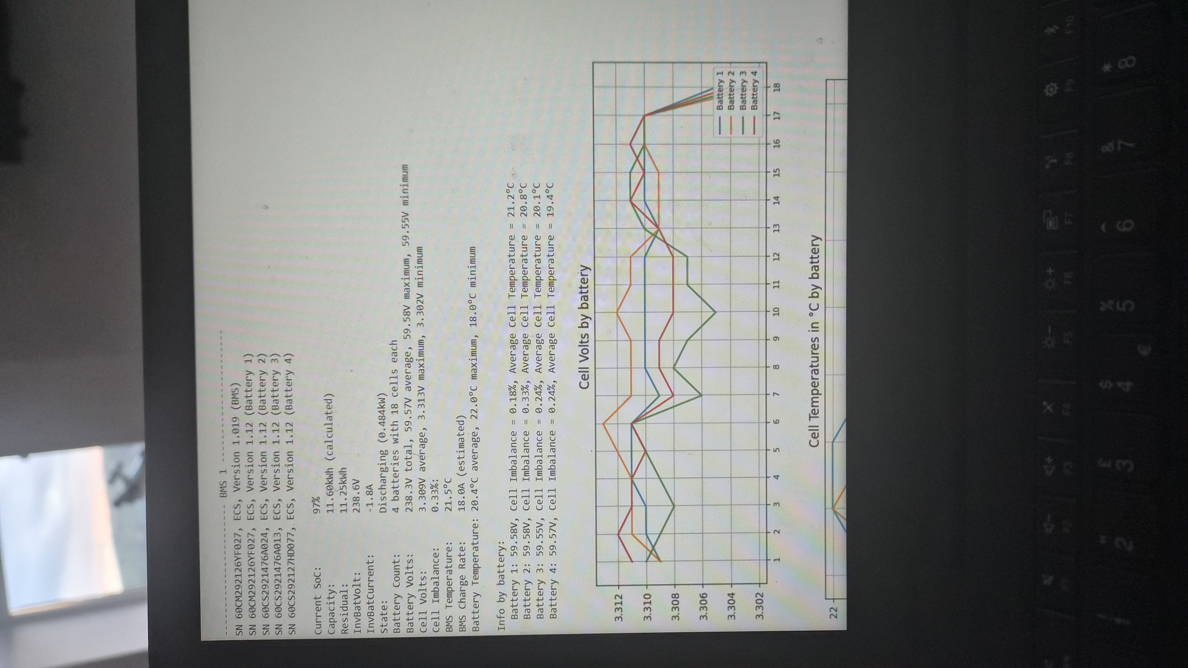

Ive used a tool found on here to check cell voltages remotely but am not sure if its telling me something useful... cell 18 on all 4 battery units consistently is 0.02v lower than the other 17 cells in each unit... is this normal?
Can I just double check you actually meant 70% soc when you added the new batteries? - as the recommendation is 50% +/- 3% a 20% difference will take time - admittedly 6 months should be plenty but only if you have done a number of regular grid charge cycles to 100% and back down to 10%.
The graph you have posted looks ok, cell 18 usually does that - i’m guessing that is an internal design thing with lead lengths or sensor pickups so that all looks fine, but the best time to run the graph is when the battery stock does (or has done) it’s soc drop as that will show which of the batteries (or cells) is falling off - could you repeat the graph when you have the rapid fall off.

The attached shows the cell voltages just as the Soc is experiencing a sudden drop, on this occasion it dropped from 24% to 10% SoC in about 2 minutes when the load/ discharge was only around 500w.

The pack does appear out of balance, and battery 3 cells 13-17 appear to be letting everyone down at the bottom end.

the attached show the voltages after resting at 10% for 6 hours yesterday, not much change on battery 3 which still looks all over the place.
batteries 3 and 4 are my new ones, they are v1 as my master and original are v1, so they dont have battery health or other newer features that the v2 have.
at 100%, those same cells are in line with the rest of the pack, but a different group ( cells 7 to 12) in battery 3 are about 6mv lower
