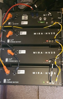

I am experiencing the same problem
I added 2 more batteries and I am convinced the system is only seeing the original 2 batteries
Could you please explain in a bit more detail how you solved your problem
Tx
Steve
Tx
Steve
