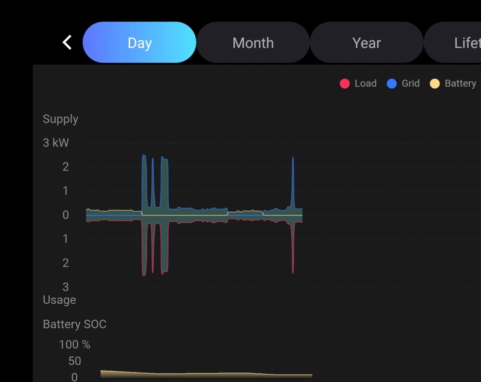

Force Charge though is a different story. I think I have it set correctly in Mode Scheduler - I also read online somewhere that it may also be beneficial to add a short Self-Use schedule immediately afterwards, to force it back into Self-Use mode? So attached are my Mode Scheduler entries, and a screenshot from the app of power in/out last night.
One thing to note is that I did schedule my dishwasher at 2am also, on a 60C "quick" wash ("quick" means 1hr 45min!). Could that be screwing up what's happening? Happy to try it again tonight without the dishwasher?
Cheers for any ideas!

I'm an idiot, sorry - I just realised I cut off the time part of the graph... the two or three spikes close together occurred between 2am and 3am - hope that helps!

I'm really an idiot! And sorry for the confusion... Yesterday's 6kWh during the free session was a force charge, not discharge of course! So now I'm even more confused... Why would a force charge work during the day (I had other loads turned on, immersion heater, kettle, etc), but not at night?!

Still no charge, but I did notice that battery usage for the regular background load on the house dropped to 0, so everything was coming from the grid... Looks like my original screenshot from the other night shows the same, but worth the dishwasher running the other lines on the graph distracted me! Here's the one from last night, scheduled force charge from 02:00 to 04:59.
