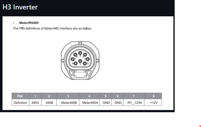

what can be sourced (consumed) at the +12V - H3 invertor ?
Hello
Is there a spec on how much current ( mili-amps/amps) the +12V can deliver on the RS485 plug on a H3 invertor ?
regards
Noel
Mon Sep 01, 2025 2:04 pm
Re: what can be sourced (consumed) at the +12V - H3 invertor ?
I've never seen a spec but believe that it's good for a few hundred milli-amps
