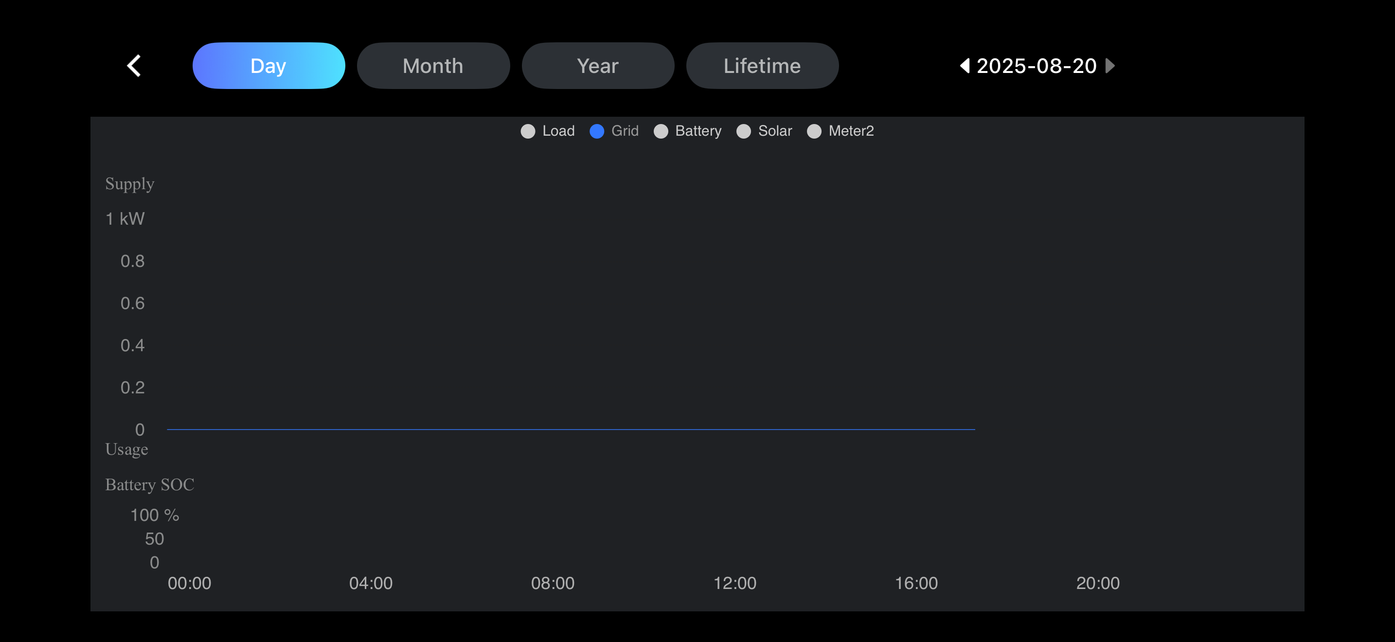

I have had my solar panels for 2 weeks and I seem to have an issue today and can’t understand what’s happened or what the issue is.
My grid input/output has been at 0kw all day even though I have been charging an electric car and had home appliances etc.
I haven’t seen this before so I am slightly concerned, I am new to this so I am a total novice, I have provided some images, if anyone can help that will be hugely appreciated.

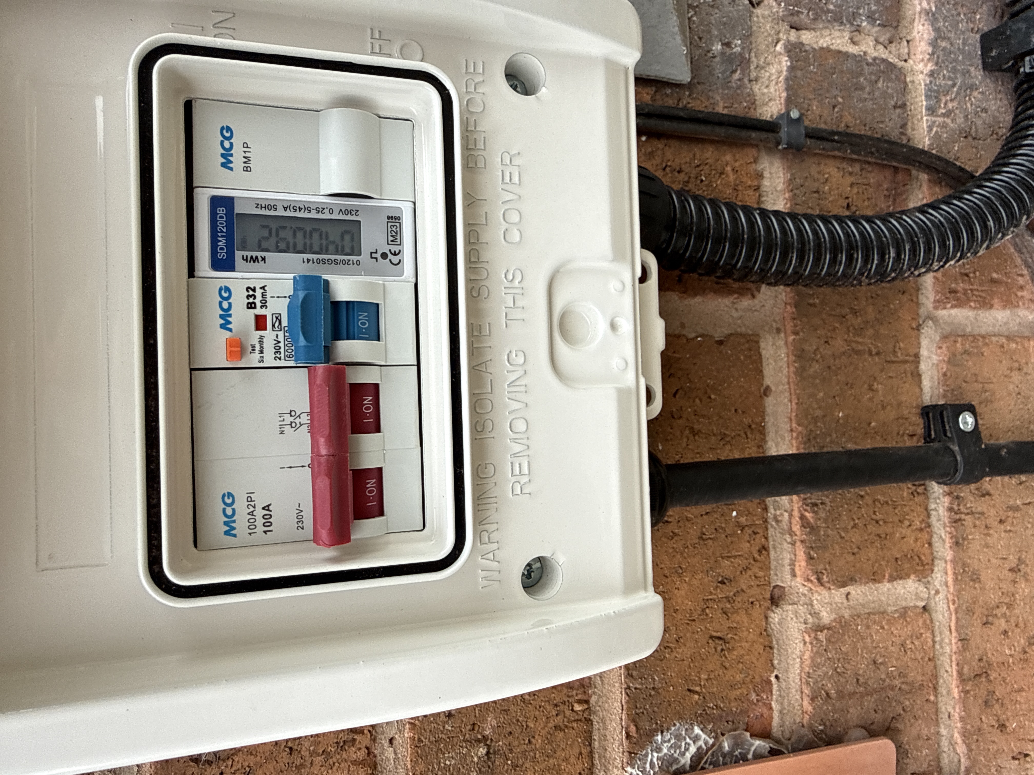

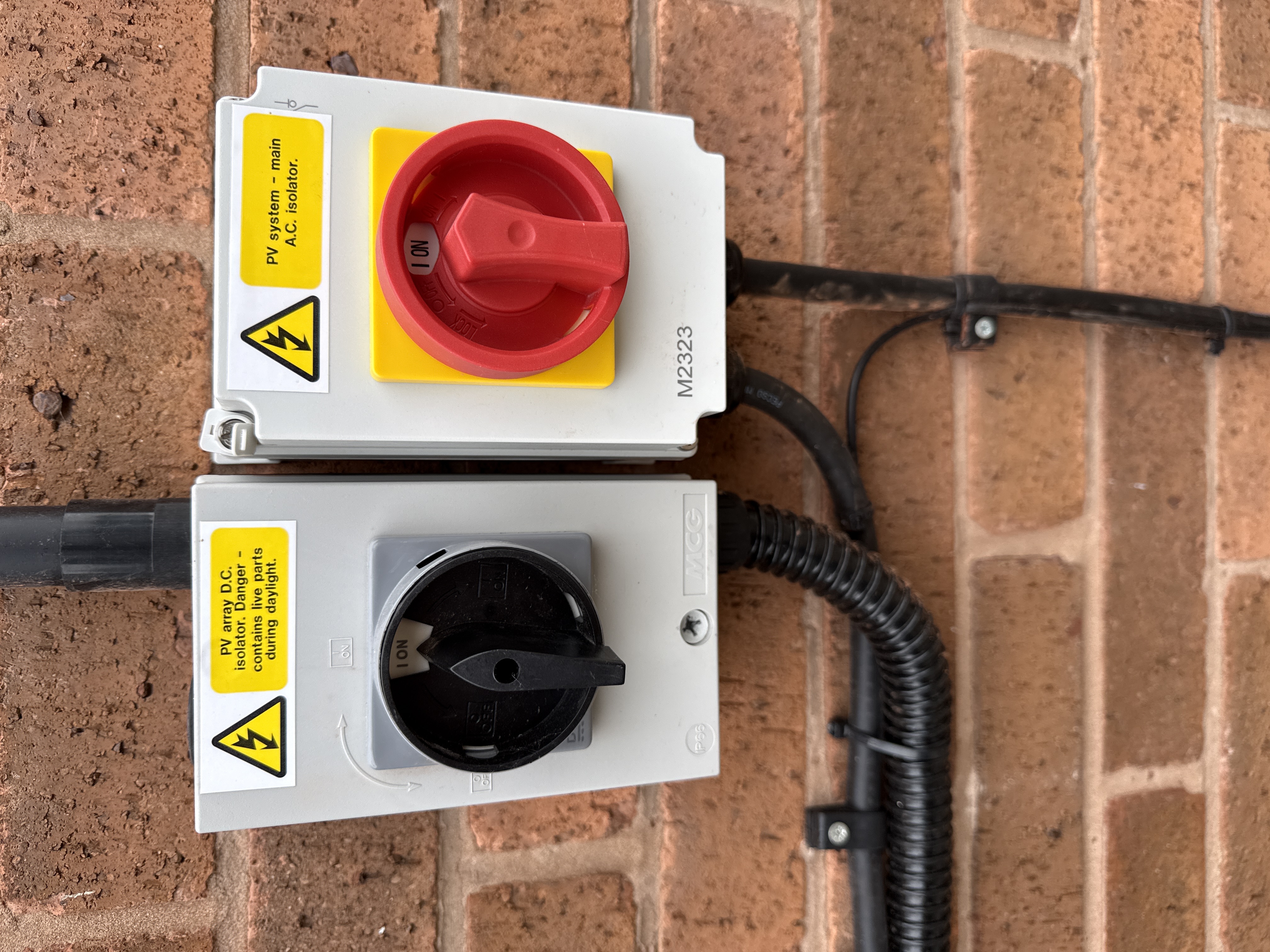

If you are receiving all of those errors together then it is not detecting grid voltage - if they occur when your switch off the system then they are expected but if it occurred when the system stopped working it usually means that a breaker or RCD has tripped or is faulty - it’s also possible that there is a connection problem which will require your installer to resolve.
I’d start with all of the obvious things, are there are breakers or rcd’s that are open ?

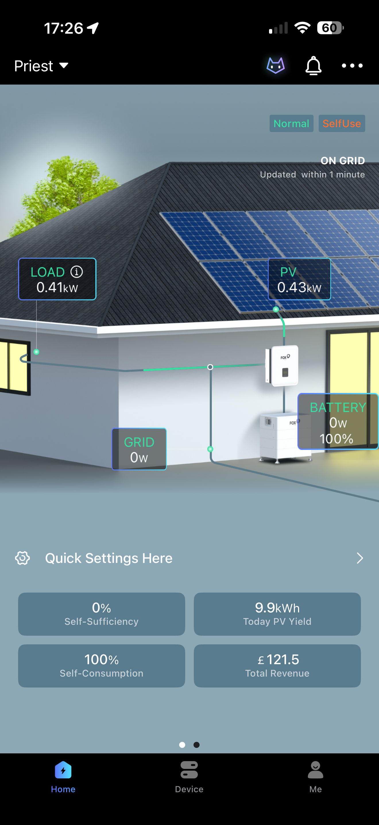

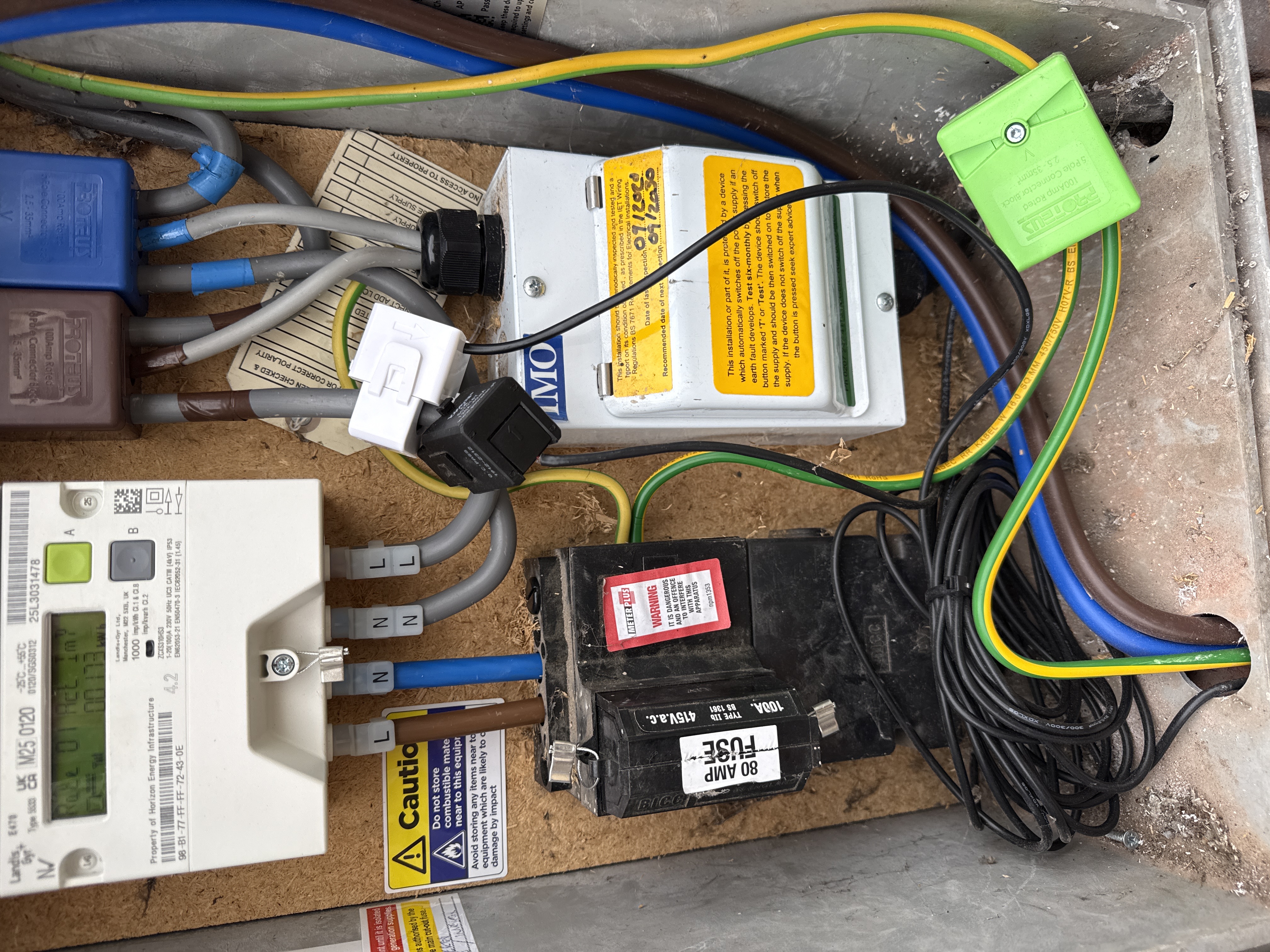

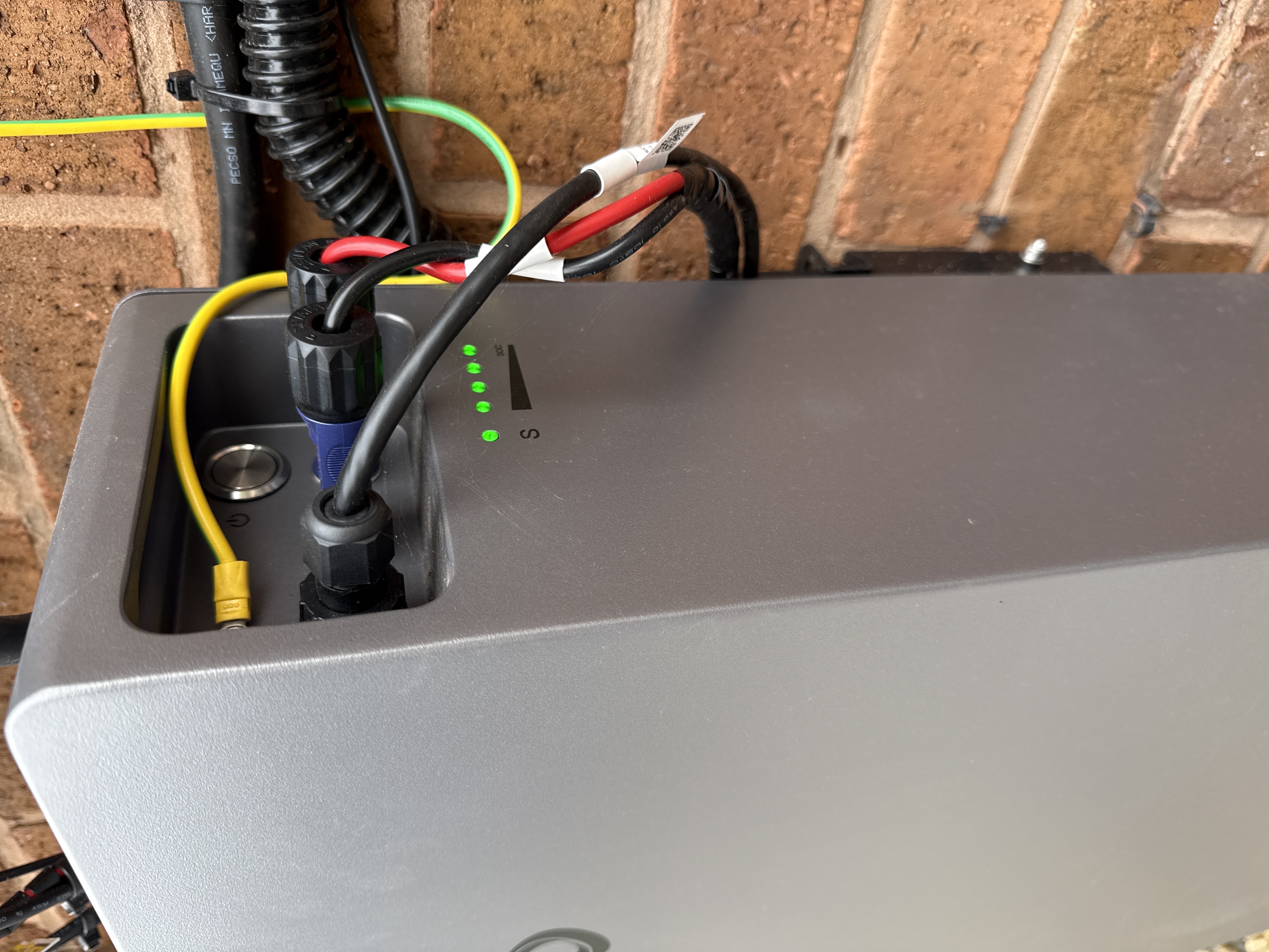

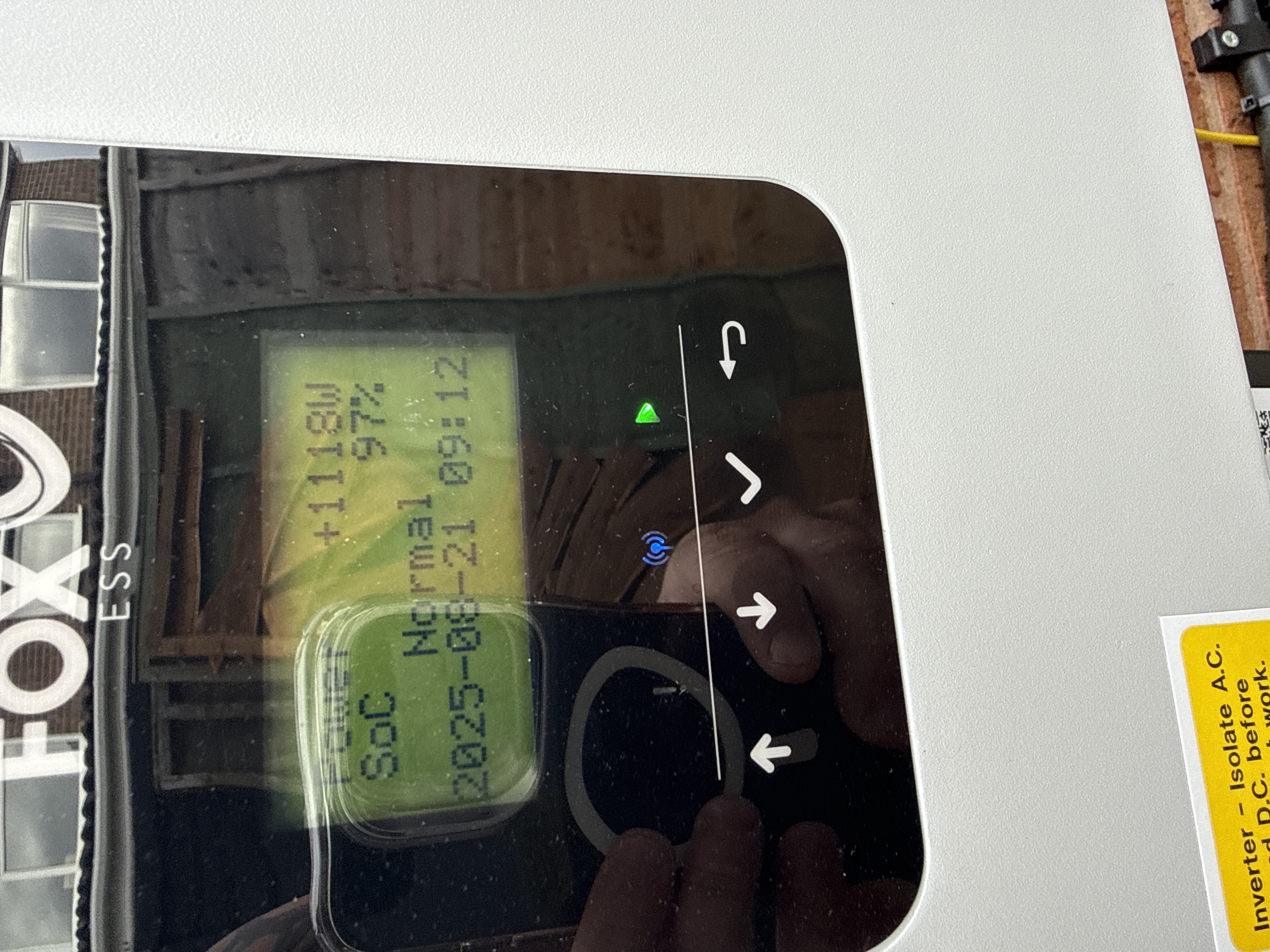

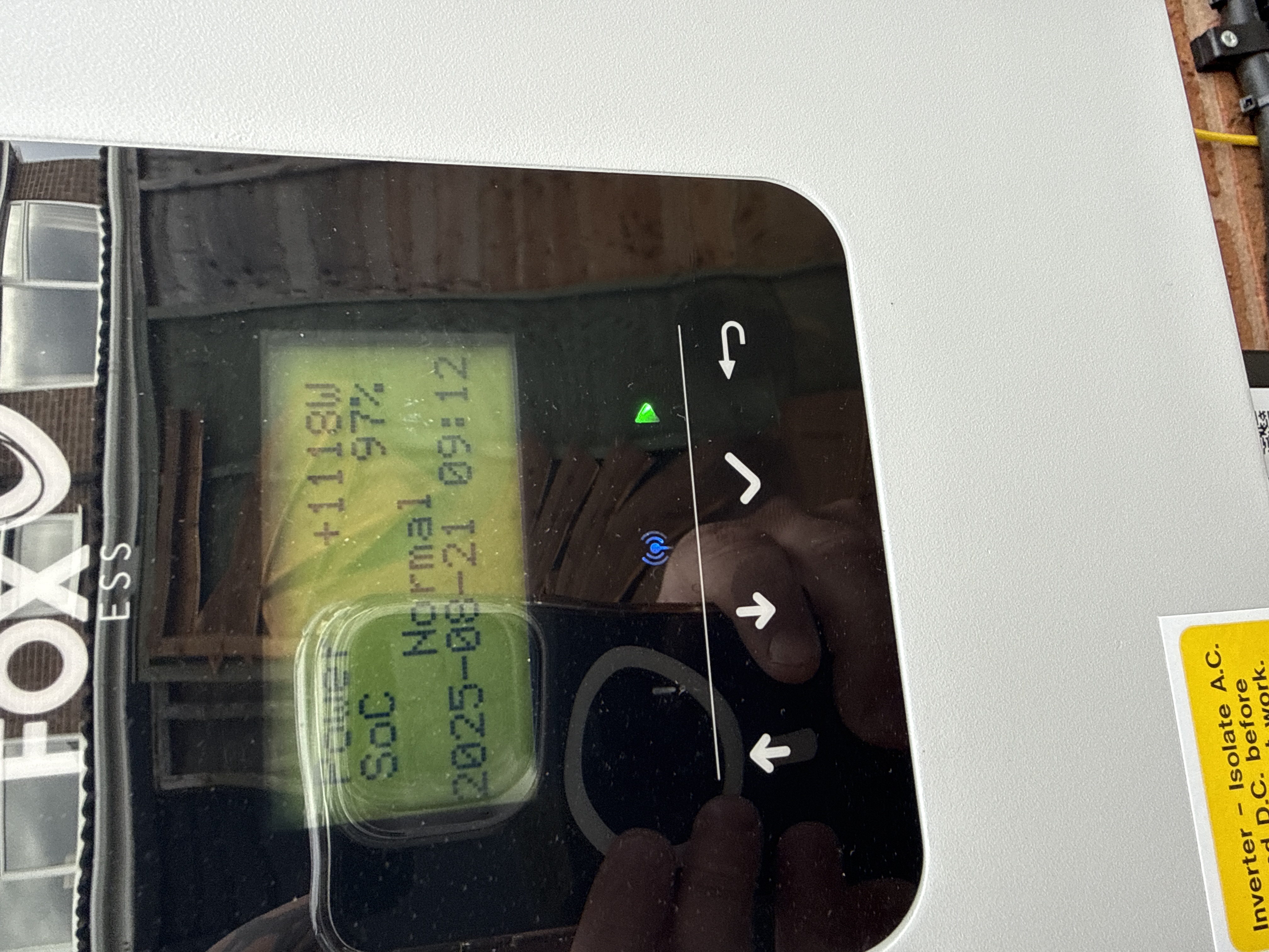

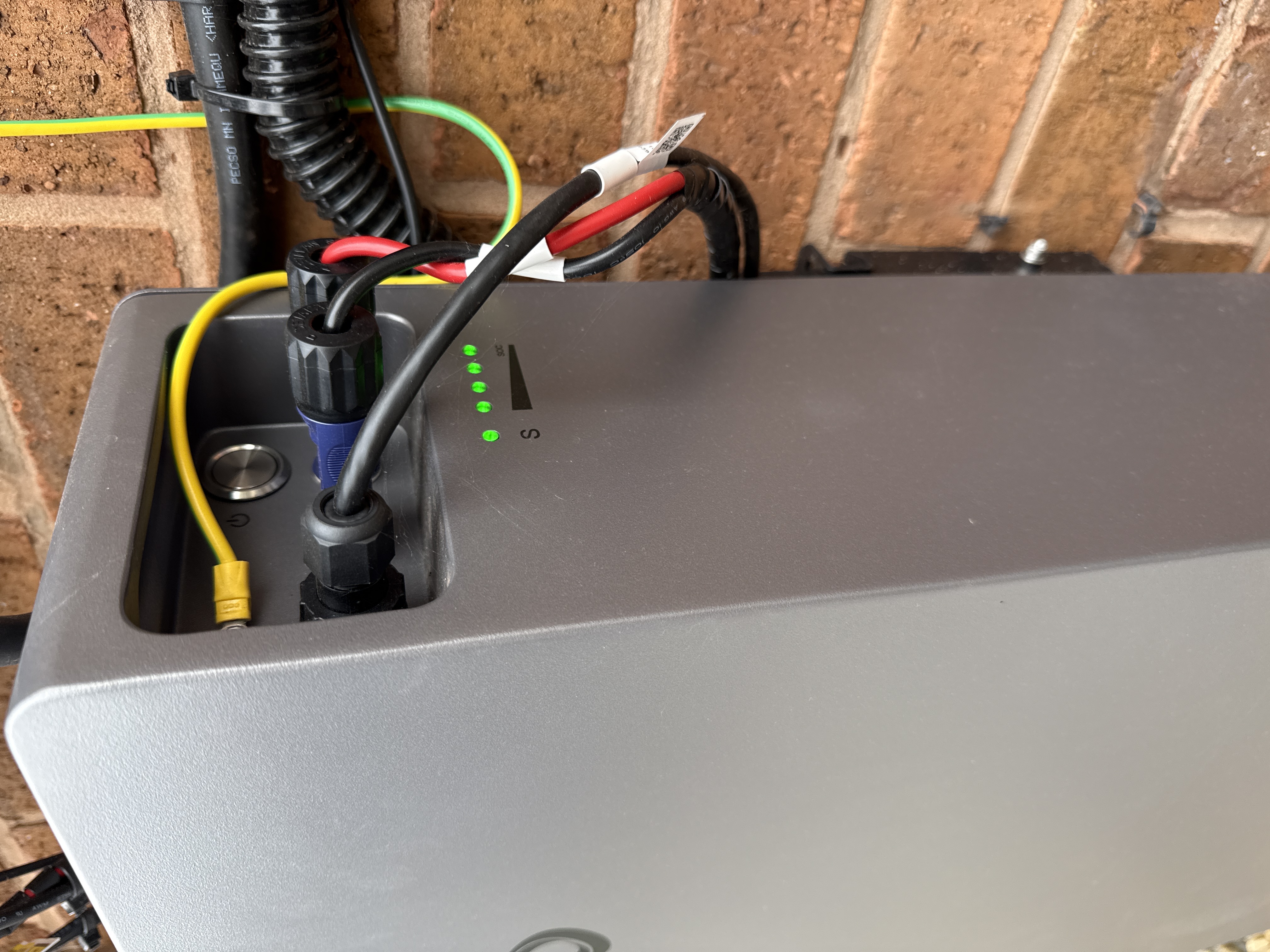

Good Morning,
Everything looks as it should be unless I am missing something. I will provide some images.
Thank you for your help Richard 👏
Re: Grid input at 0kw all day

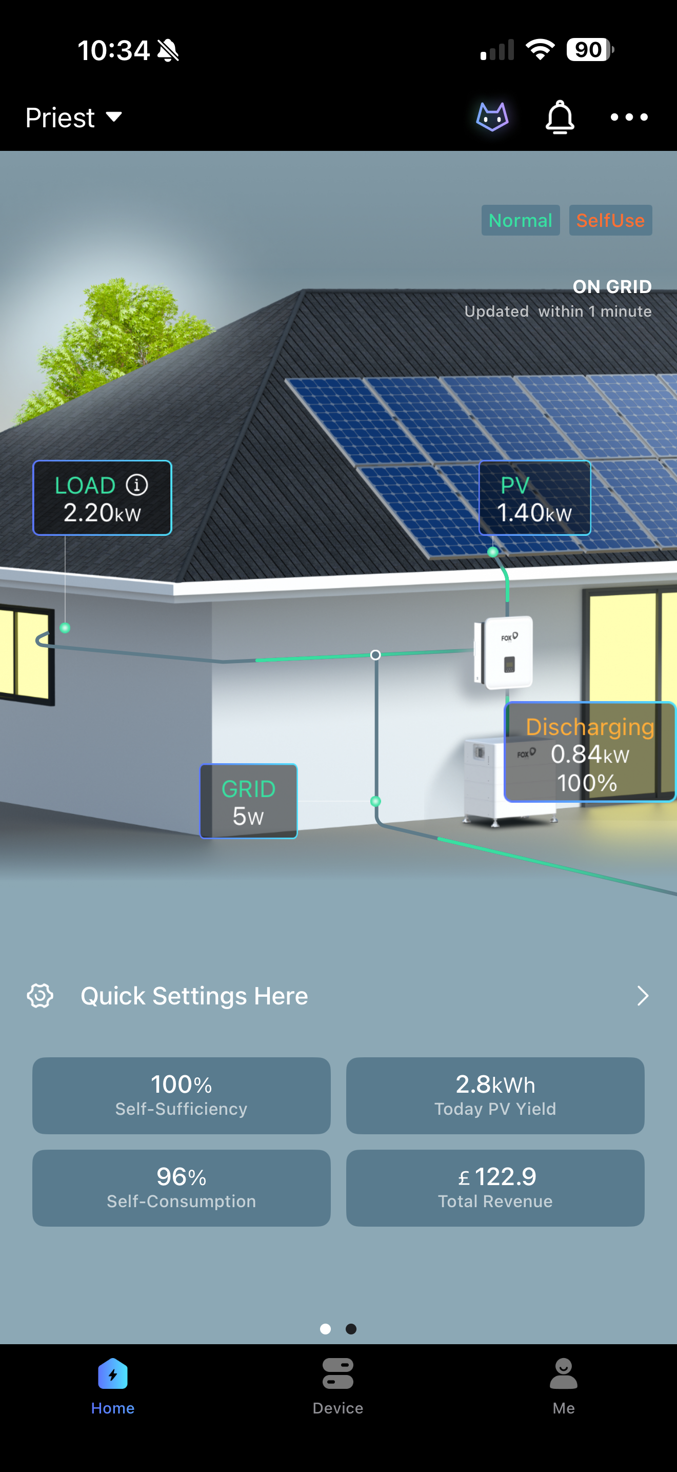

Yes that all looks ok, and the inverter panel is showing it is running in 'Normal' the output power is good as is the battery soc - and hopefully your app is now showing sensible information.

Hi Richard,
I have just looked at a video and it said to make sure “meter c/t” setting had “CT” active and it wasn’t it was on disable so I enable “C/t” and it looks to have fixed the issue ….although I am intrigued as to how this was disabled….it looks to be working now
That would have been my next thing to check :)
i’ve not seen it for a while but it ‘sometimes’ happens after a new install and/or when the firmware is updated for the first time. The CT clamp measures the load and the inverter cannot balance correctly without it so the battery won’t get used other than to keep it running overnight.
The good news is that it’s a one time event and should never happen again, so hopefully you’ll now have many years of trouble free running.
