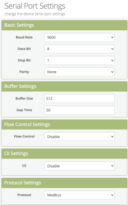

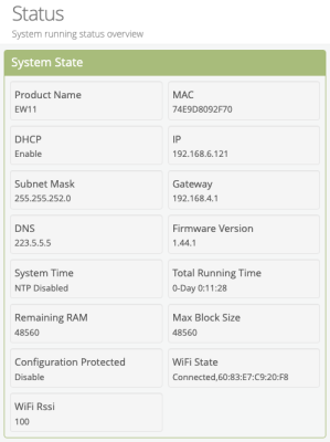

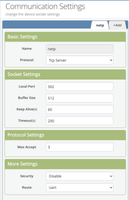

I took the plunge and set up the Elfin EW11. It's powered up and working and I can access http://192.168.6.121/socket.html. Inverter status is NORMAL and I can see it generates power.
1. As in the Elfin guide, I connected RS485A(marked A in yellow) to pin 4 of the inverter (H1-G2 inverter with 16 pins), and RS485B(marked blue) to pin 3 of the inverter. They are steady and not loose.
2. Completed Settings -> Communication -> RS485 -> Device ID and check the slave ID. It is set to 247
However, when I set up integration using 'Ethernet to Modbus...', using Elfin EW11 with adapter ip 192.168.6.121 I get 'Error connecting your adapter or inverter. Ensure adapter is properly configured and is correctly wired ..... '
Please see the config details and please help.
Thank you so much.

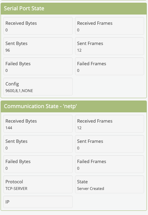

This is the error:
Details: Modbus Error: [Input/Output] Modbus Error: [Invalid Message] No response received, expected at least 8 bytes (0 received)
