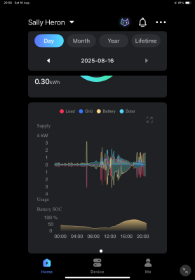

We have 6 panels and inverter and battery. The installation was done back in March and has mostly behaved as expected, but this evening when I checked the graph I could see a mystery power consumption. The battery has gone from 80%down to 60% and is still dropping. We tried switching off the breakers in the house one by one to see if we had an in house electrical problem but the inverter still showed the spike and drop, spike and drop, spike and drop. It sounded like the inverter was breathing when I went out to check in real time (since the app has the delay) This happened once before a few weeks ago but I hadn’t noticed it at the time.

It looks to be working correctly in that it is measuring a load and discharging the battery to meet that load, as you say the mystery is what the load is.
It would be appear to be a real load as you are seeing battery discharge, load and occasional export which is what you see when a large appliance switches on and off from time to time - the noise you hear is transformer whine as the inverter reacts to the load turning on and off.
From that your inverter appears to be working normally in response to an external load - can you see any stats from your other inverter to see what it was doing at the time ?.
The load appears to be transient a reasonable size (~2kW) like a water heater cycling, a large fridge/freezer or air conditioner.

Thanks for the reply. We don’t have AC or an electric water heater and when we switched off our fridges and freezer the cycling remained. Our other inverter is in the loft and I didn’t think to check it. Could it possibly have been a response to the heat by the other inverter? It was installed in 2011 so may be nearing end of life. When I’ve seen this behaviour in the past it has been in the evening starting around 8pm.

I think I have found the ‘cause’, but this has raised another question. I checked the 2kw battery in the loft in the evening and it had very little charge in it. In the morning it was fully charged and we had the discharge spike on the FoxESS app. So now I know the spike is caused by the 2kw loft battery being charged from the 9kw Fox battery. I can now stop wondering if something sinister is going on.
However, I have no idea what is triggering the 2kw battery to charge from the 9kw (or from the grid if the 9kw is at minimum charge). I had no idea it had this capability! I used to use an app (SolarMan) to view the system stats, but when our router died and was replaced I could not find a way in the app to connect to the new router so have lived without stats for a few years.
