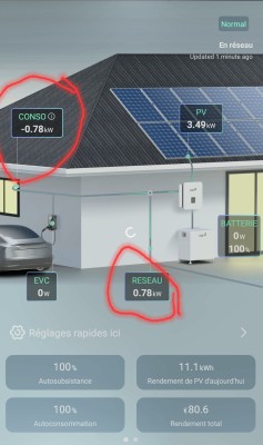

Les donnees foxcloud2
Foxcloud 2
Foxcloud 2
Alors qu avec une autre version fox cloud 1.5 les donnees son bonnes
MERCI

That looks as if there is a problem with your CT (or meter if fitted), you should never see a negative load as you are seeing.
Do you have a second solar inverter?, if you do there should be a second CT clamp fitted to that to it's output to make sure the load is calculated correctly.
I think a good start would be to shut down and restart the inverter to make sure that the 'manager/ARM' has not hung up.
Once it has restarted if you are still seeing unusual load numbers, I would investigate whether there has been any disturbance where you CT is fitted (this could be a meter for your installation, usually Chint DTDU666)

Thank you for your interest in my problem, but I've already restarted the entire system and it hasn't changed anything.
What I don't understand is why the data is good with Foxcloud 1.5, but it hasn't been good with Foxcloud 2 for three days. For me, it's not a problem sending information; it's more a report from Fox that isn't good.
