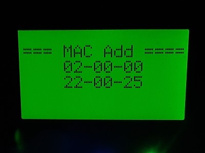

First, go to your inverter front panel, About, MAC Address and make a note of the MAC address for the ethernet port on your inverter.
Now, login to your router, find it's DHCP settings and add a static lease for your inverter using the MAC address. If you don't do this, there is a risk the router will assign the inverter's IP address to another device and wierd stuff will happen.

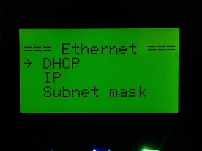

Go back to the inverter front panel and go into Settings, Communication, Ethernet. When I first did this, the only selection I could see was DHCP. If this is the case, go into DHCP. You see Enable. Press the DOWN button. Disable appears. Press Enter. The inverter restarts and goes through checking etc for 60 seconds.
Go back into Settings, Communication, Ethernet and you should see the menu that includes IP address, Subnet mask and Gateway.

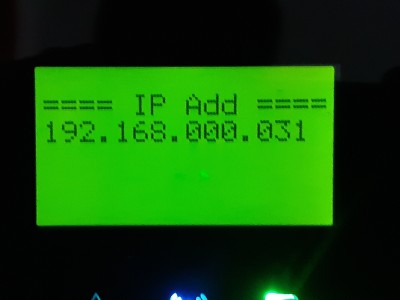

Check the IP address in About, IP address. You can also ping the inverter IP address and you should get a response time <1ms and 0% loss.

When I look in the menue "Ueber/About" the IP-address is show as 000.000.000.000. The MAC address I found.
In the menue "Einstellungen/Settings" -> "Ethernet" there is only "->DHCP". (no "IP" or "Subnet mask").
