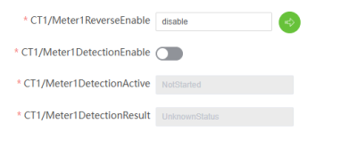

Tell your installer that if they had updated your system to the latest firmware and learnt the product, they could have software flipped the ct under the installer settings without the need to visit you again:lol:
