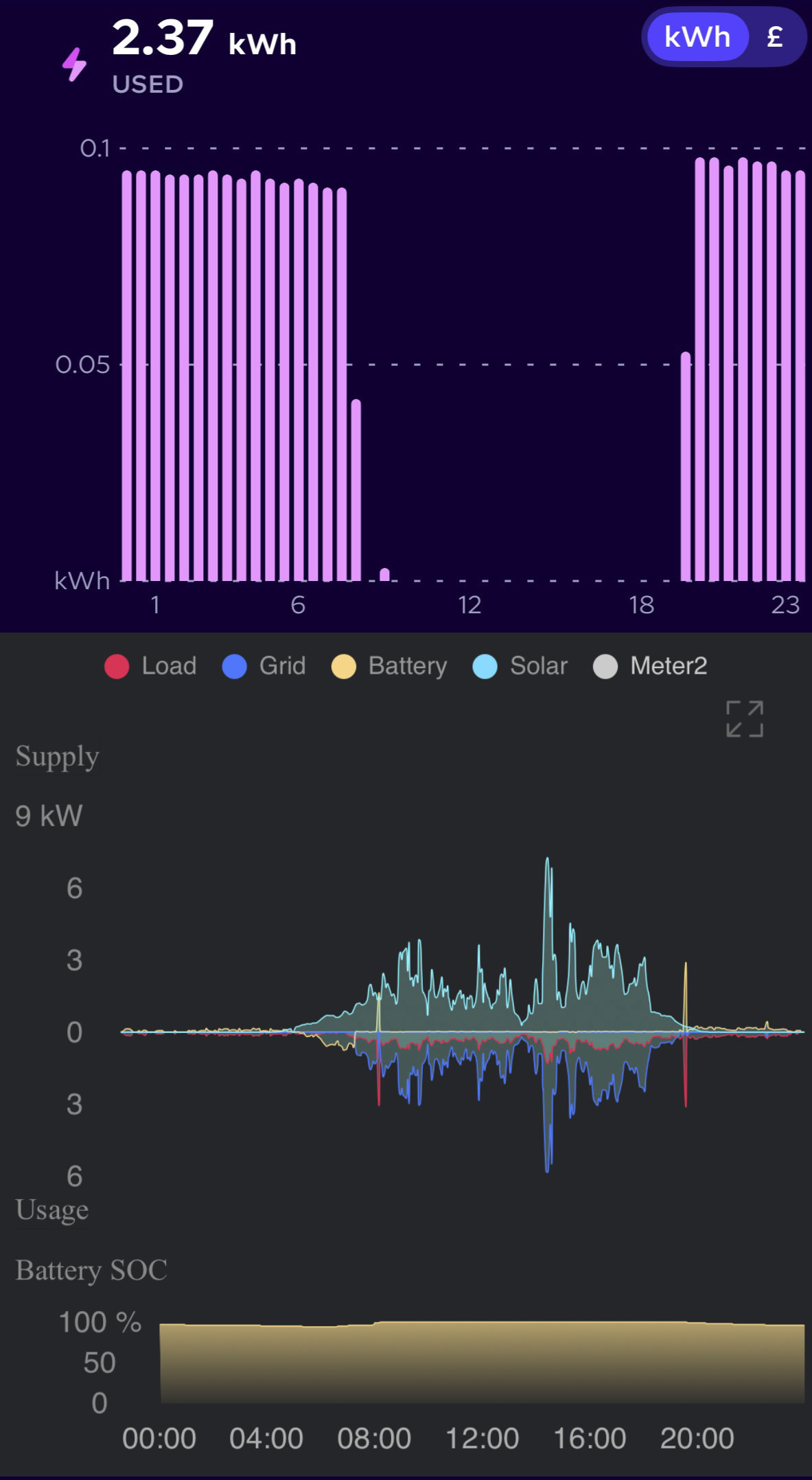

Can you upload some examples to help explain what you're seeing?
Thanks for replying - sure, please see the below for my generation & use yesterday:
Notice the battery is virtually full, but there is a near constant draw from the grid when PV generation is low.
I managed to fix my issue by using the MeterCompensation parameter. I set a value of -160W which now results in a draw from the grid of 10W according to the Octopus home mini, while the battery supplies the remaining load.

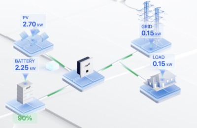

I'm relying on FoxCloud for data and that is reporting an export of 150W to the grid. I'm not according to the Octopus home mini, and I would expect that this is actually going to Load.
Also, there's always a missing 150W according the FoxCloud data
Not sure if anyone can explain what's going on that requires this adjustment, or what's happening to that extra 150W - would be interesting to know.
Code: Select all
2.70 (PV) - 2.25 (Bat) - 0.15 (Grid) - 0.15 (load) = 0.15
