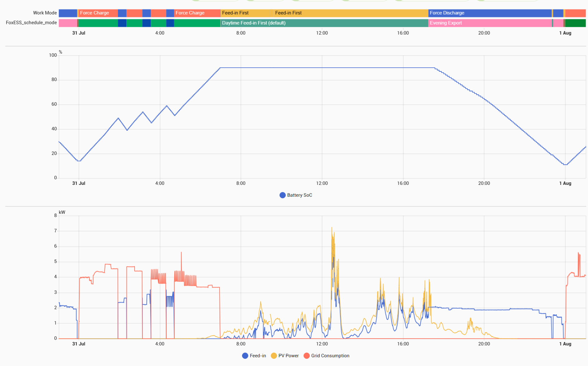

Personally I do 100% once a week, 10% once a month via an automation. It'll do it more often in certain circumstances (for example, if forecast PV for the day is very low, it'll use the full range instead for a bit of extra arbitrage to make up for the lost generation).
It's not worth doing the calibration cycles manually, you might as well just stick to the full range rather than trying to keep track. Also, underutilising the battery is just as much of a waste, due to calendar degradation (for example, sticking to 20-80 all the time, 0.6 full cycles daily, would mean you'd run out of warranty years, and the battery capacity would have decreased anyway due to the passing of time). It's a bit of a balancing act.
Calendar degradation is (relative to cycling) more important on LFP, whereas with NMC batteries the cycling is a much bigger factor.

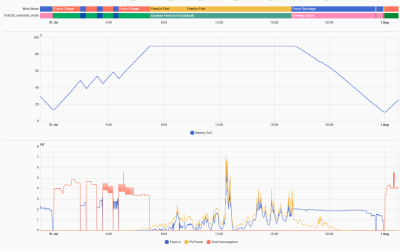

It changes on a day to day basis, anywhere from 14-92 to 20-84 (my automations will tweak it based on the PV forecast / weather forecast / etc), but I will also be cycling in the middle of that range as well (again, dependant on things like cell temperature / PV / weather / etc). I also adjust charge and discharge rates based on those criteria. On very hot days etc it will be using the slowest possible charge and discharge rate and no mid-range cycling (a high cell temperature causes increased cell degradation). When it is cold, it will be more aggressive, to generate warmth.
So I'm using more like 0.8-1.0 full cycles daily even if I don't hit the extremes. That's only possible on particular tariffs.

                      - condition: state
                        entity_id: select.work_mode
                        state: Force Charge
                        for:
                          hours: 0
                          minutes: 20
                          seconds: 0
                      - condition: numeric_state
                        entity_id: sensor.battery_soc
                        above: 99
              - condition: and
                conditions:
                  - condition: state
                    state: Force Charge
                  - condition: template
                    value_template: >-
                      {% if states('input_boolean.foxess_calibrate_top_reached')
                      | bool %}
                        {% set top_soc = states('input_number.foxess_overnight_charge_top_soc') | float %}
                      {% else %}
                        {% set top_soc = states('input_number.foxess_calibrate_top_soc') | float %}
                      {% endif %}                       {{
                      (states('sensor.battery_soc') | float) >= top_soc }}
                  - condition: time
                    before: "06:30:00"
      - condition: and
        conditions:
          - condition: time
            after: "06:57:59"
            before: "07:00:00"
  - condition: or
    conditions:
      - condition: and
        conditions:
          - condition: time
            after: "06:00:00"
            value_template: >-
              {{ ((states('sensor.foxess_charge_speed_for_7am') | float) <
              (states('number.force_charge_power') | float * 0.75)) and
              (states('sensor.foxess_overnight_discharge_rate_kw')|float >
              (states('sensor.load_power')|float * 2.0)) }}
      - condition: and
        conditions:
          - condition: time
            after: "06:30:00"
            value_template: >-
              (states('number.force_charge_power') | float * 0.65))  and
      - condition: and
        conditions:
          - condition: time
            after: "05:30:00"
            value_template: >-
              (states('number.force_charge_power') | float * 0.80))  and
      - condition: and
        conditions:
          - condition: time
            before: "05:30:00"
            value_template: >-
              (states('number.force_charge_power') | float * 0.85)) and
      - condition: time
        after: "06:59:00"
actions:
  - action: select.select_option
    metadata: {}
    data:
      option: Force Discharge
    target:
  - choose:
      - conditions:
          - condition: or
            conditions:
              - condition: time
                after: "06:58:00"
                value_template: >-
                  {% set target_soc =
                  {% if states('input_boolean.foxess_calibrate_top_reached') |
                  bool %}
                    {% set target_soc = states('input_number.foxess_overnight_charge_top_soc') | float %}
                  {% endif %}
                  {{states('sensor.battery_soc') | float >= target_soc}}
        sequence:
          - action: number.set_value
            metadata: {}
            data:
              value: "{{(states('sensor.pv_power')| float) + 0.4}}"
            target:
              entity_id: number.force_discharge_power
          - if:
                value_template: >-
                  {% set target_soc =
                  bool %}
                  {% endif %}
            then:
              - action: input_text.set_value
                metadata: {}
                data:
                  value: Target SoC reached - minimal export
                target:
                  entity_id: input_text.foxess_schedule_mode
            else:
                metadata: {}
                data:
                  value: Transition to day - minimal export
                target:
  - choose:
      - conditions:
          - condition: time
            before: "06:58:00"
        sequence:
            metadata: {}
            data:
              value: >-
                {{(states('sensor.foxess_overnight_discharge_rate_kw') | float |
                round(2)) }}
            target:
            metadata: {}
            data:
              value: Overnight arbitrage export
            target:
mode: single
/code]
Re: EP11 (LiFePo4) best SoC range for longevity?
Thanks a lot. Even with adjusting, it gets me off to a great start.
