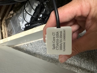

This is the CT clamp i have. Red wire in pin1 and black pin2
CT Clamp.jpg (40.69 KiB) Viewed 7422 times

Yes it’s the right clamp.
You shouldn't be seeing negative load, thats usually a sign the CT clamp is facing the wrong way (or is in the wrong place), but to check you don’t have any other generation on site as this won’t work with multiple generators.
