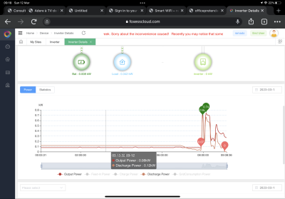

Here you can see the constant battery discharge during the night at the rate of 122W per hour.

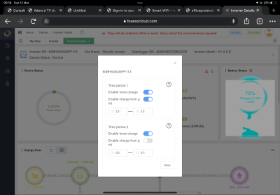

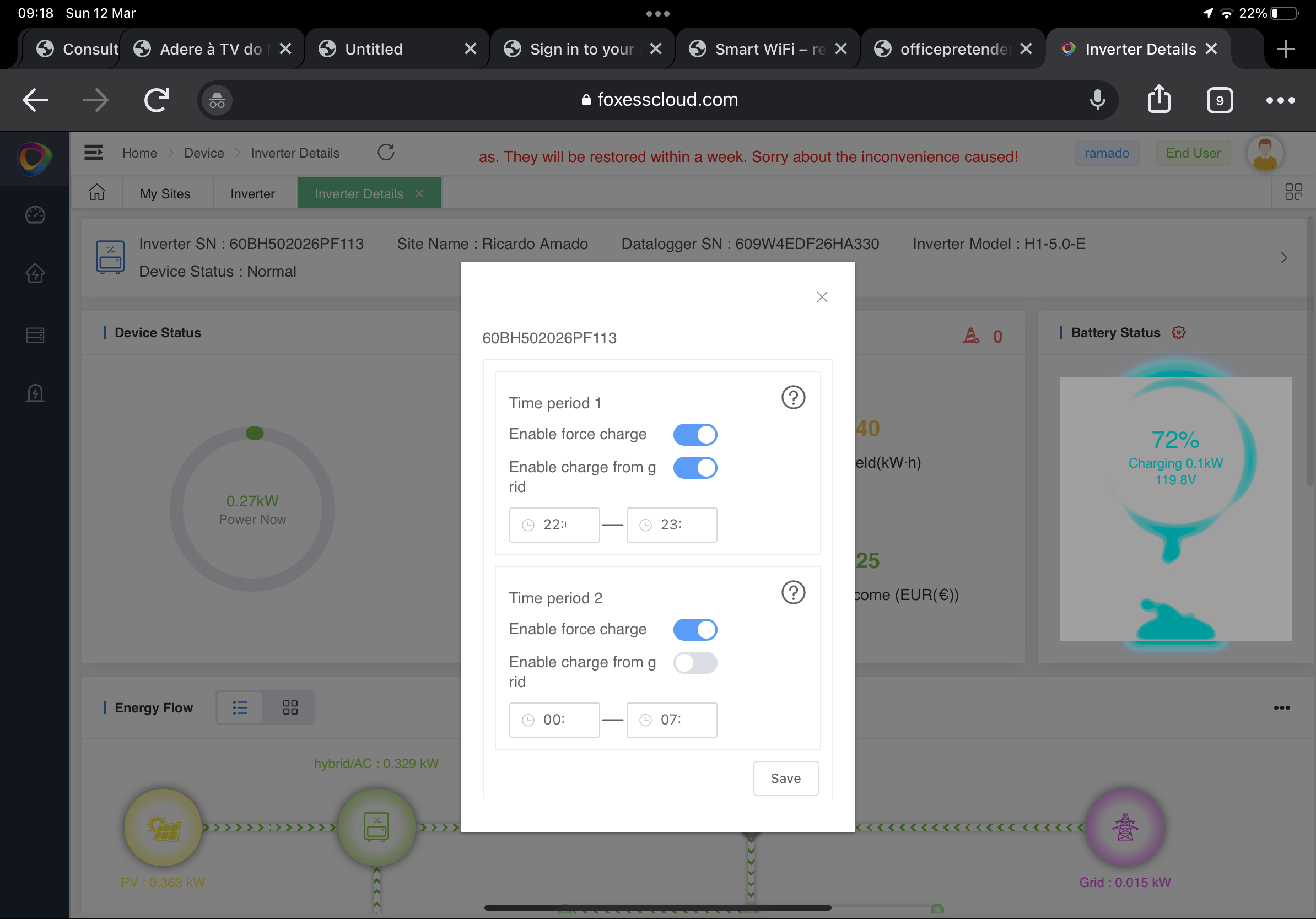

Here you can find the battery force charge configurations:

During the night the battery will be used to keep the inverter running, it doesn't use grid power to do this - it always comes from the the battery (or solar during the day).
The force charge option you have set will stop the batteries being used to run the house load, but it will continue to be used to keep the inverter running during night time hours.
That said 122w seems high, but it's difficult to tell because the app only updates every 5 minutes - I would normally expect to see around 70-100Wh for a 5kw H1 inverter.
The latest firmware version appears to be far more energy efficient than previous versions - check your firmware versions if they are not Master 1.54, Manager 1.57 then ask your installer to update you to Master 1.54, Manager 1.57 - that should hopefully improve things.
