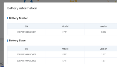

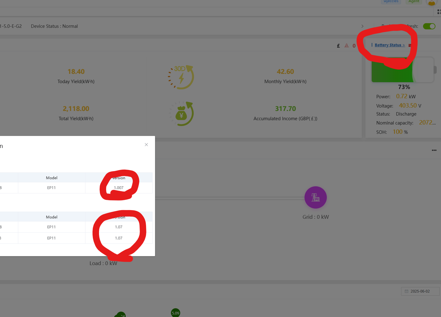

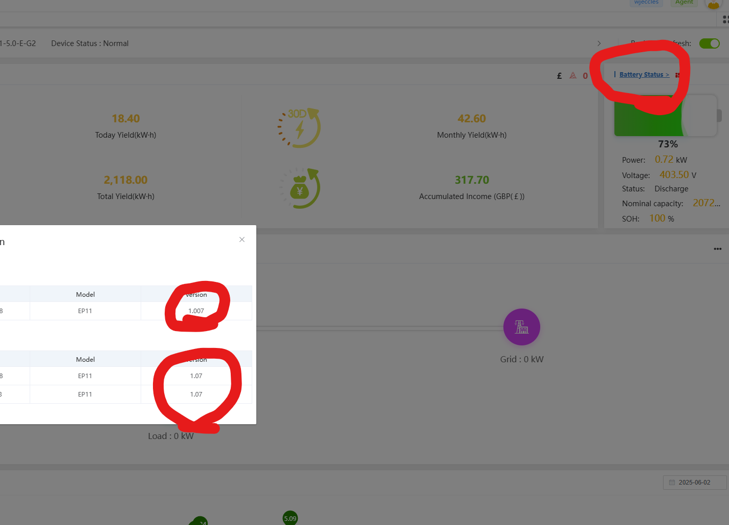

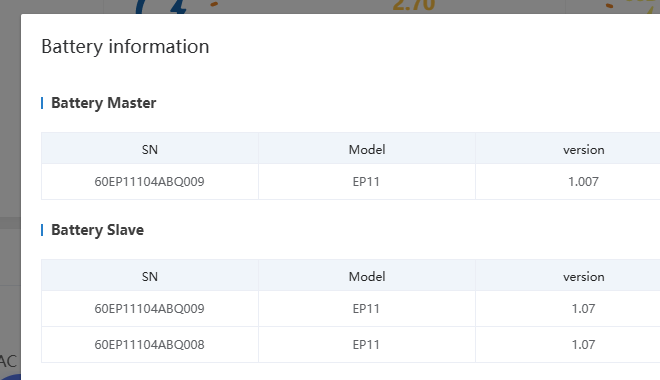

If you look at the cloud desktop app https://www.foxesscloud.com/ click under devices, inverter, then click on the view icon for your inverter. Then click on Battery Status, and you'll see the firmware version reported. Note that the EP is both a master and slave so two rows for one battery is normal. Here is a screenshot of a dual EP11 setup.
If it does not show correctly, then the firmware update didn't succeed.

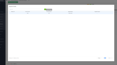

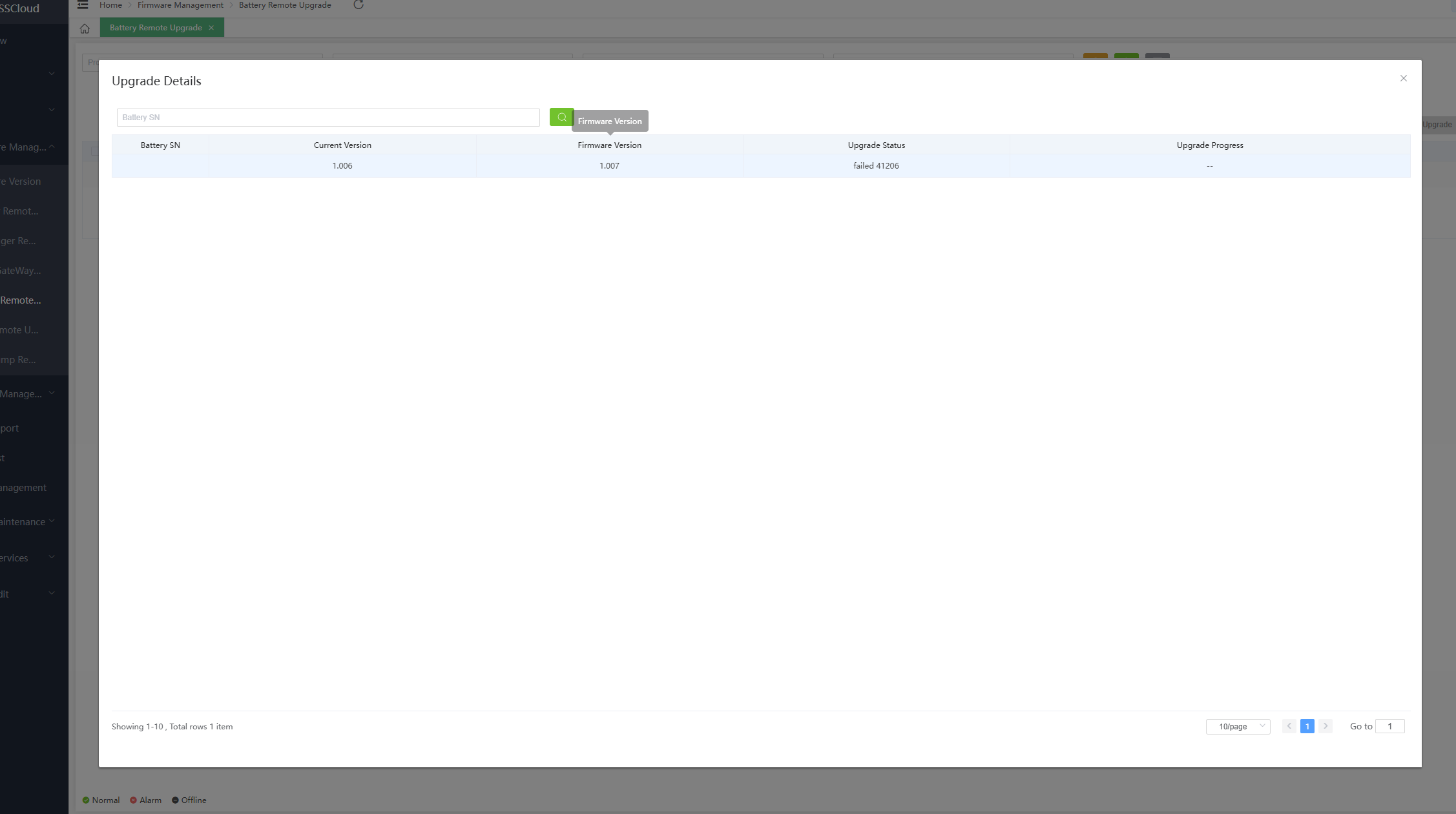

No worries, they should have known, as on the agent firmware manager, it says if something is successful or not.
For example, I had one fail first time around and it looks like this, so it's not like it's hard to understand the results
I do wonder if the installer asked them to do it, as that's twice now it hasn't worked.
