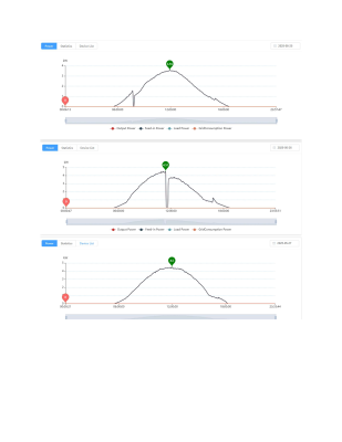

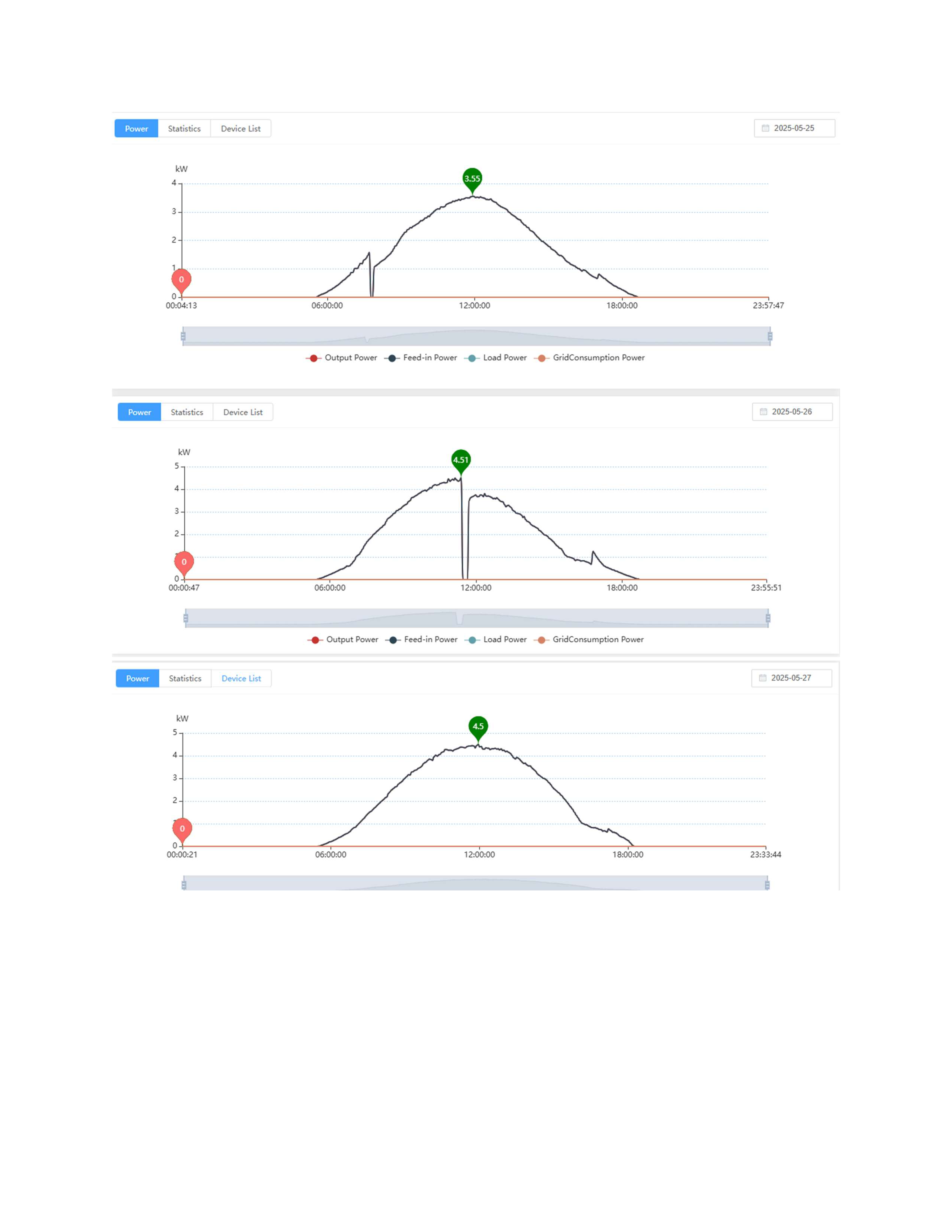

I am using a FOX ESS T15-G3 on-grid inverter with 10 × 585W BF Jinko panels. I’ve observed that even brief grid outages (5–15 minutes) cause a disproportionately large drop in total daily production, even though weather and irradiance remain consistent.
For example:
  • On May 25, the grid was out from 07:46 to 07:51 AM. Total production: 23.6 kWh.
  • On May 26, outage from 11:23 to 11:42 AM. Total: 27 kWh.
  • On May 27 (no outage), production: 31 kWh.
Based on app monitoring and performance tracking, I’ve noticed:
  • The inverter takes several minutes after grid restoration to stabilize and resume full output.
  • It seems to re-scan MPPT tracking from scratch, instead of continuing from previous optimal values.
  • This behavior causes underperformance far beyond the actual outage duration.
I’d like to know:
  • Is this behavior expected with the current firmware?
  • Are there any firmware updates available to optimize post-grid-outage recovery?
  • Can you recommend settings or configurations to improve MPPT retention or re-connection time?
I am quite worried about this behavior of inverter as grid outage for short period of is common in my area. and this impacts significantly power production.
Thank you in advance. I am attaching screenshot of graph for better understanding.

Right, So grid outage would result significant/huge reduction on total production/day ?
If grid outage is around 8AM then that day peak is 3.5KW
and without grid outage peak value is 4.5KW.
is it normal for fox inverter ?
because my another system (Inverex Brand) doesn't give such bad performance for same condition.
EDIT: I expect inverter to take time to resume but why it doesn't get to usual peak production around?
Moreover, please guide me about official support/company's warrant claim dept ?
