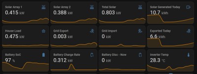

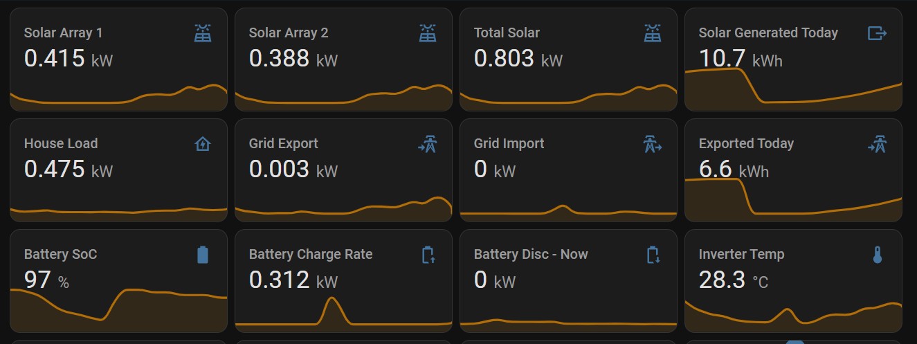

Noticed earlier, that my battery started to charge ... as hit 97% rather than exporting. I have set my battery to charge in my Octopus IOG cheap rate (11.30 to 5.30) .. so really not sure I need to waste my solar charging the battery, when can be exporting

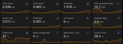

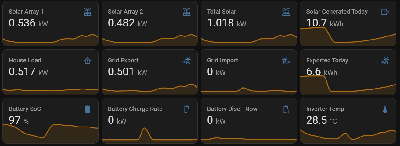

So, I changed the Work Mode from Self-Use .. to feed-in. Just wanted to check if I leave it in Feed-in mode .. there are any real negatives to that?
Self-Use
Feed-in
Nope, I have mine in feedin mode during the summer when I don’t need the solar to top up the battery. As long as you can make it through the evening with your remaining battery you’ll be fine in feedin mode.
Thanks Will, left it in feed-in mode all day yesterday ... finished at about 73% battery (10.36kw EP11) at bed time ... and only put the battery on charge from 3.30am to 5.30am .... and was 100% charged in the morning .. and exporting straight away
