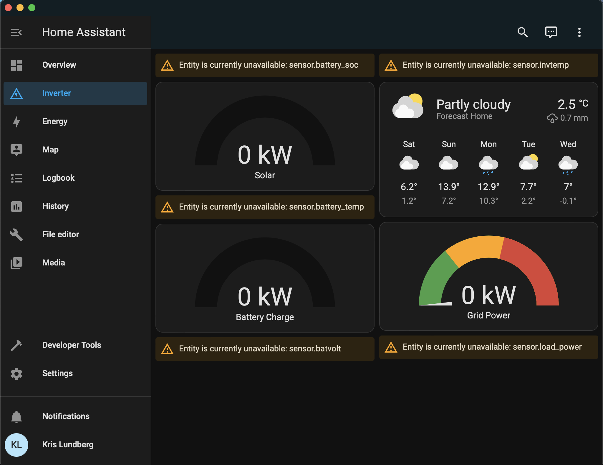

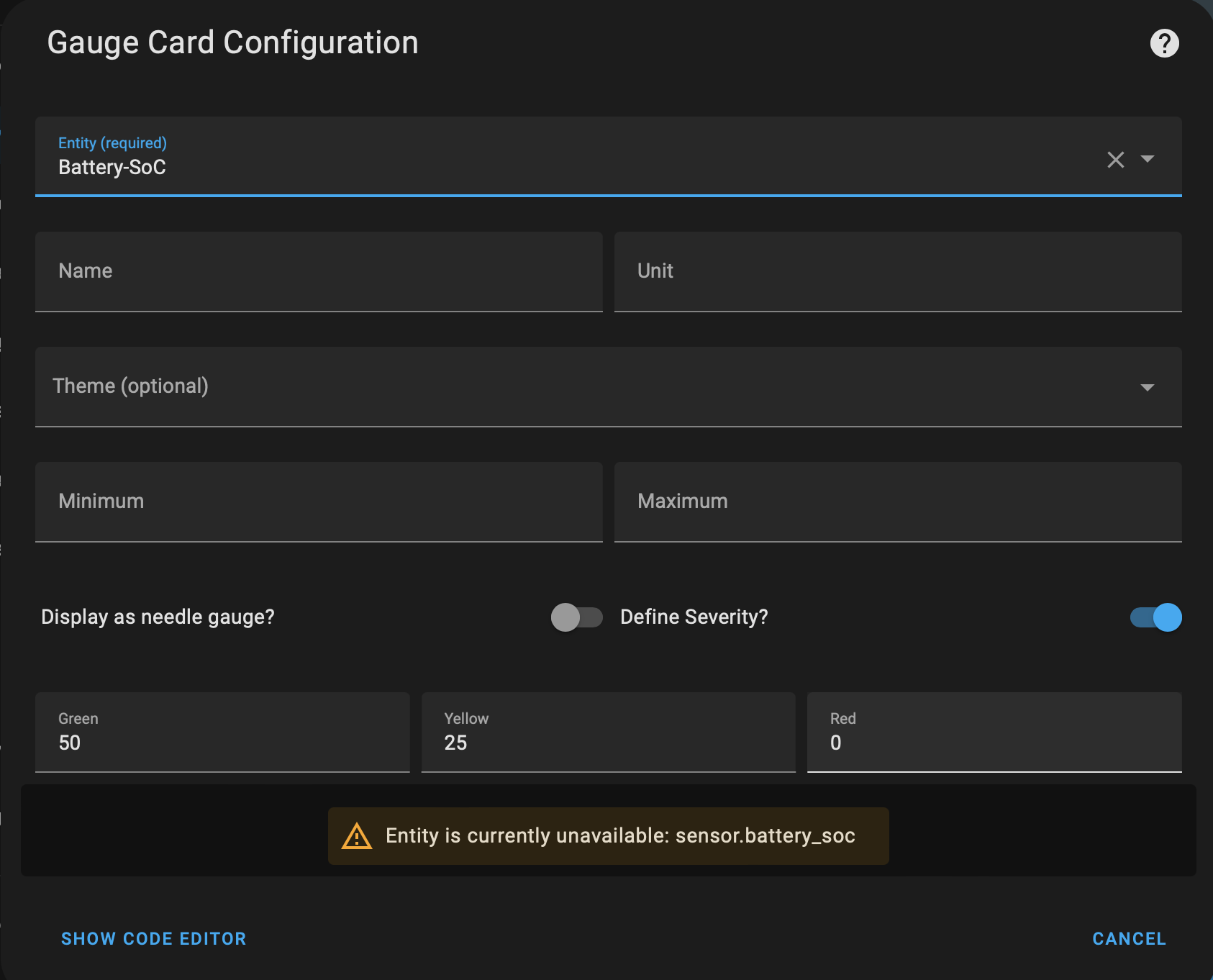

Hi all, I hope someone can help, the APP went down this morning as I'm sure you are all aware, and Home Assistant lost it's sensor data, but when the app came back online, I still have no sensor data, Ive rebooted HA, and tried editing the cards in dashboard, but the sensors just show a (?) next to them.
I'm stumped
HAn running on Raspberry PI via LAN connection.
Re: HA NOT SEEING SENSORS
Sorted it, bloody invertor IP had changed by 1. DHCP is now off and that address is reserved.
