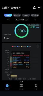

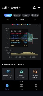

Hi I have 10 panels and 1 battery, During daytime and night time I have 0.01/ 0.02 coming from the grid even though i am producing from the panels and battery has more than 50% charge ? I know this isn't a great deal but it will mount up ££££ over a year, it would be nice to see I'm 100% self sufficient rather than just 97 % or 99% sufficient, does anyone else have this
I have attached a couple of pics
Cheers Colin
It’s quite normal in Self Use workmode to see a very small grid demand, when it is sunny the export should zero the grid import but overnight there will always be a small drain (it’s a grid tied inverter and has to maintain a bias point).
