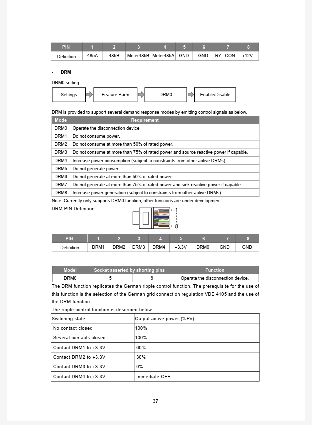

On the preventing negative solar export dynamically, this is a perfect use case for the DRM control, page 37 of the user manual.
With a simple home assistant-controlled smart relay like a shelly, you can short out the required pins on a old network cable to control the inverter. DRM5 mode looks like the right one for you telling the inverter to not generate power.
This combined with some battery and inverter automation via home assistant you should have exactly what you need.

It's great to know that it's possible to manage this by sending signals to the DRM connector.
