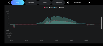

1) Why does there appear to be a relationship between PV generation and load, when one goes up the other follows, etc? I didn't expect to see this. I have attached a few screen shots. Is it something to do with inverter arrangement?

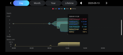

2) Why do I appear to be exporting more than I am generating (no additional generating sources)? The daily stats show me generating producing more than exporting (for example PV production = 20.20kwh, 7.10 to Load&Battery and 13.10 to grid). But the graphical display shows export > generation for example 4.33 kW export against 3.1 kW generation (see attachment).

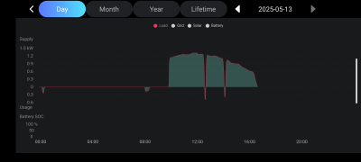

3) For Load - the graphical data shows it being consistently quite high (say 1.2 KW) but then dropping when I put on a high load appliance. You can see this in attachment where the little blips are when the induction hob went on.

What you can see from the traces as you say the load increases with PV, but the load should be in the opposite phase i.e. under the line that is because the battery inverter (hybrid) is seeing the export from the other inverter as negative load.
In a setup like this you should have a second CT clamp wired (CT2) from the hybrid inverter and clamped around the live output of the solar only inverter - it then knows how much is being exported and it can calculate the correct load and also be able to effectively use that export.

The app will be doing some reconciliation as it has both inverters in the account but the real time graphs are coming from the data produced by the hybrid and because it can’t measure the amount of power from the solar inverter it is getting all of it’s maths wrong.
