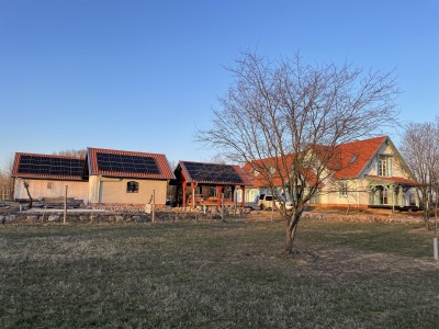

Hello from Masuria Lake District,
New installation - completed on March 20th:

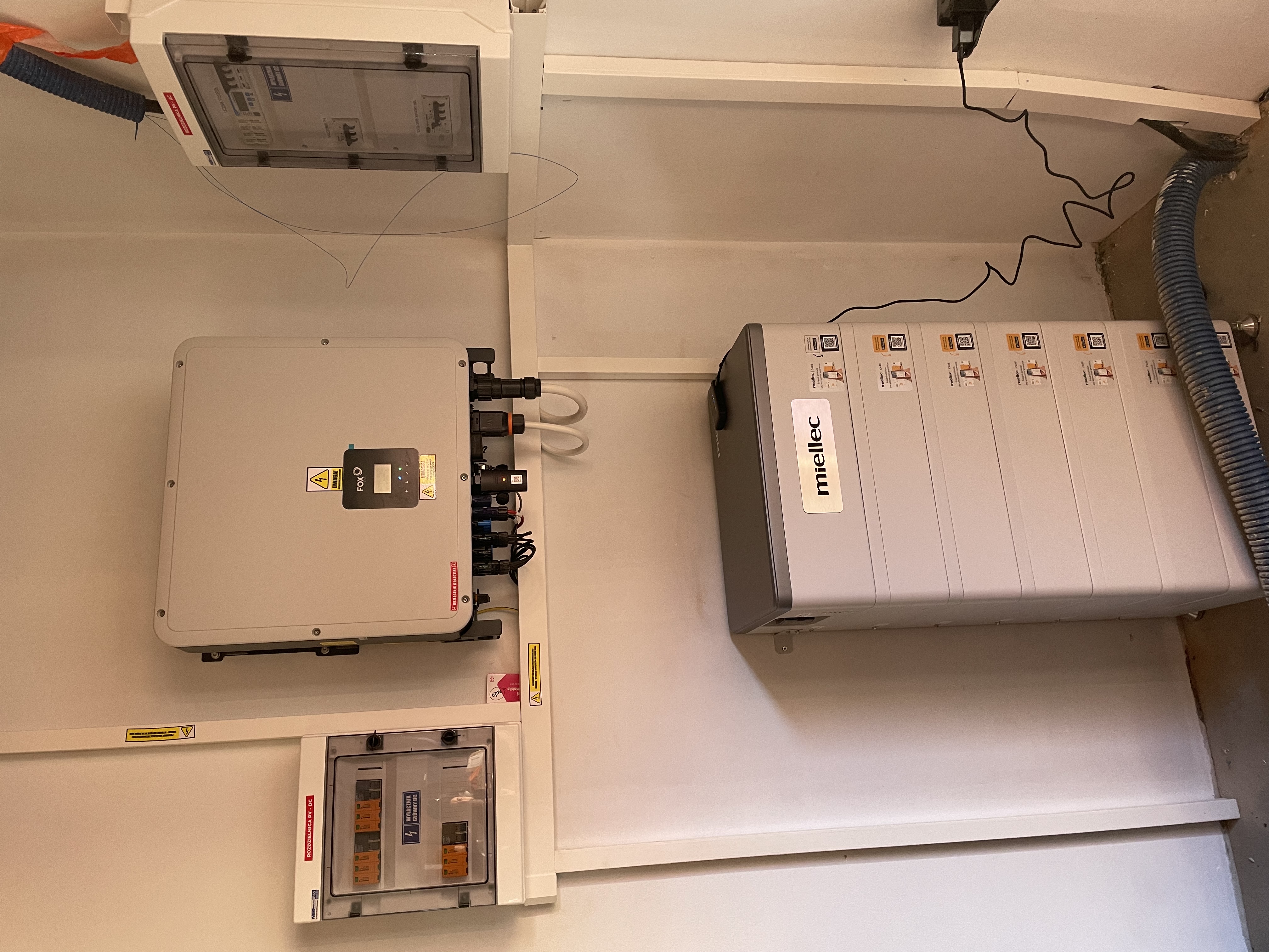

- 44 x Tiger Neo JKM450N-54HL4R-V panels (PV 19.8 kWp)
- Miellec Tower 2800-7 battery (LiFePO4 cells)
- FoxESS H3-PRO-15.0 inverter
- Feeding a Bosch Compress 7000i AW 5–17 kW heat pump

Next season, I’m planning to add a carport/shed next to the workshop building (the one in the center) and extend the kitchen to the west side of the barn. This would provide additional roof area for future PV expansion.
