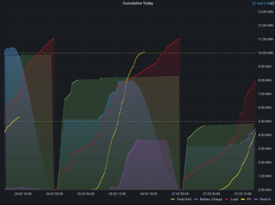

This is my "at a glance what is happening right now / so far today" view

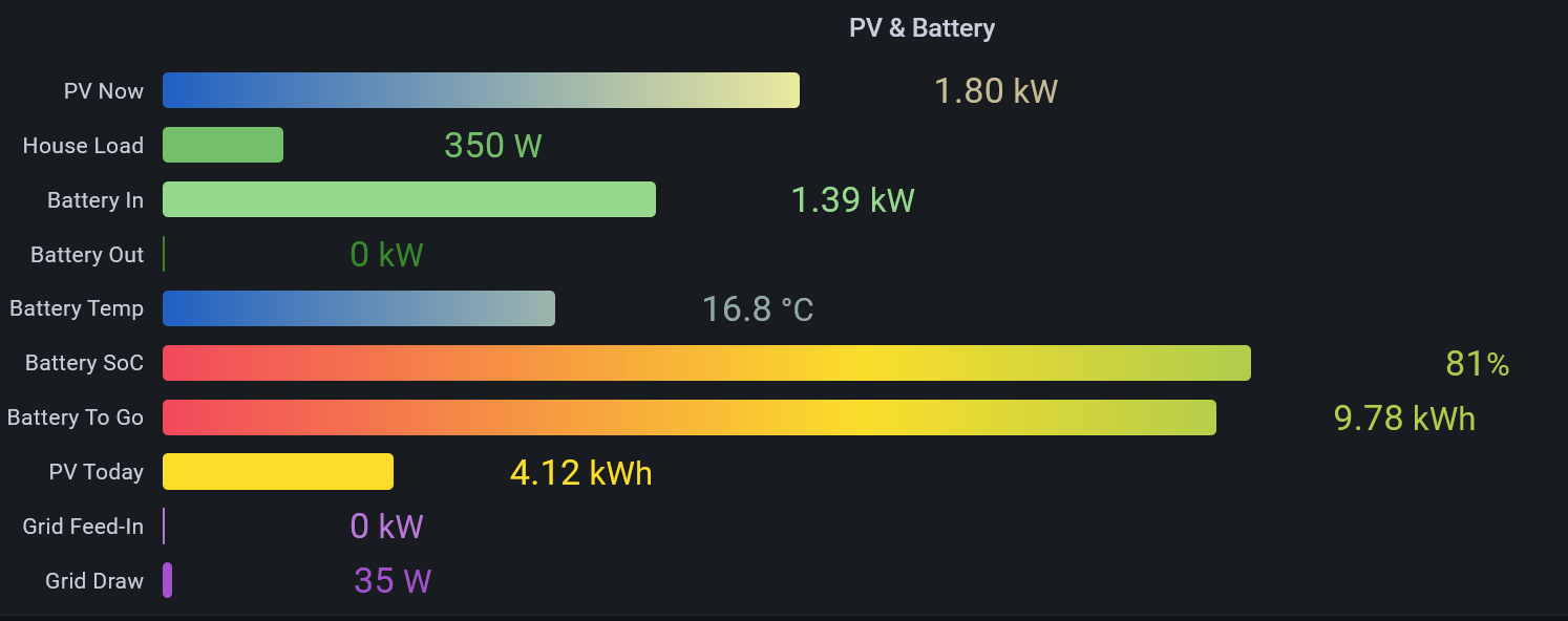

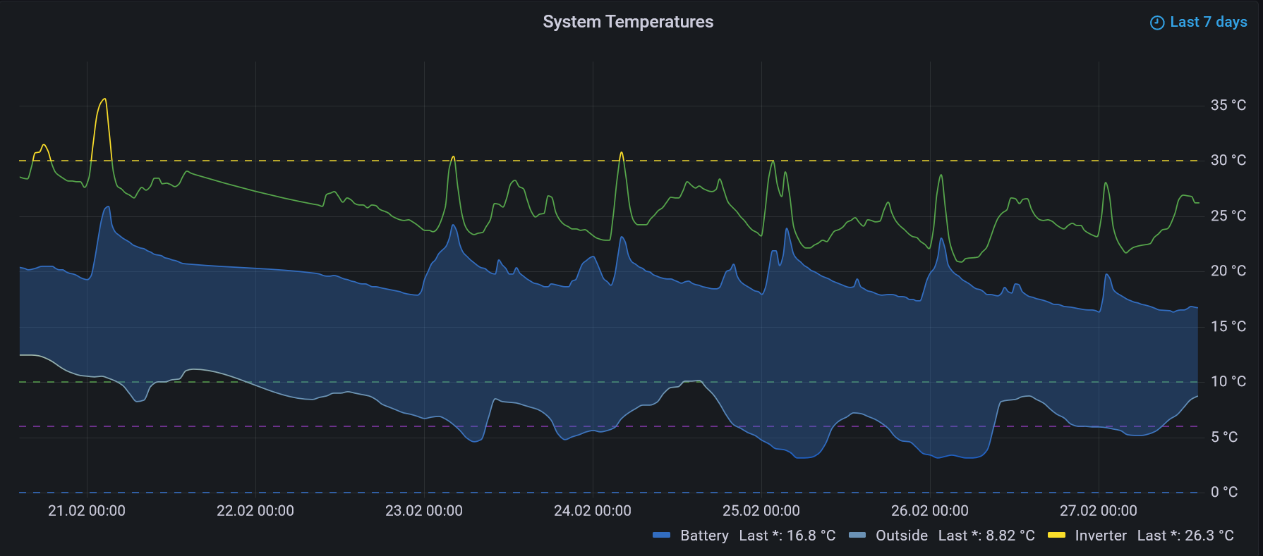

Battery and inverter temps vs outside. Had issues with batteries getting cold in December, built a wooden box lined with EPS to stop that happening, but of course I need to understand how warm they are so I can dismantle the box (it was designed to be taken apart and put back together easily) and stop them getting too hot!

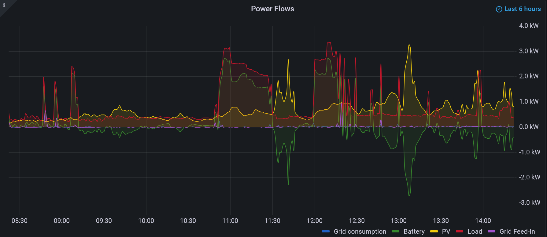

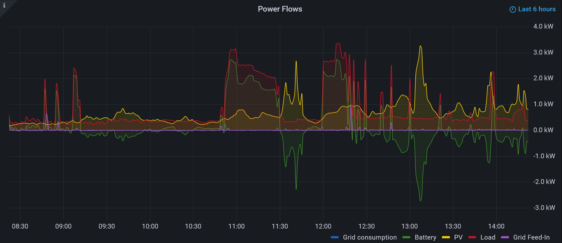

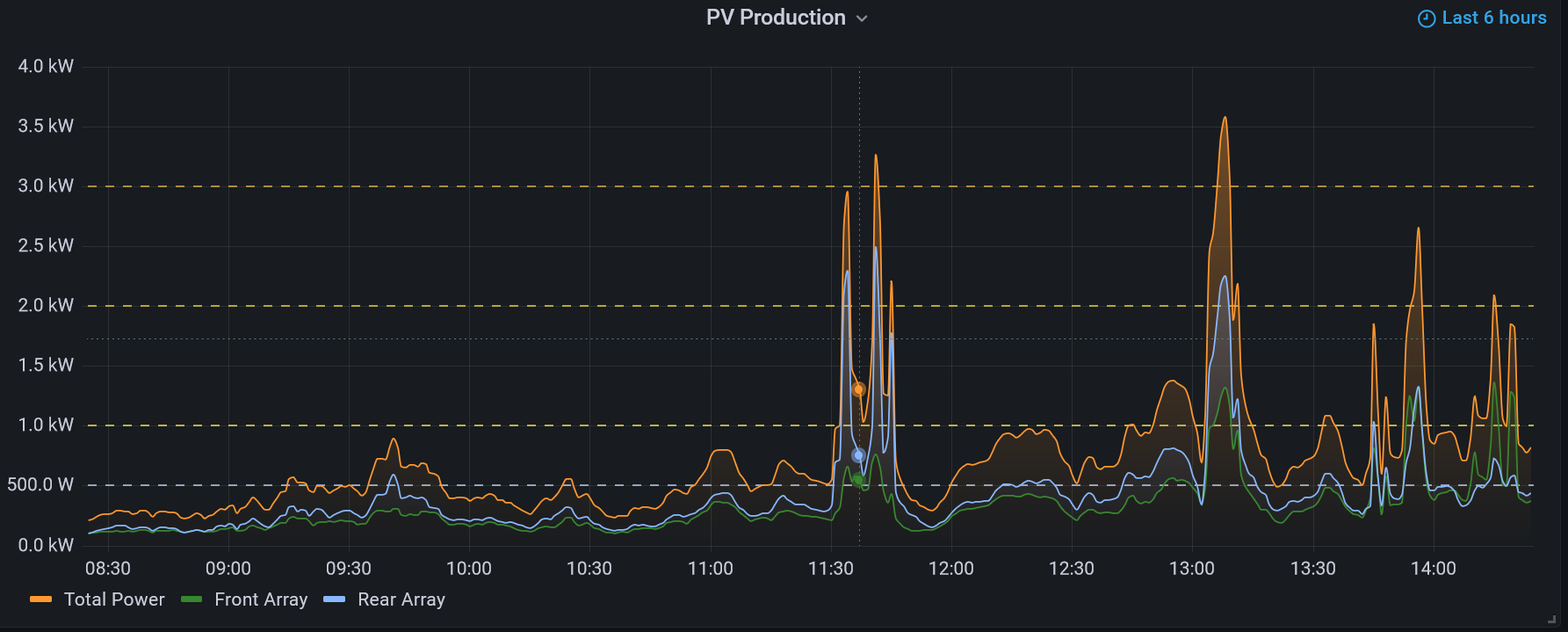

This is just your ordinary how much juice am I getting, because of the way the panels are arranged on our roof it's very handy to see the separate strings

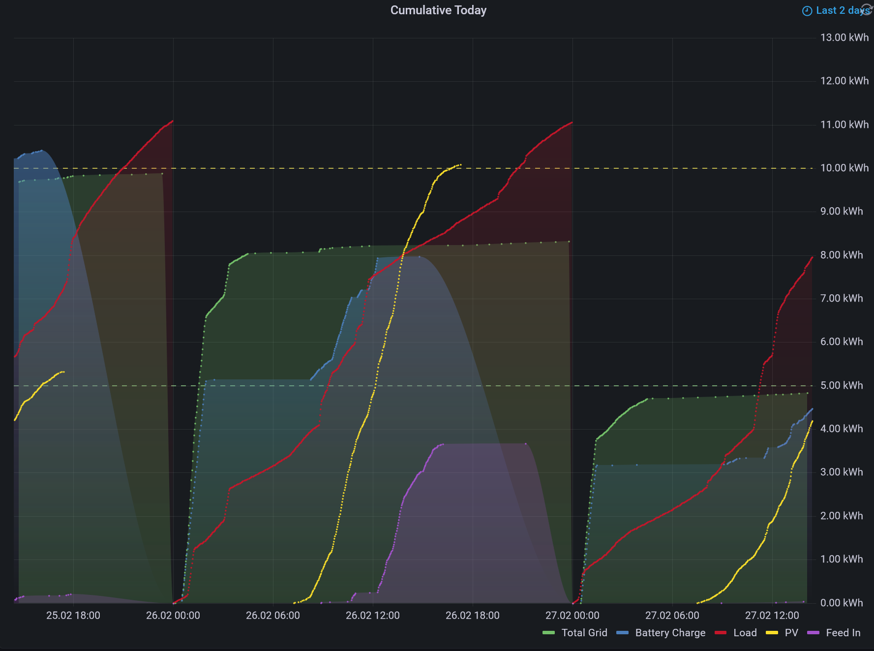

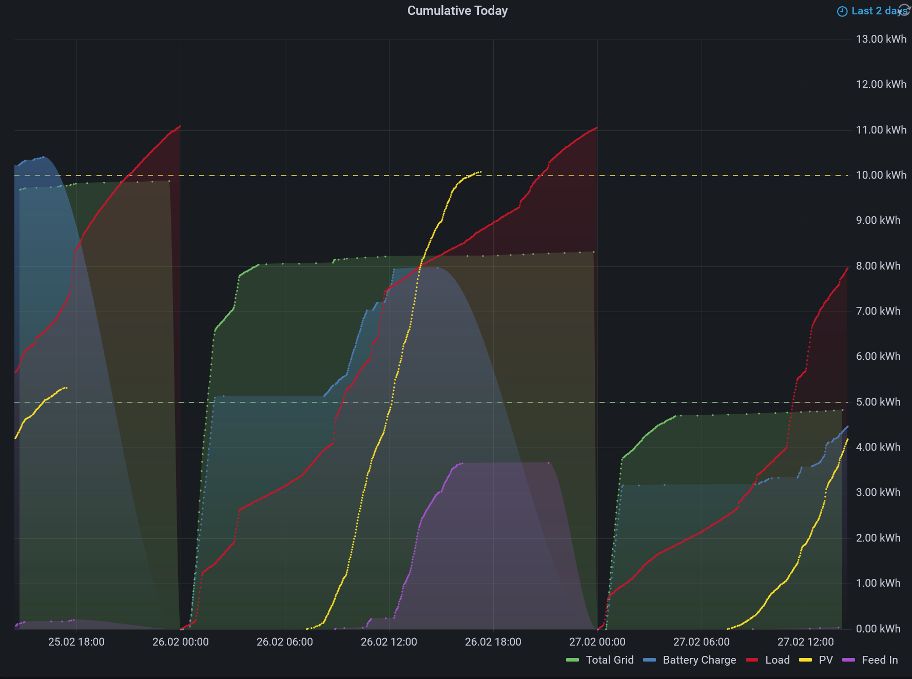

This helps me see how things change over the course of a day
This lets me see how much energy we're pulling in, exporting, generating, using, putting in the battery, etc.
