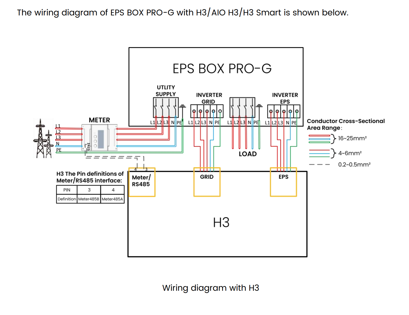

thanks for reply. I looked to eps box pro G, because smart meter is already connected to H3.
But it is unclear connection of PRO G version.
Why in this box is needed load connection? In my case it solved now without EPS box via Grid connection.
Utility supply is also load supply to my house? There is the same connection point.
According the scheme in manual I have additionally to connect with 2nd parallel cable load connection to smart meter connection...
Thanks a lot for your advises
