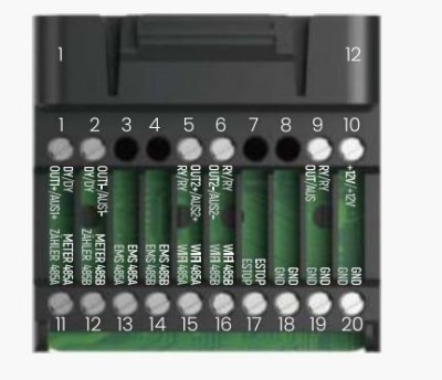

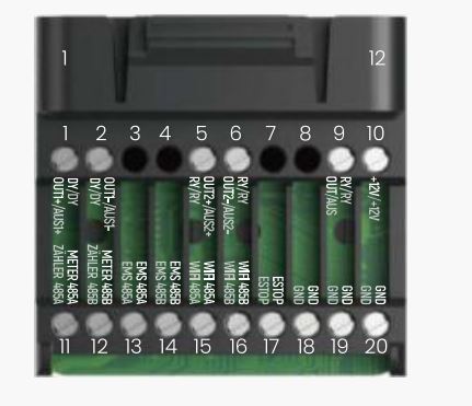

where i must connect the Cable fpr the rs 485 interface. on pin 11 and 12 is the smartmeter connected.
it´s a fox ess H3 Smart
