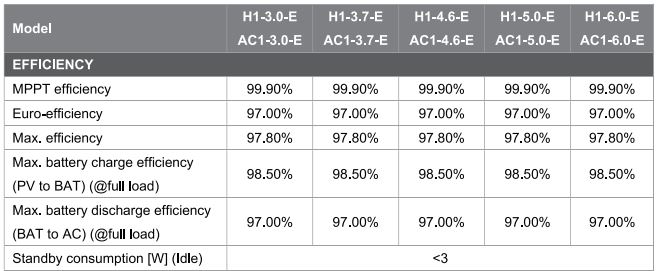

I can see this calculation does not allow for conversion losses in the inverter and my system is typically only drawing 150W or so between occasional short bursts nearer 1kW which I can imagine is inefficient for the inverter. Also my batteries are in an outbuilding so have been at around 10deg C during this period.
However, I am surprised if these factors would account for a 30% loss in battery capacity of new kit.

Is the generation meter you are using on the inverters AC output ?, I agree a meter is far more precise than a CT clamp.
If it is on the AC output it's a difficult metric as you are looking at the precise output of the inverter and not the energy given up by the batteries, the FoxEssCloud website will give you battery discharge power in kwh but it is difficult to do the calculation manually whilst load, solar input and charging is changing.
I use a home assistant that calculates the near real time losses at any point in time, this includes the 60~70W the inverter needs to stay operational which it takes these from the DC side (battery/solar), not the AC output - this is the current graph with some solar coming in as well When you are doing your 94% to 14% soc calculation do you take any losses into account?, over time they will become more significant - it's probably safe to say overnight there may is a typical average of 120Wh lost so if the 80% change in SoC is (say) over 10 hours, you would need to account for the 1.2kWh which would come from the battery.

That's really helpful, Dave - you have identified the key issue (once again). I am grateful for the clarification.
For the benefit of any other readers interested in this thread: yes, my generation meter sits on the supply to/from the inverter - between the AC isolator for the H1-5.0-E and the consumer unit feeding it.
Similarly, I recognised my calculation ignored the inverter conversion losses. Since it is fed by the battery and I am only recording the energy output from the inverter, I can't measure those losses. I was mostly relying on the quoted numbers in the datasheet which refer to 97% efficiency for Battery to AC, though I appreciate the caveat of a spec. at "full load". see below: Your assessment of 60-70W just to run the inverter is 3x more than I was reckoning from the figures I see on the power figures. Typically the PV power is 20W or so greater than the delivered power to the battery plus the house. I must look more closely when the house load is met from the battery but only 100-200W. You are correct that my overnight energy demand is mostly below 150W - with your figure of 60W to simply run the inverter, then I am easily losing 30% of the battery energy just to keep my house "alive" when the sun is not shining. That is a lot and means my original assessment that a 5.2kWh battery should be sufficient may be seriously out.
I'd love to hear the experience on this score from others - it seems the real world performance of a battery system may be well below the rated figures (e.g. 20%) and this should be better understood by the salesmen, installers as well as us users.
