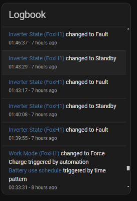

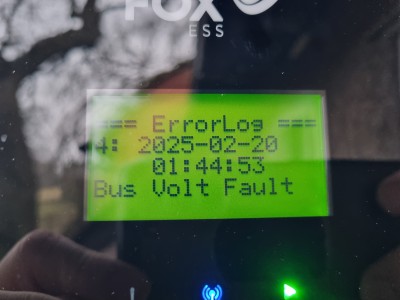

All has been well until this morning, when I noticed that the batteries hadn't fully force charged overnight as usual.
Further investigation showed that the inverter logs was showing numerous "Bus Volt Fault" starting at about 01.30 (the force charge period starts at 00.30)
This morning I've done the usual IT first fix attempt of turning everything off and back on again, though I'm not terribly confident this will fix anything and if it does that is a bit worrying!

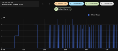

I've attached a photo of the inverter display showing the error as well as some graphs from my Home Assistant (I'm connected via Modbus to the inverter)

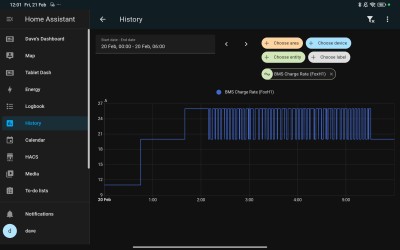

Ok yes firmware is good, I can't tell from your graph but there are those 3 power spikes from approx 4kW up to 5kW were around the time it happened - as you have modbus, do you have the BMS charge rate sensor available you can check to see if that changed... just intrigued as to why the charge power would jump like that.

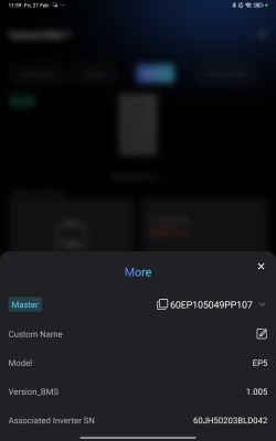

So probably next best thing to check is the BCU firmware on the EP's - easiest way is in the V2 app, click Device, Battery and click the serial number under the battery image - the BMS version is the one to read off.

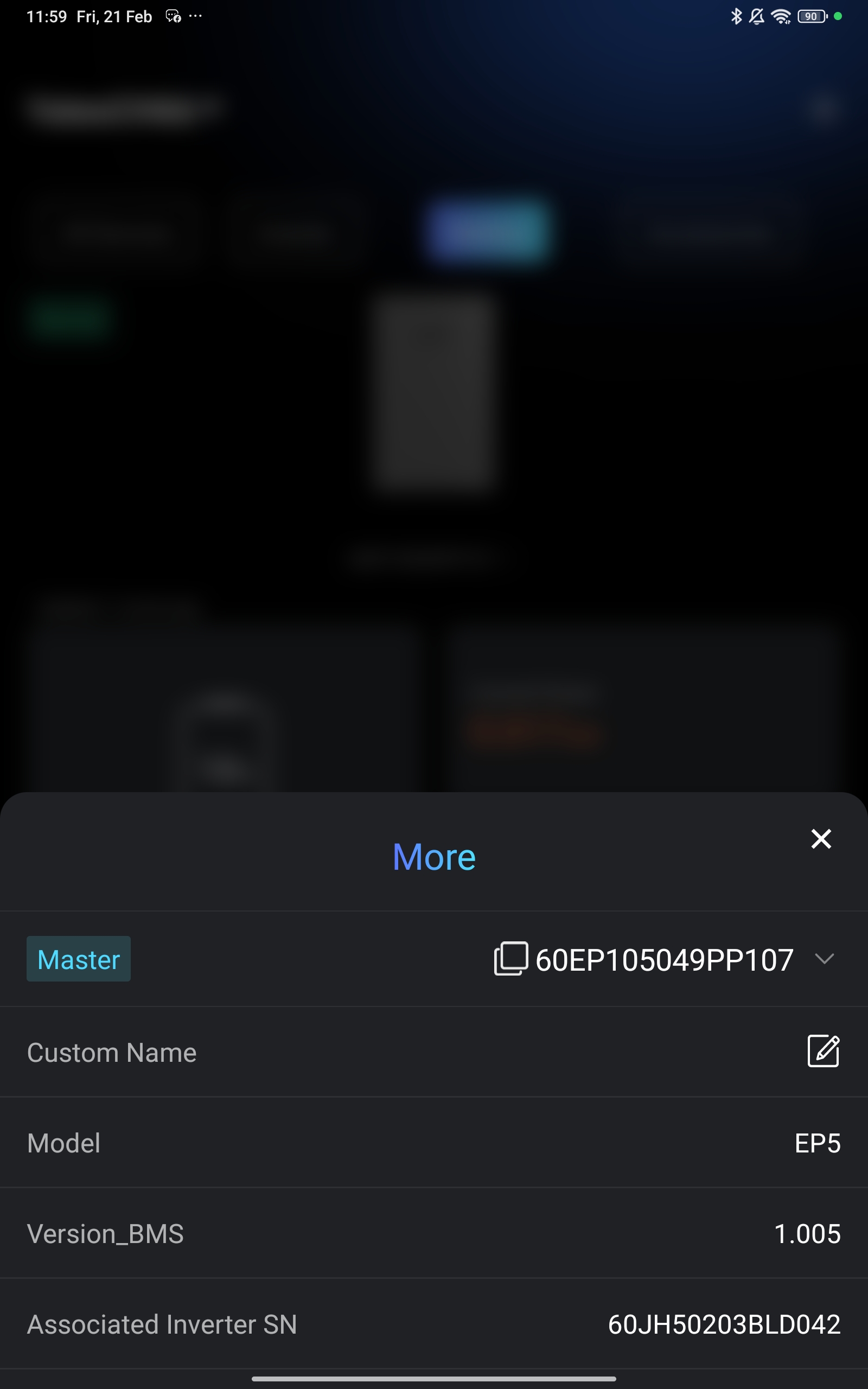

Unfortunately it seems that the three pin reset didn't work, we experienced the same behaviour again this morning.
I've attached screenshots of the BMS firmware version and the BMS charge rate graph from the previous night when this behaviour started.
Seems to me like there's a fault with the inverter most likely, how do I go about getting this resolved?
Dave

- Posts: 1855
Ok, I always think if a fault can go away on it's own, it can come back on it's own - and this needs investigating.
Your BMS firmware is almost the latest version (but latest only adds heater function for warm batteries).
If you have a relationship with your installer, you should go through them first as any warranty replacement will need them involved, but you can escalate to Fox service for investigation either in the V2 app by clicking 'Me', 'Contact Us' and click 'Support' - which will let you raise a ticket and attach images etc.. of the problem. Alternatively you can email Fox service at service.uk@fox-ess.com but make sure you include your inverter serial number.

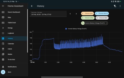

Inverter battery voltage graphing for the same time period

You sometimes see that when the batteries are float charging if you have a very low charge current set - but given the battery voltage it's unusual behaviour as the state of charge isn't particularly high.
Probably best to keep your service request simple (i.e. repeated bus volt faults) and let them diagnose, complex things get sent to their dev team to investigate.
