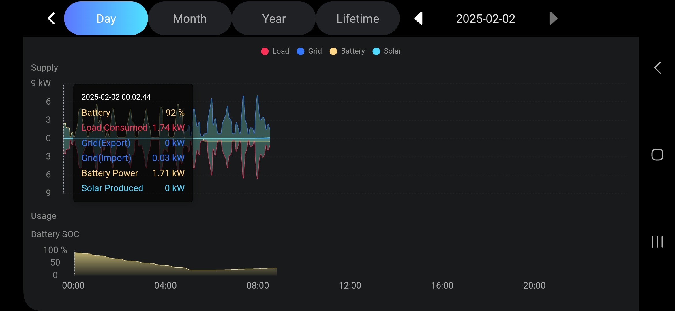

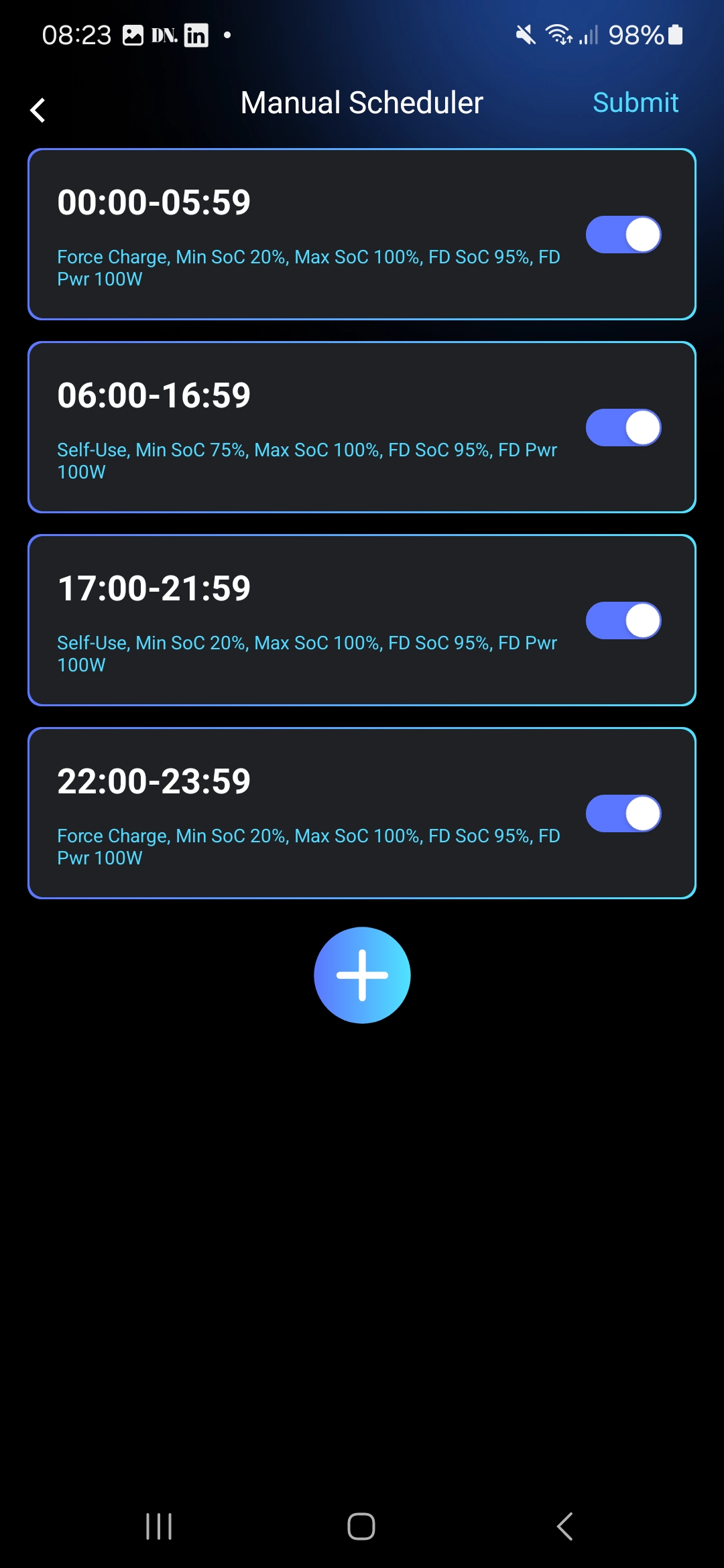

The problem is that I can't get the mode schedule to Force Charge more than once after cycling the system down and up (down: Battery, PV DC, Grid - wait until screen is blank plus some - up: Grid, PV DC, Battery). My latest try I even had two Force Charge after one another (since low tariff passing midnight), but only the first charged and the following just acted as self-use hence draining my batteries during cheap hours. Using the standard/simplified force charge is working multiple times though.

The notch in the SoC is where I rebooted the system, no altering of settings at all after that
Passing midnight it was up just shy over 90% SoC, but instead of continue force charge it went into self-use
Been careful not to overlap. The min SoC value of 75% in self-use is not my end game, just during testing
Standard scheduler is and were disabled

Thanks for posting, the scheduler functions have only recently been released on the H3 series - i've checked your firmware versions and they are current.
Schedule timings and settings look fine, although I have found it is best to set FDSoC the same as your battery reserve level (not 95%), i've seen a few issues with that from time to time.
Your battery reserve capacity is very high at 75% - is that intentional ?, normally it is set the same or a little bit higher for use on EPS

The 75% battery reserve capacity is only an artifact from previous test runs where I didn't want a period of self-use drain down batteries to 10. Also, the minSoC 20% will go to 10% once I get things to work.
My ambition is to find a good schedule time-vise (given the normal way tariffs changes over the day) and let that stay. Then using minSoC to give some room for PV depending on cloud forecast and time of year and during the day ours when tariffs usually are higher but still ok, then let minSoC down to 10 when tariffs are always high and we start to consume more power (i.e. 17-22).
I'll let FDSoC follow minSoC then just in case.
