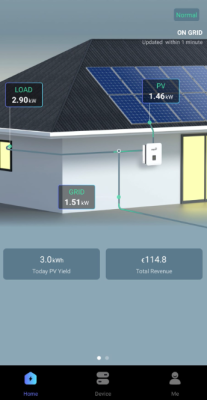

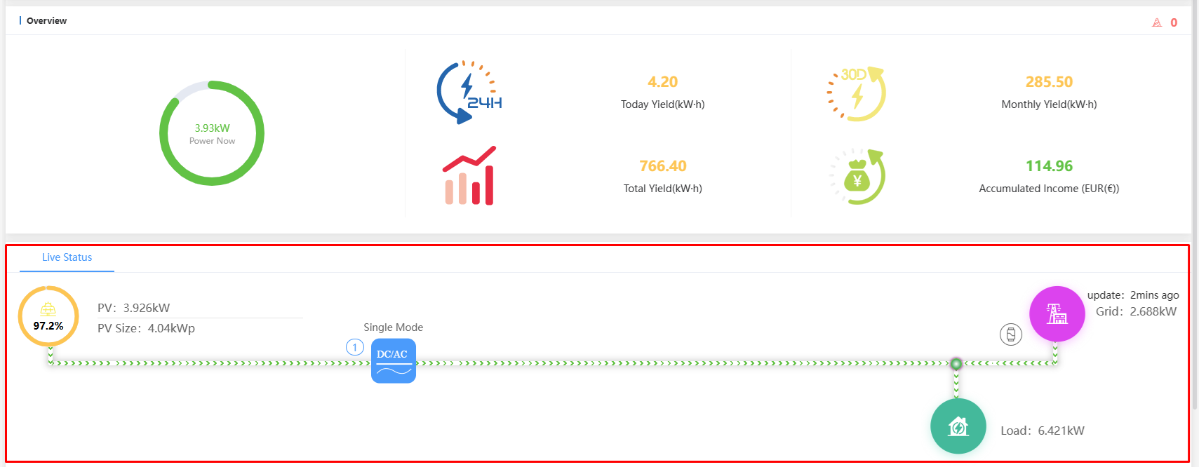

On the mobile app and foxesscloud.com, namely on the plant animated visualization, I can see:
- Current PV
- Current Load
- Current grid injection/consumption
Screenshots below:
This proves that the meter itself is working and correctly linked to the FoxESS account.

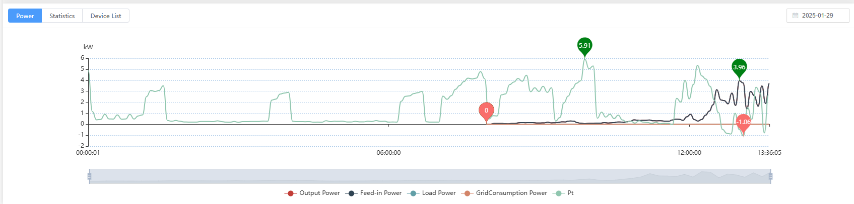

1) On the website I get the following chart:
This chart has the solar energy produced (black line) and the Pt only (I guess the result of Load - Solar produced). But as we can see, it has nothing else, namely the Load over time or the grid consumption power, which are always zero.

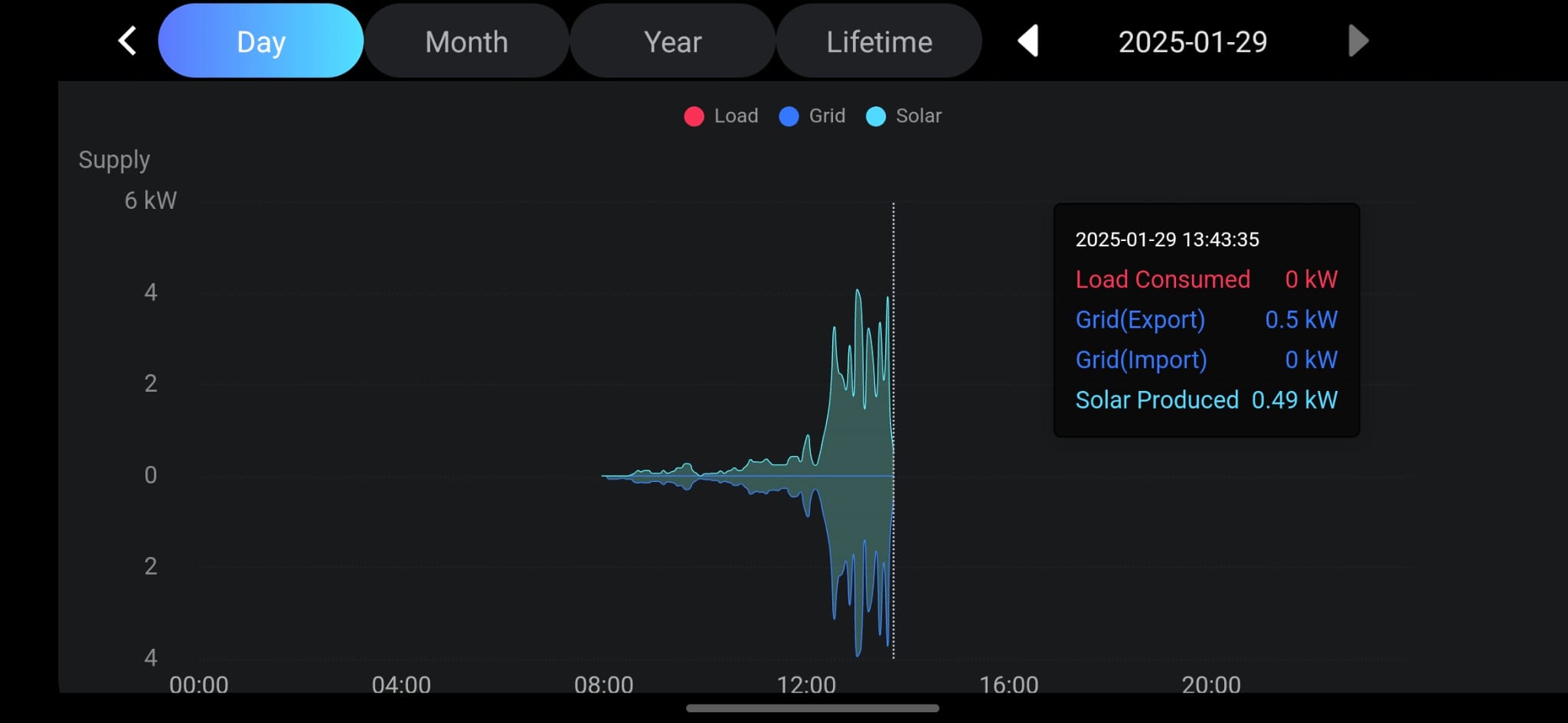

2) On the app, I get the following:
Again, this seems very incomplete: load is also always zero (incorrect) and hints that everything I produce is exported to the grid?
Can someone explain this behaviour and hopefuly provide some help?
It's like the meter is linked to the account but not set as the right type of device or similar? I was expecting to at least see the Load over time on some graphic (without having to do the mental math of Load - Solar, which is only possible on the website anyway).

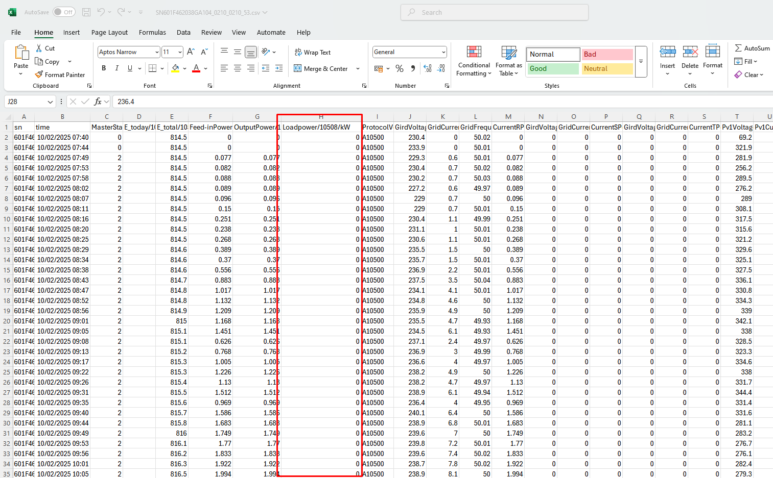

Unfortunately, I wasn't able to get anywhere near the resolution of my issue. New piece of info that I managed to get while trying a fix - when exporting the Inverter data through the app (Me > Data > Data Report), I get the following, which again says Load = 0 at any given time:
(Full report: https://www.foxesscloud.com:443/public/ ... 210_53.csv)
I hope this helps someone help me... any clue?

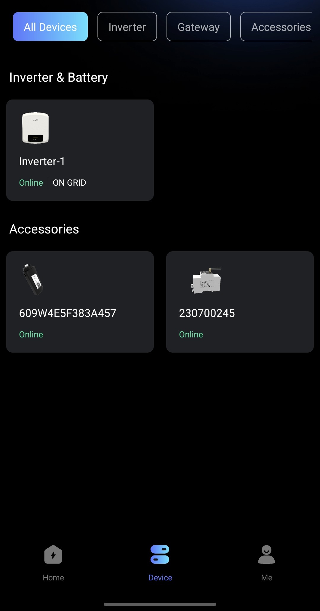

Regarding your question, I connected it via the Fox Cloud app. It wasn't a very straightforward process as it should've been, and only worked after 20+ attempts, but follow the steps below and it should eventually work:
  • Go to "Me" and click "WLAN Configuration"
  • Enter the device SN or scan it using the QR code. Don't press next yet
  • Restart the Chint (using the corresponding breaker)
  • After it is flashing again, press Next (or whatever it says) on the app and it should connect (IMPORTANT: it only works with 2.4 ghz networks... and I fiddled around with the security encryption type (WEP vs WPA2), too, not sure whether that made a difference or not
  • It should show up on the Devices tab as online afterwards - see below

This is sadly due to the String inverters while showing load doesn't record it. This feature is currently only supported on hybrid systems.
