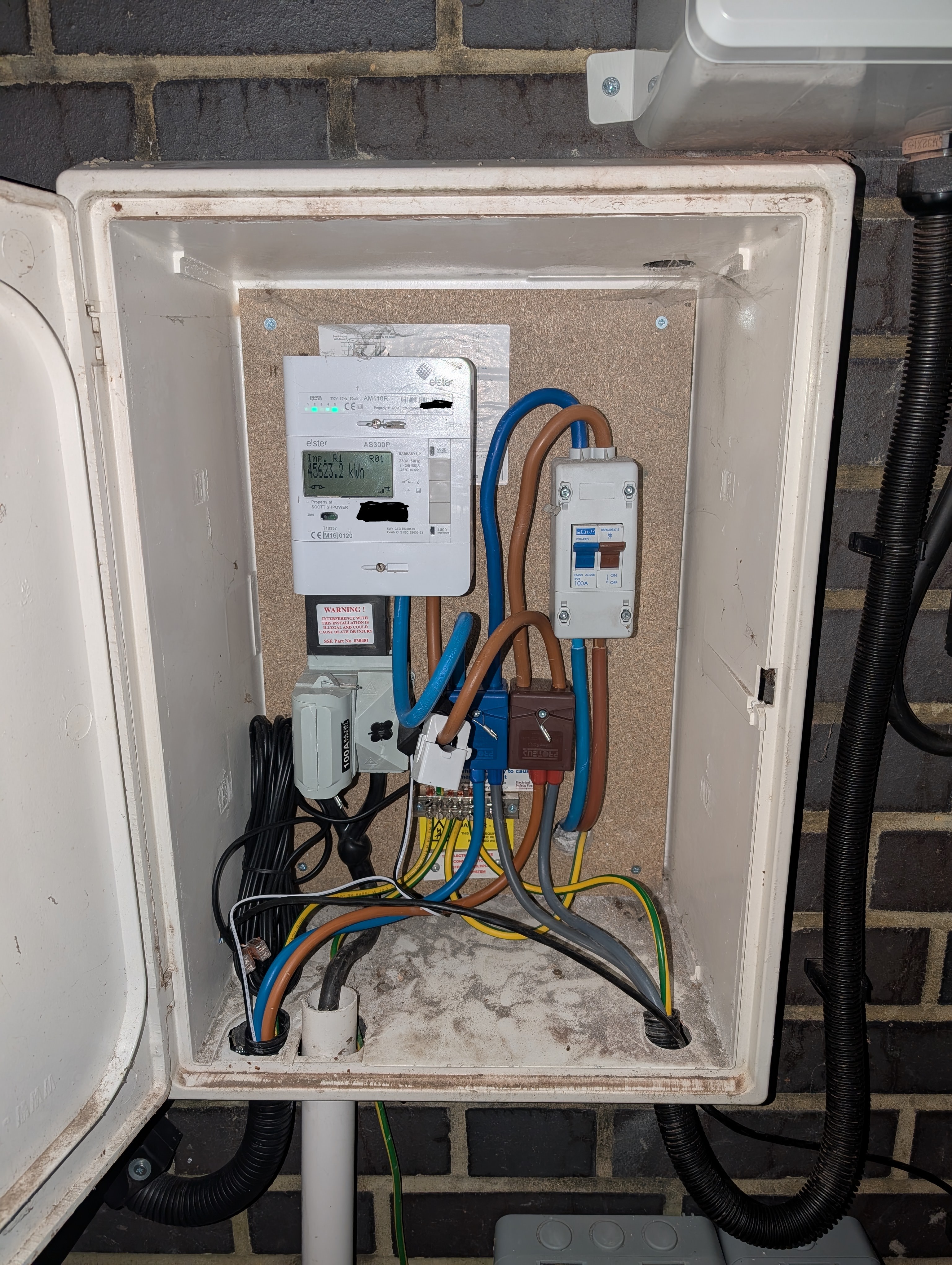

On a related theme, when my EV charger was installed they have wired it so that it now drains the EP11 battery when IOG schedules peak rate charging windows and the EP11 isn't set to Force charge. The installer said he wasn't trained in solar and so could not add it as a separate circuit before the main house and solar circuit, i.e. straight after the tails coming out of the meter in the attached photo, but that should be simple shouldn't it?
Yes, a henley block on the tail straight after meter where the white CT clamp is.NickKendall wrote: ↑Mon Jan 20, 2025 7:57 pm On a related theme, when my EV charger was installed they have wired it so that it now drains the EP11 battery when IOG schedules peak rate charging windows and the EP11 isn't set to Force charge. The installer said he wasn't trained in solar and so could not add it as a separate circuit before the main house and solar circuit, i.e. straight after the tails coming out of the meter in the attached photo, but that should be simple shouldn't it?
I must admit I wouldn’t have wired any of it the way it is - so just to confirm i’m reading it right, bottom left is the feed to the EV charger, bottom right is the solar inverter and the feed through the 100A double pole switch through the backboard is going to the house consumer unit ?
Hi Dave, thanks and yes that is correct.
How would you wire it please?

That’s a good question, it certainly has all the hallmarks of the inverter limiting the charge because the load is too high - so a quick question, does your car chargee get seen as house load by the inverter when it is charging ?
Thanks. Yes it does which is another problem given the interaction with octopus IOG smart charging I am getting the EV charger installer back to rectify. Do you think that could fix the issue?
Yes definitely, your main fuse is plenty big enough to cope with all your loads, once the EV charger has been moved on the ‘grid-side’ of the inverters CT clamp it cannot be affected by anything the EV charger does.

Quick update and thanks to Dave for the advice!
I ended up having the EV charger installer come back. They agreed it should have been fitted with a Henley block.
Now the inverter can only "see" house load excluding the EV charger, so the EV charger will not discharge the house battery and both will also charge at the same time (overnight).
Before doing this, my "bodge" was to set the EV charger to only charge during 4 of the 6 hour cheap overnight period. The house battery was then set to force charge during this period so it would not discharge to the car and would then only charge once the car was full. This meant it wasn't possible to use the smart tariffs (IOG) for the flexible slots.
