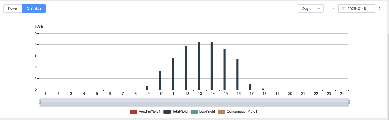

I have a G8 inverter and I can't see all the historical stats when I check on them. All I can see is the generated energy but no information regarding feed-in energy or grid consumption energy... why is that?
G8 is a string only inverter which would require a ct or meter to be installed to provide load and grid data.
As string inverters turn off at night time when the array drops below 80-90 volts I would recommended a separate ct monitor that remains turned on 24/7
