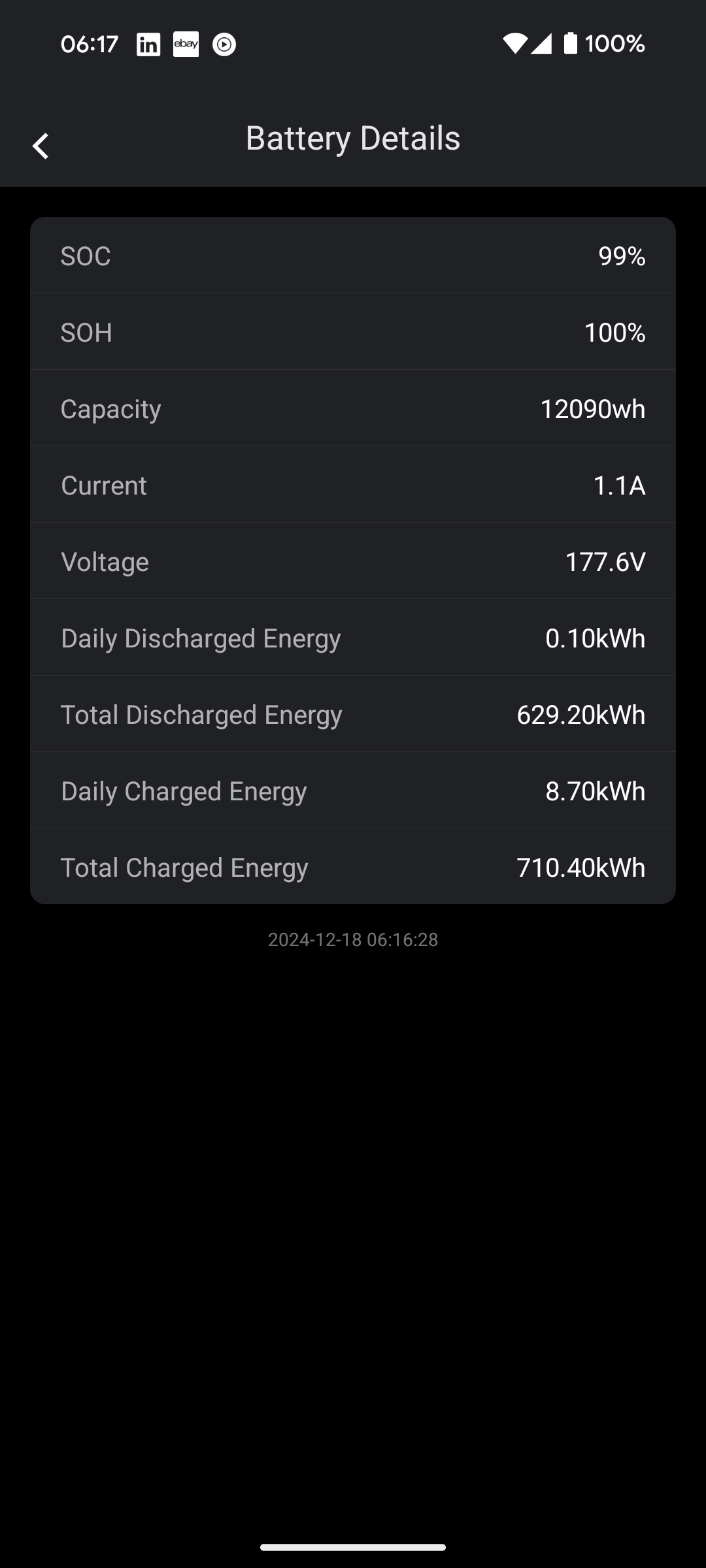

Hi. I've recently had another fox Ecs4100 battery added to my stack and it's not charging to the full capacity. I did notice when the installer added them they original batteries were at 75% soc. The daily charge energy is only saying 8.7kwh which varies a little but it should be way closer to the 12090 which 3 batteries take. I have taken the batteries down to 10% and then all the way up at night to try and cycle the batteries but it's been 14 days now with no luck.
