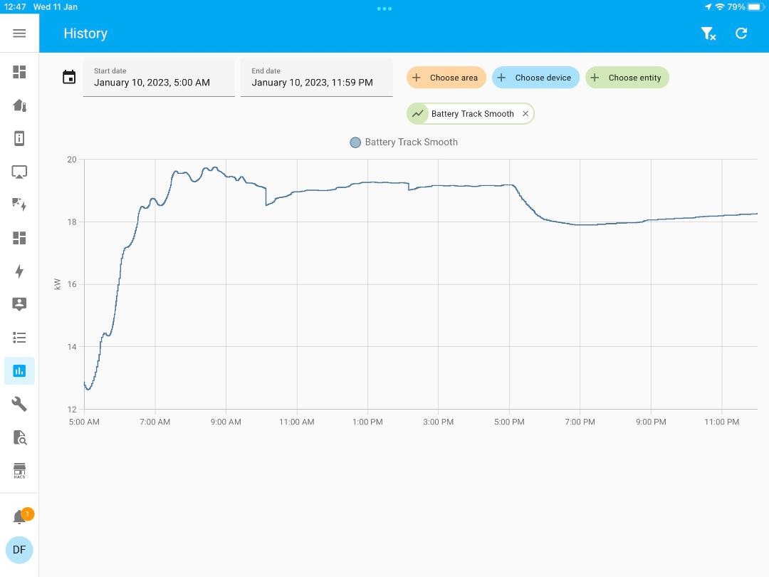

The sensor gets more accurate as the day progresses and helps to smooth out any SoC recalibrations, it is useful to compare changes on a day by day basis - for example it shows temperature effects reducing capacity.

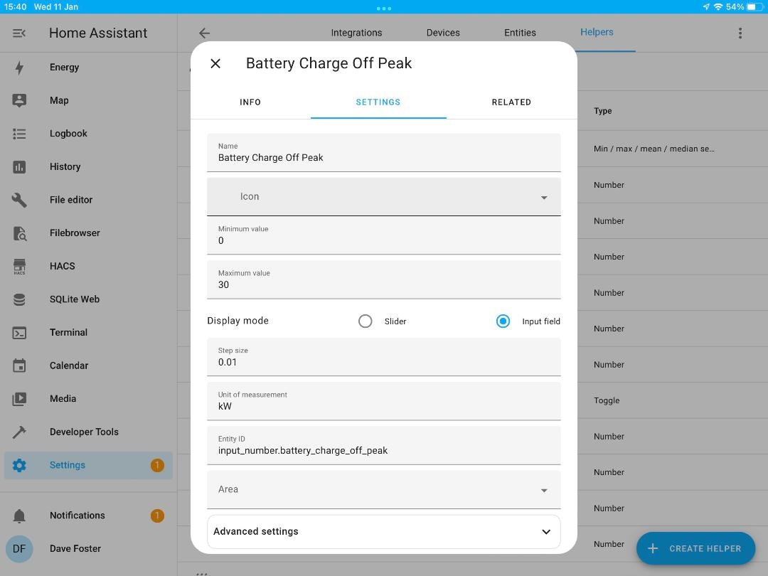

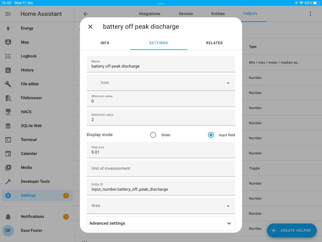

To start firstly create the helpers (HA Settings, Devices & Services, click ‘Helpers’ at the top and ‘+Create Helper’ in the bottom right corner, select ‘Number’) - the helpers should be named
battery charge off peak
The minimum value should be 0, maximum value should be 30, Display mode should be 'input field', Step Size should be 0.01, and Unit of Measurement should be kW
then create the next helper
battery off peak discharge
The minimum value should be 0, maximum value should be 2, Display mode should be 'input field', Step Size should be 0.01, and Unit of Measurement should be kW

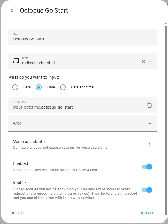

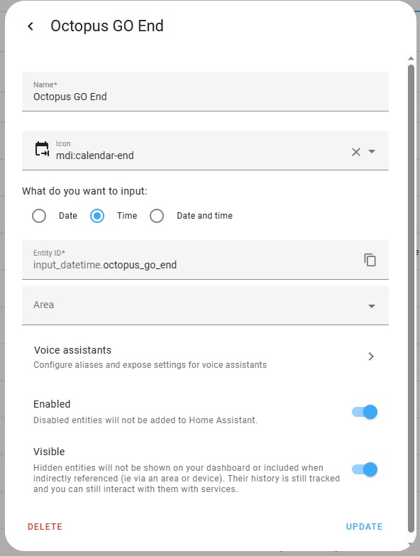

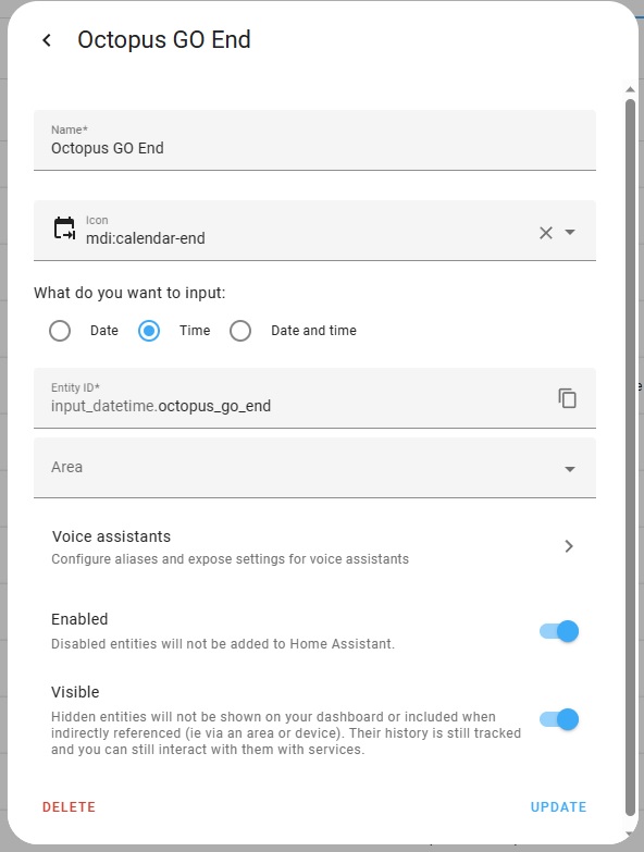

Then create the helpers for the start and end of your ECO tariff (i've named them Octopus GO start/end which is 12:30 and 04:30 but if you are on Flux just set them to 2am and 5am)
Octopus GO Start
Octopus GO End
Click on each helper and set the start and end times to your Tariff start and end times i.e. for Octopus Go it is 12:30 start, 04:30 end, for Flux it would be start 02:00, end 05:00

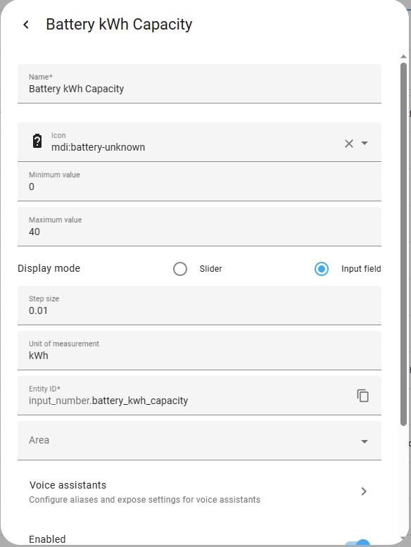

Finally create the helper that contains the actual storage size of your battery pack
Once created click on it and set the actual storage size of your battery pack, for example if you have 4 * HV2600 batteries it is 4*2.56kwh = 10.24kWh.

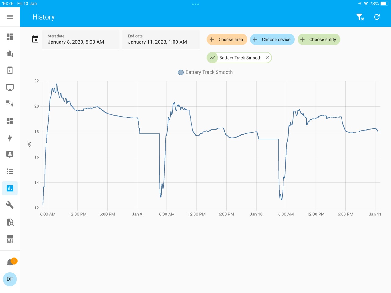

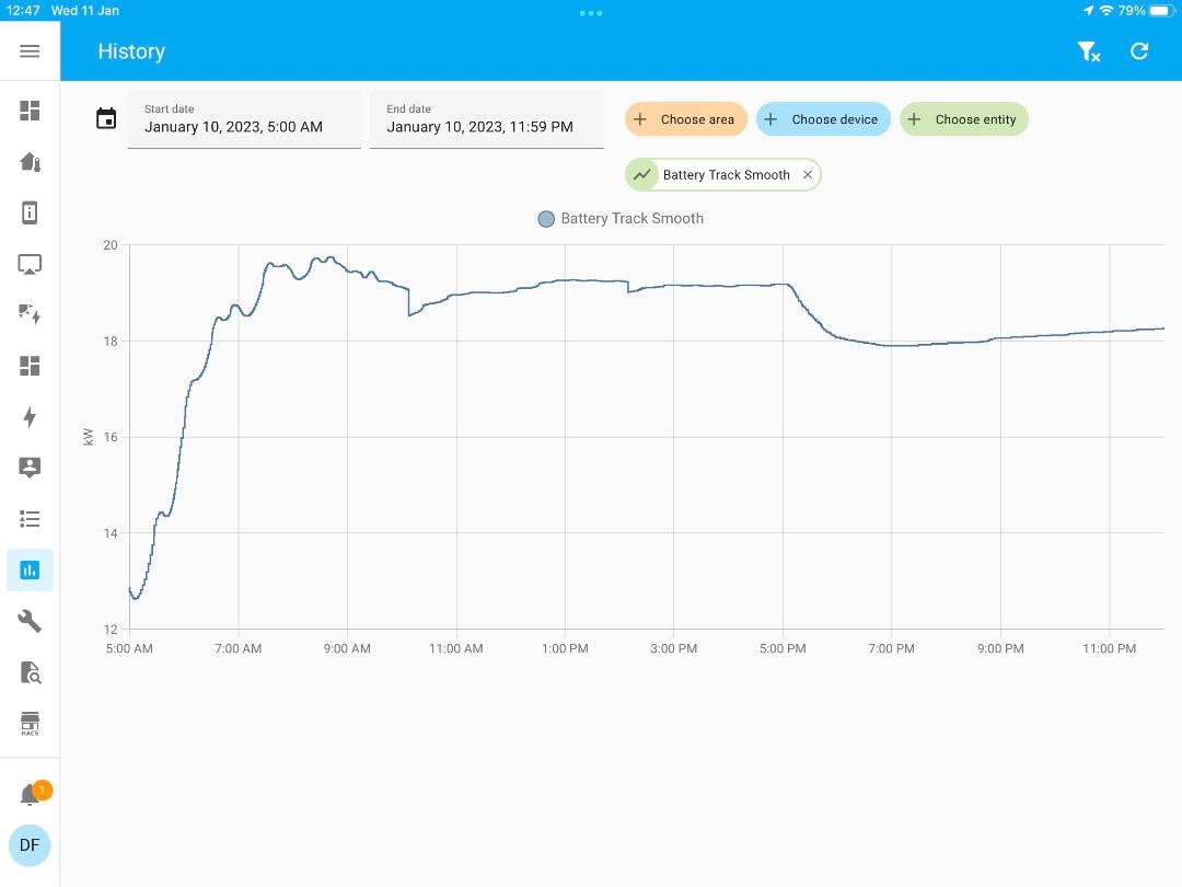

The sensor will show the calculated capacity of the battery it will start out very inaccurate and as the day progresses and the SoC drop gets bigger the accuracy improves - it is most accurate at the end of the day 23:59:59
And that's it, please feel free to use or modify it to suit your eco tariff times and if you can suggest any improvements, please let me know.
I have attached a couple of images of the sensor from my system (an 18.2kWh battery).

I've set up your updated sensor on my HA, so far the results are not promising, at midnight last night the reading was just below 9kWh when it should be closer to 13! (6xHV2600 & 15% Min SoC).
@Dave Foster, can I ask what battery firmware versions you have? My working theory is that my BMS (which is on 1.07, batteries on 1.05) is doing a poor job of judging SoC and is not using the full pack capacity as a result. I've managed to get my installer to update the inverter firmware but for whatever reason updating the BMS and battery firmwares seems more difficult!
Edit: As an aside, the BMS kWh Remaining value does read a little over 13 when the battery is full...some part of the system "knows" - what the capacity is, or should be.
FoxESS Modbus HA Integration
Contact Fox here
Re: Battery Capacity Tracker
calum wrote: ↑Tue Apr 11, 2023 10:10 am I've set up your updated sensor on my HA, so far the results are not promising, at midnight last night the reading was just below 9kWh when it should be closer to 13! (6xHV2600 & 15% Min SoC).
9kwh is not such a great reading, it normally reads a little high - and you would hope the kwh remaining would be much nearer 15.4 at full (mine is very accurate now). I would normally suggest you do a full grid charge cycle but if they are V1’s get the latest firmware first.
The batteries on mine are Master(BMS) 1.016 and 1.013 slave (Batteries), if you have the latest inverter firmware I would definitely recommend you get the batteries updated - this version has big improvements in SoC stability, tracking and battery charge absorption over 1.07/5. - it also does away with soc being limited to 99%, now reporting full range to 100%.

I've updated the code and instructions above, i've made a number of improvements whilst I was there, the first is to add a start and end time for the charge period (i've called it Octopus Go for now but you can just set the time to whatever your charge period is).
The second improvement is to add the 'actual' capacity of your batteries, you'll need to set this to whatever your expected kwh is.
And the main change is that as this was originally intended to work effectively during winter months when you charge every night, it was quite inaccurate with just solar charge - so I have improved that by resetting the counters whenever solar achieves a 100% charge (much like a grid charge) and it works quite well on just solar as well.
Hopefully everything above is now updated, i'm running this version fine but if you have any problems let me know.
