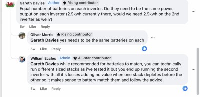

Oh boy you can’t make it up, the HV V1’s absolutely do work with the G2 inverter - there are hundreds of systems out there with V1’s and mixed V1/V2 packs.
On running in parallel that sounds like a lazy answer - if both inverters have similarly spec’d battery stacks it will work, it will work even if they are slightly different i’ve seen that working on a system in South Africa (also see attached from Will) - It’s possible Fox have changed guidance because of issues in the field - obviously you don’t want to breach warranty but I would definitely get that confirmed in writing.
