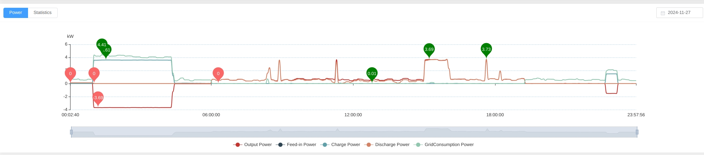

When I had 4 batteries - the overall numbers did add up - the house uses roughly 15kWh of energy a day and full battery lasted roughly 3/4 of a day.
The idea was that with 7x batteries we could survive the whole day easily on a single charge when the electricity is cheap (in winter).
But... The numbers don't add up somehow...
I have the system set up to charge between 1am-6am and on self-consume setting, min soc: 15%.
Example yesterday: Charging started: 00:57am @ 3.6kW
Charging stopped: 04:27am.
Grid consumption stopped: 06:01am
Total energy stored within the battery: 3.5h * 3.6kW = 12.6kW
Battery consumption started at around 6am then...
Now the idle consumption throughout a day is 700W (it's mostly 500-600 but spikes to 800 so let's say average 700W)
Counting spikes (and really rounding it up) throughout a day:
08:17-08:32 - 2.4kW - kettle
08:47-08:57 - 3.6kW - kettle
11:12-11:22 - 3.6kW - kettle
14:57-16:07 - 3.6kW - hot water cylinder (1h at full power)
17:32-17:42 - 3.6kW - kettle
18:07-18:17 - 2kW - no idea
19:17 - battery discharged to 15% - grid consumption started...
So let's summarise:
Between 04:30 and 19:17 I have used ALL of the energy stored...
17920Wh theoretical capacity at SOH 100%
SOH is 95% at the moment - so max capacity is 17920 * 0.95 = 17024Wh
Min discharge level is set to 15% - so 17024 * 0.15 = 2553Wh
So usable energy capacity is 17024 - 2553 = 14.471kWh (theoretical)
Now let's sum up the usage between end of charging and depletion to 15%:
19:17 - 06:00 = 13 hours and 17 minutes - let's round - 13h at 0.7kWh = 9.1kW
then the spikes:
10 minutes at 2.4kW = 0.4kW
10 minutes at 3.6kW times 4 = 2.4kW
10 minutes at 2.0kW = 0.3kW
that's total of 3.1kW
Total consumption of 12.2kW MAX (and it is heavily rounded up).
So, I'm missing a couple of kWh here and that doesn't take into account the production from solar 1.3kWh for this day that usually just tops up battery anyway.
Data export from essfoxcloud for this day:
PV yield(kWh) 1.29999999999927
Charge energy(kWh) 10.7000000000003
Export energy(kWh) 0
Import energy(kWh) 19.1999999999998
Load consumption(kWh) 17.8999999999996
AC output energy(kWh) 12
Discharge energy(kWh) 12.9000000000001
Batteries sit in a garage and are NOT insulated...
And finally questions:
1. Battery insulation - obvious point to do to improve things...
2. Is there a change-log for firmware versions for both BMS and batteries? If so - where?
3. Are any of the versions listed above - known to cause problems?
4. How do I upgrade firmware on both BMS and batteries?
5. How do I balance the batteries? Do I have to do other than just deplete to 10% and charge to 100% few times?
6. Is there a way to export more detailed usage from the inverter itself?
7. These inverters don't support more than 7 batteries right? (the Dial on BMS set to 5)
