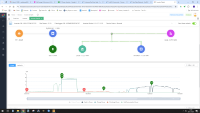

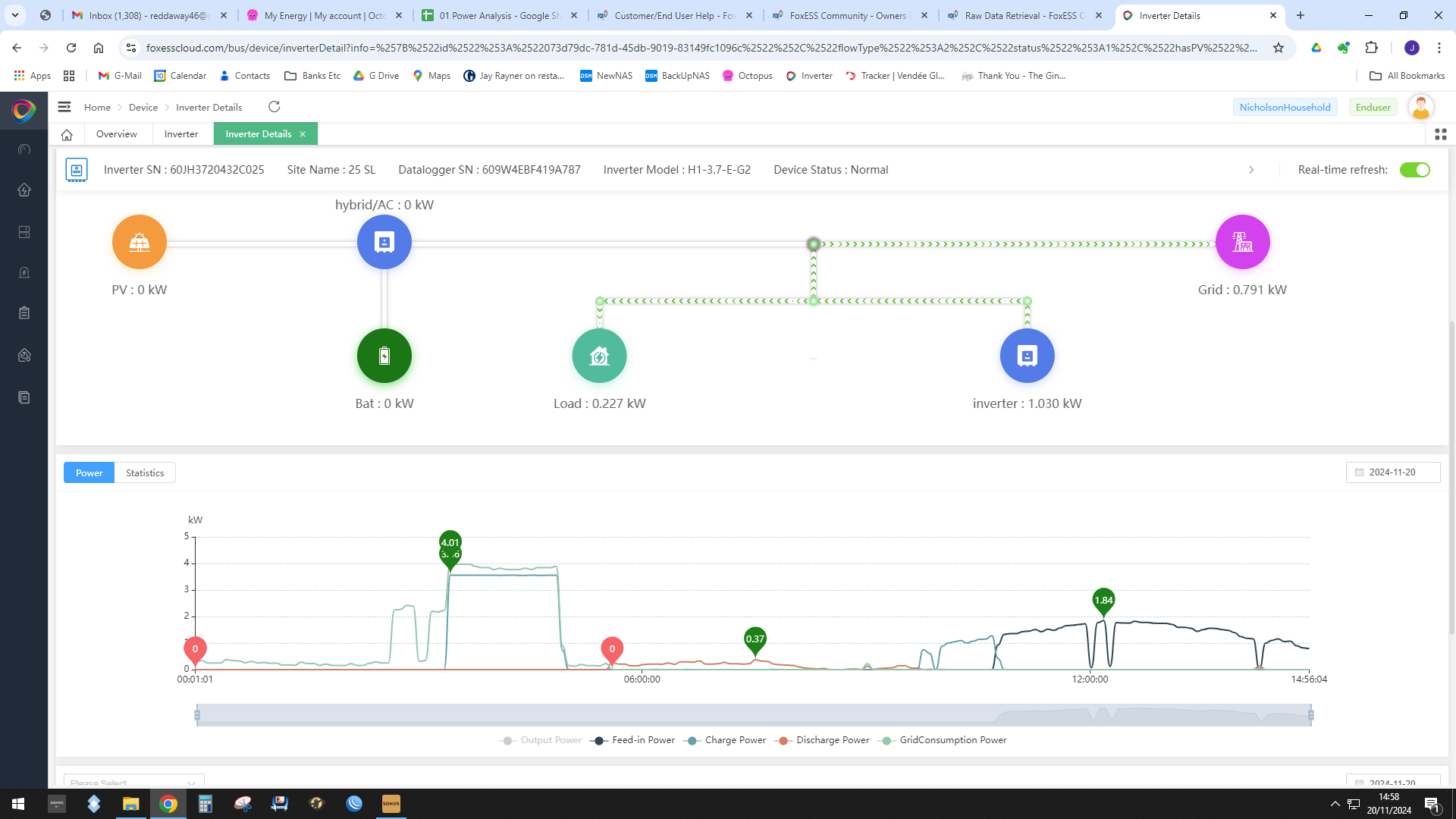

Yes, Paul, that's exactly the setup we have, with a 2012 SunnyBoy inverter; when the battery was installed a clamp was fitted on the output cable with a lead into the Fox inverter.
The Fox app (screenshot attached from my Windows PC, but the Android app is very similar) shows the feed from the old inverter coming in from the blue "Inverter" graphic rather than the yellow "PV" source on the left which is redundant in this setup.
The lower part of the screen shows how the panels topped up the battery for an hour or so from about 09:40 and then the black line shows up when the battery's full and the system switches over to exporting. All good stuff on a nice sunny day like today!
