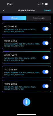

I'm on Octopus Agile (hence the night and day topup slots - I haven't found the Agile integration reliable enough yet) and here are my Mode Scheduler settings :

No idea why I didn't think of it before (too focussed on Mode Scheduler and before that Agile Integration I guess) but as there’s some PV today I switched off Mode Scheduler and set my charge from grid times in the “legacy” settings.
Guess what - they work exactly as expected - no clipping of PV output once battery reaches 100% SoC.
I’d say this demonstrates a clear bug/issue with mode scheduler Forced Charge (at least on my H1 Gen 2 inverter)…..

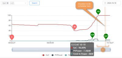

I've also encountered this issue.
Inverter KH9 Inverter with EBS4800 battery stack (installed Sep 2024 so still a bit new to me)

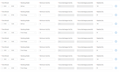

Fox UK updated the Inverter for me and I've now got new column MaxSoC(%). (Previously I was trying to make it work with just the Minimum SoC(%) column.)
I wanted to use the mode scheduler to better use the Octopus Cosy cheep tariff (UK )(04:00-07:00, 13:00->16:00 and 22:00->24:00, with the expensive time 16:00->19:00)
But also still use the solar if it was a sunny day (i.e. Autumn and Spring).
- 04:00-07:00 - Force to 65% (65% should see me through to 13:00 if the sun does not come out)
- 13:00-14:00 - Force to 50% and let the sun charge more if available
- 14:00->15:00 - Force to 70% and let the sun charge more if available
- 15:00->16:00 - Force to 90% and let the sun charge more if available. (90% should see me through the expensive 16:00 to 19:00 period)
- 22:00->24:00 - Force to 65%
I could see the solar clipping while it was charging. See (1) bottom right. I disabled the mode scheduler, clipping stopped and exporting started! This is a screen shot that should highlight this.
I assumed a gentle ramp up of the battery charge would best get me ready for the expensive period but I might time how long it takes to go from 12% -> 100% and set a mode for that to minimise the period that exporting is stopped.
Fingers cross they fix it soon!
