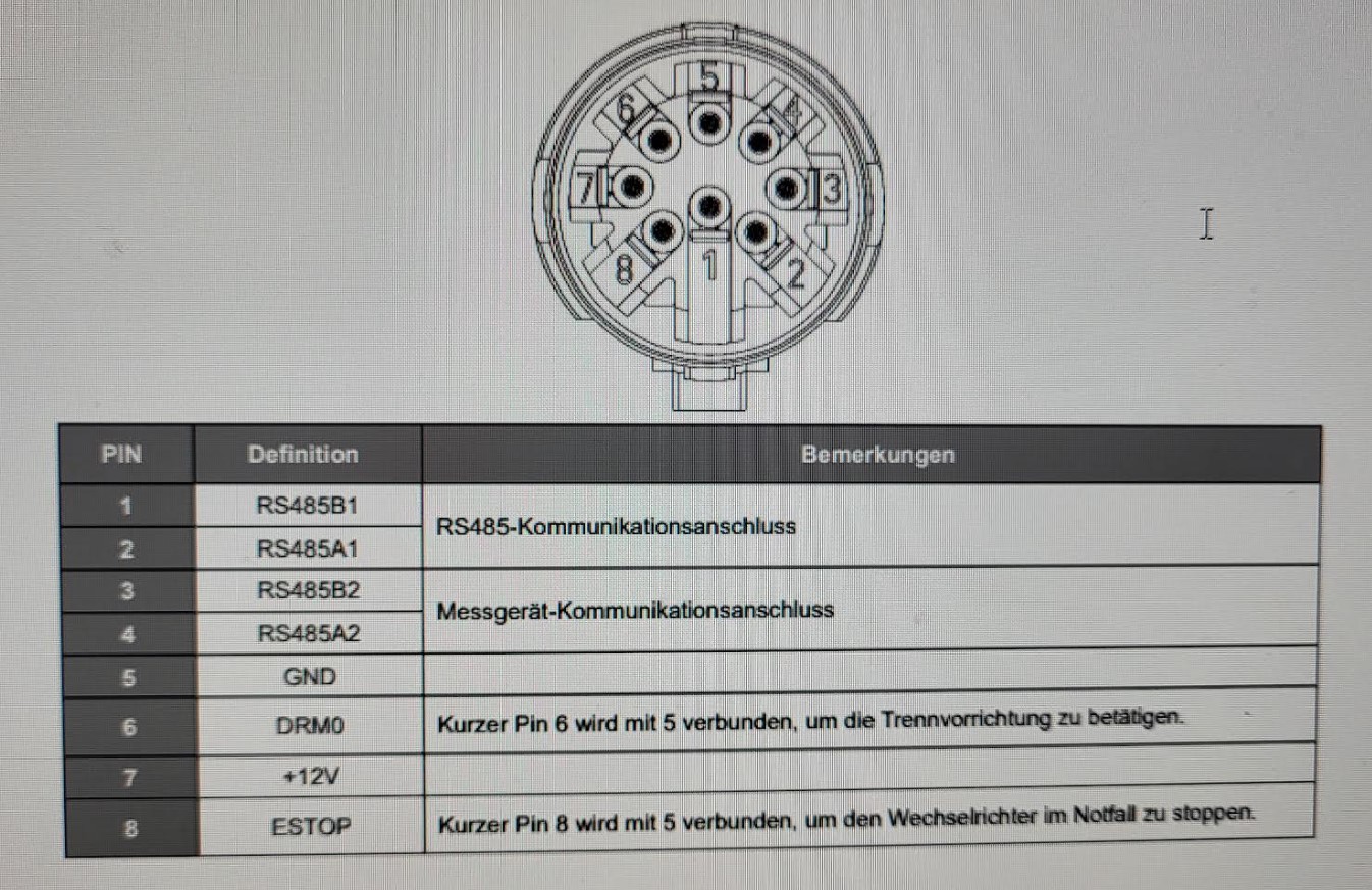

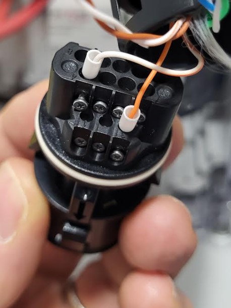

Does anyone know the pinning of the T8-G3 connector?
The documentation shows an 8-pin connector, but I found a 16-pin connector (a meter from the installer is connected to pins 3+4). I used pins 1+2

2. Question
