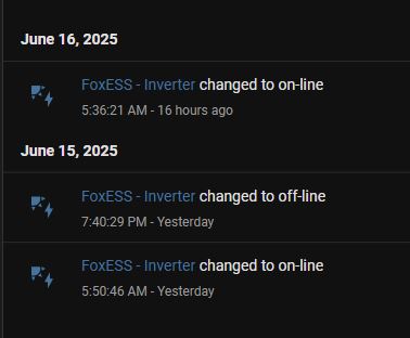

Posted: Mon Jun 16, 2025 5:44 pm
by talal.hassan01
Hey Dave,
Hope you are doing well and rocking!
Noticed a bit of an odd behavior today, and I most likely think it is due to maybe FoxCloud this time.
My inverter didn't move from On-Grid to Checking or Off-line today. The Inverter status on the FoxCloud website is also showing Normal instead of Offline.
Attaching screenshots here for your review :D
Re: T10-G3 Inverter Status during non-solar hours
Posted: Tue Jun 17, 2025 8:25 am
by Dave Foster
I’ve still got your apikey so ran that to check and yep, the cloud is thoroughly confused not only is it returning status 1 (on-line) in the device detail, but also running state 163 (on-grid)… not much I can do about that one.. :?
I’ll monitor for the next day or two to see if it’s a one off or some new behaviour it has added.
