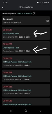

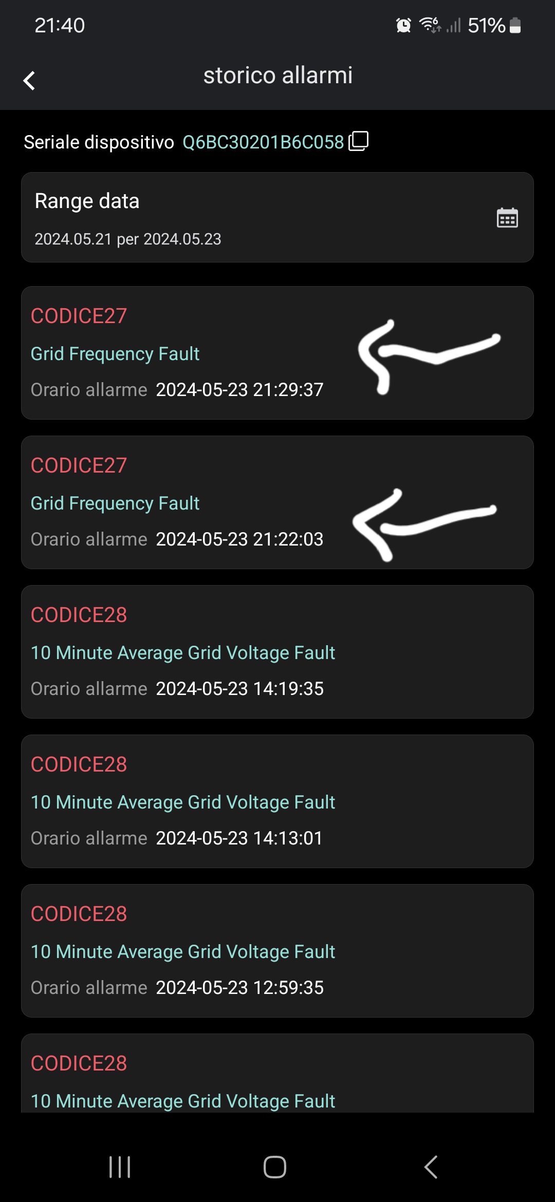

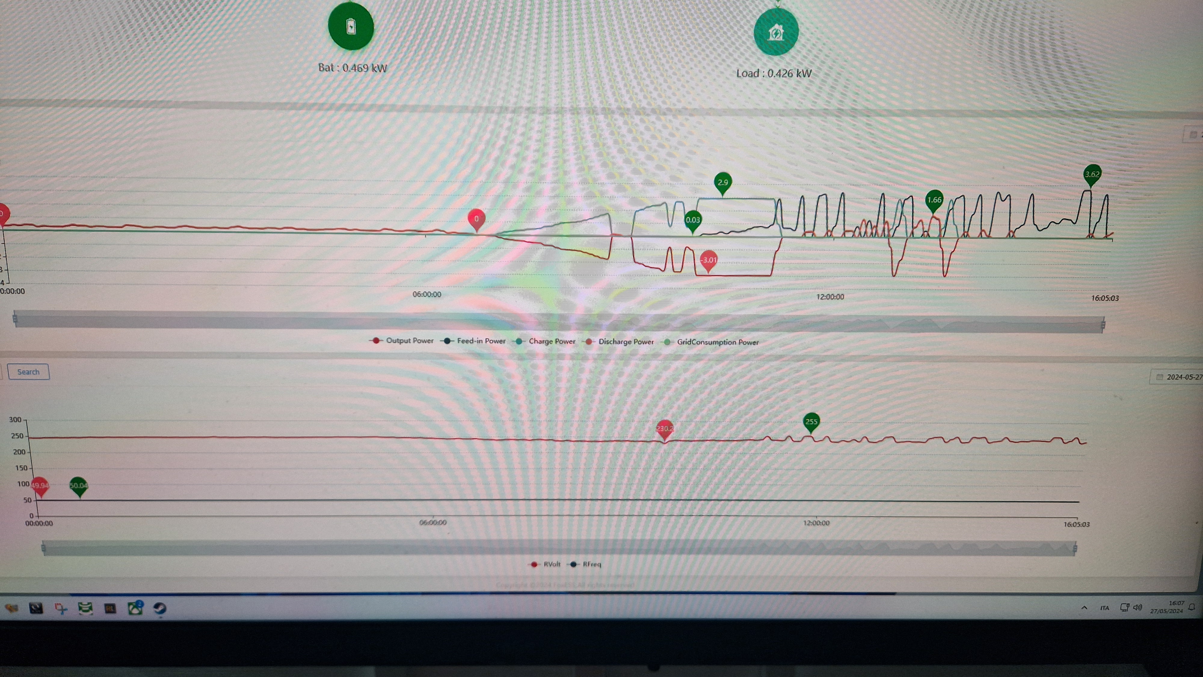

I think you must be getting some very quick shifts in frequency that is tripping your inverter but they are not being recorded in the graph as the samples are 5 minutes apart.
The CEI0-21 standard tests with a lower limit of 47.5Hz (upper 51.5) so lets set the lower limit to that - in ‘grid para’ can you set your Fac1 lower to 47.5 then both of your Fac limits are set to the standard.

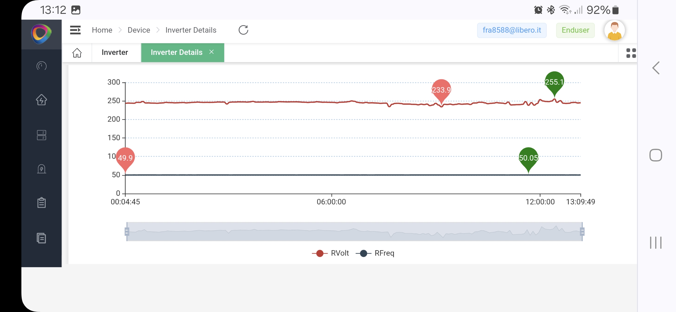

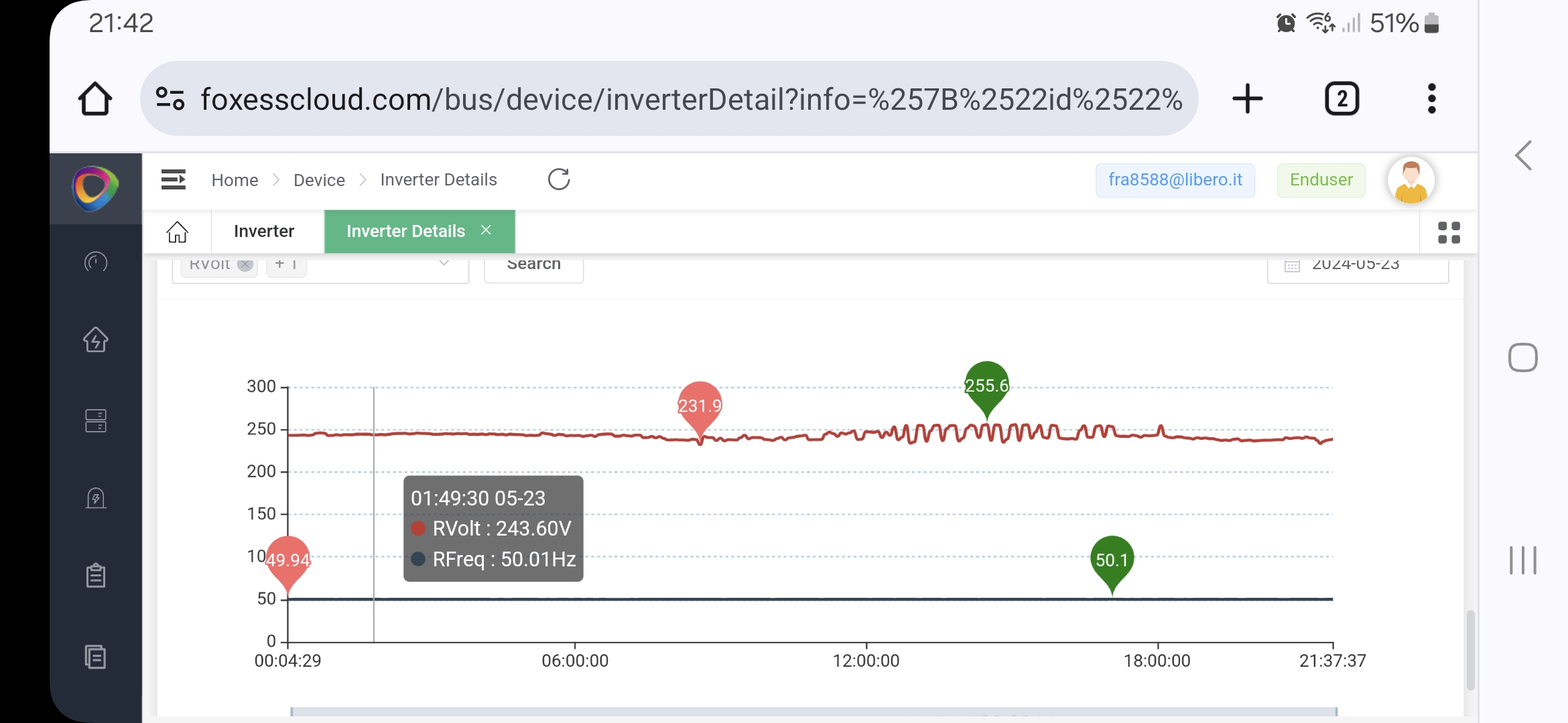

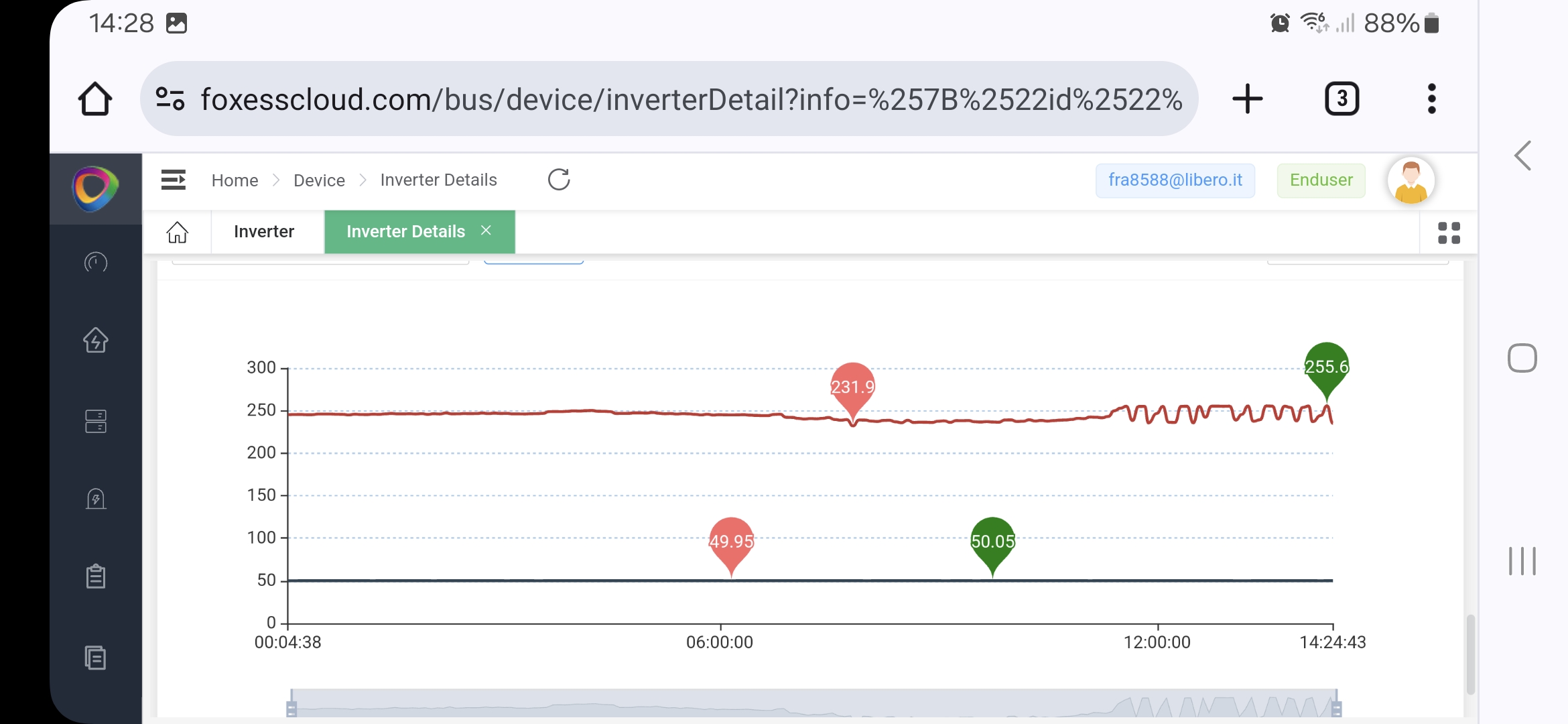

sorry for the many posts here I put the rfreq and rvolt graph and calculate that from around 12:00 I had 6 errors avg set to 253 (done yesterday because otherwise it would give me frequency error while I was using the batteries and I know it's not related but by setting it to 253 it doesn't give me a frequency error) now I put it back to 257 as you told me yesterday and set the DAC lower than 47.50hz
- Posts: 1792
The 10 minute average should only affect your daytime running, the frequency error appears to be a night time thing - I thing what it shows is that your incoming grid power is sensitive to fluctuations.
Just change the fac lower 1 to 47.5 (and keep 10 minute average at 257v).
There are other settings that allow the inverter to respond more slowly to frequency changes but unfortunately you must have installer access and these settings can only be changed using an app and not in the inverter menu.

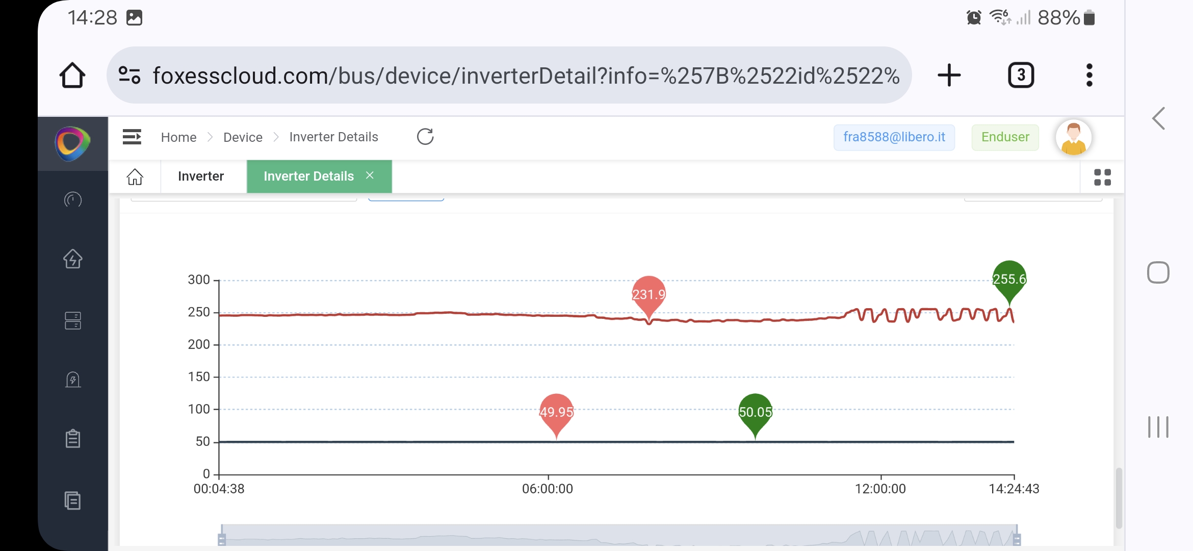

- Posts: 1792

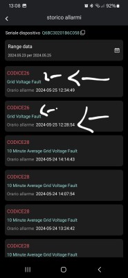

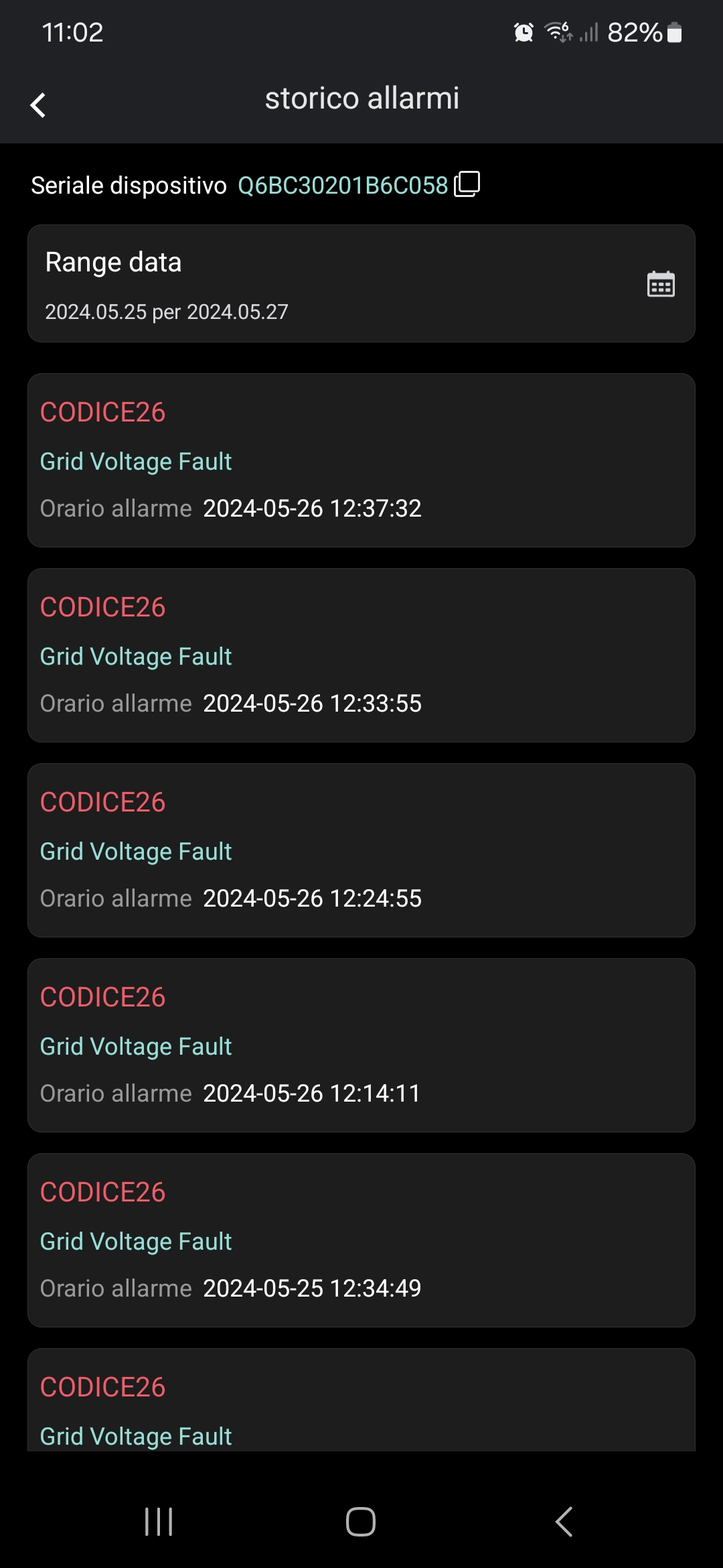

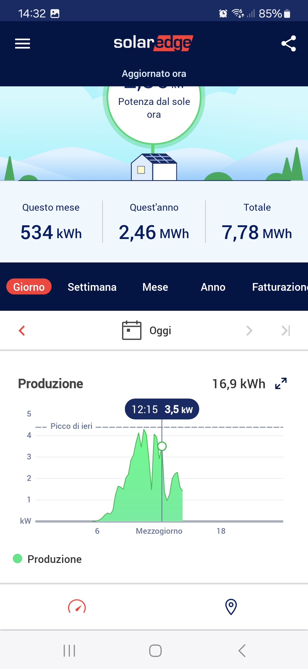

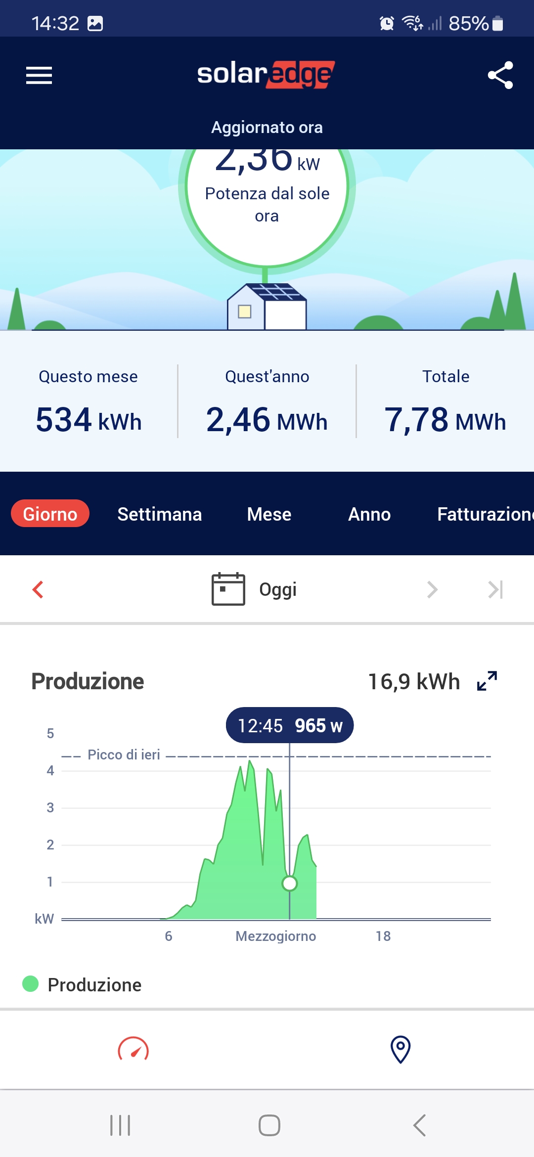

Well, that's different again - this time it's a grid voltage fault - but it isn't a 10 minute fault, which tells me that we have the 10min set correctly but your grid voltage must have exceeded the inverters upper Vac1 voltage (checking back you said it was set to 262.2V which is correct)
The graph doesn't show the peak as it must have happened quickly and tripped the inverter - i'm assuming as it was close to 12 noon, it is a sunny day and you are at peak solar power that is driving this event.
Do you have any other equipment on your grid you can confirm what the voltage was - does your solar inverter have any voltage logs ?.
You can raise Vac1 upper slightly but i'm concerned that your voltage is starting to get very high - is high grid voltage a problem where you live ?

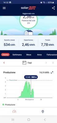

so, unfortunately I have old cables with a small section which when I input a lot go into overvoltage and don't hold up. The problem is that e-distribuzione doesn't change them unless they have knowledge. Another time at around 12pm I was inputting 3 into the network, 5kw (a bit of a cloudy day today for me) and from there the results are the 2 errors and then recover and go back up (at least that's what you can see from the solar edge graph of the first inverter). I don't have anything on the line to measure the voltage. I have never had any surges since I lived here in 2018. The system is new and compliant in every way (no wire joints or bridge sockets, cable cross-section, electrical panel, junction boxes, lines, sockets, lights, kitchen) and honestly I don't even know how. see it. the problem is that if I enter and maybe burn something to someone close to me and they check I can get into trouble, at least that's what he explained to me. Question is it better to have a 10min avg error or grid fault? because in this way I choose the least and I put the soul at peace ahahahahahahah.ah P.S i have ct meter from the main meter to the inverter now I don't know if to the solaredge or the fox ess
sorry but the upper va 1 was at 260.0v could that be?
and vac higher 2 at 264.5.
- Posts: 1792
Ok that makes sense, if you have small section cables when the inverter is exporting the voltage will be much higher than the actual grid voltage.
The AC1 isn’t actually generating anything it’s just reacting to what the solar edge inverter is doing which because of your cabling must be allowing some fast voltage peaks and that in turn is causing your AC1 to trip - it’s unlikely you will cause any damage outside of your property as the grid voltage will be a lot lower when measured outside.
If you had installer access you would be able to control the amount of time before each voltage or frequency event is acted upon - this allows you to filter out any fast changes which would help here, but your installer could slow down the response times.
Unfortunately without installer access you only have access to the actual voltage limits - however because of your situation the AC1 isn’t itself generating the voltage, it is simply measuring what the solar edge is pushing out so you could try raising the Vac1 upper by another volt (to 263.2) and monitor it for a day or two.

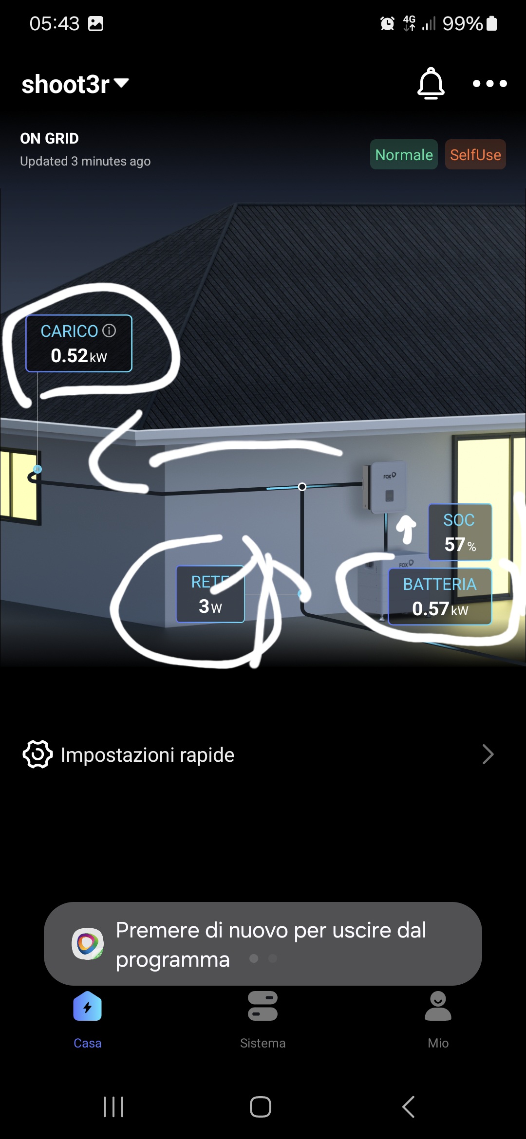

- Posts: 1792
Ok, see how it goes, fingers crossed.

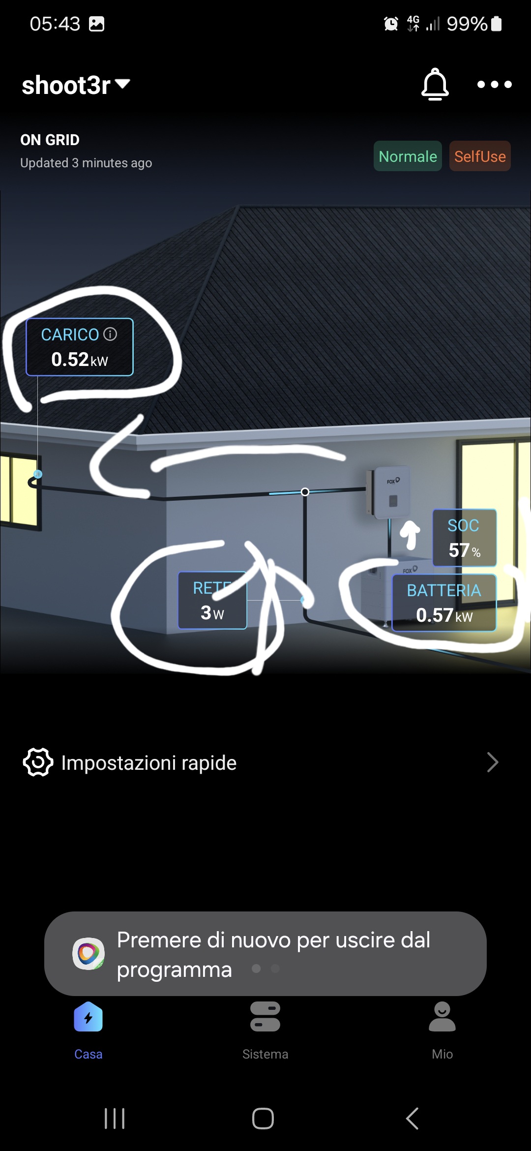

Yes that’s normal, the inverter is grid tied and remains syncronised by taking a small amount of power (a few W’s) from the grid.
The inverter itself takes a small amount of power to run, and converting the batteries power from DC to AC sees some losses as well, so not unexpected to see the battery power being 30-70W below the demand.

Just a couple of thoughts, there’s another way to manage this and suppress the high voltages you are seeing -
Your solar generation is at it’s peak around 12:00-13:00, you could delay charging your Fox batteries until 11:00, then the batteries will be charging throughout the solar peak time and that would keep the voltage low and stop it tripping.
Or you could set the Fox DC charge current to limit the battery charge to 1kW which would mean the batteries would charge slowly all through the day, but that would also keep your house voltage low and stop it tripping.
