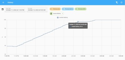

calum
Posts: 404
Location: Stockport
The latest firmware is much better with SoC predictability,
Just wondering what you mean by "latest" in this context? :) I ask because I upgraded the system firmware (for all the components) at the end of April, but I've not looked at new versions since then (too much else going on). I still have the Agent Account and the alternative Wifi dongle so I can do the same process as last time, if things have improved again.
I've just checked the SoC history graph in HA and mine looks very similar to yours, with a "pause" at 96%, so I'll have a play with into the "ramp down from 95% SoC" idea, thanks for the suggestion.

I’ll dig out the simpler automation I wrote for a friend, much easier to implement and just sets the charge current to 5A - back shortly 👍
Code: Select all
alias: Charge Reduction
description: ""
trigger:
  - platform: time_pattern
    minutes: /1
condition:
  - condition: or
    conditions:
      - condition: numeric_state
        entity_id: sensor.battery_soc
        below: 90
        above: 93
action:
  - if:
        above: 92
    then:
      - if:
            entity_id: sensor.max_charge_current
            above: 10
        then:
          - service: number.set_value
            data:
              value: 5
            target:
          - service: logbook.log
            data:
              message: Setting Max Charge to 5A
    else:
      - if:
            below: 90
        then:
          - if:
                below: 10
            then:
                data:
                  value: "21"
                target:
                data:
                  message: Setting Max Charge to 21A
mode: single
There you go, this simply sets the charge current to 5A at 93% SoC and then when it drops below 90% it resets it to the high charge current (in this case 21A)
