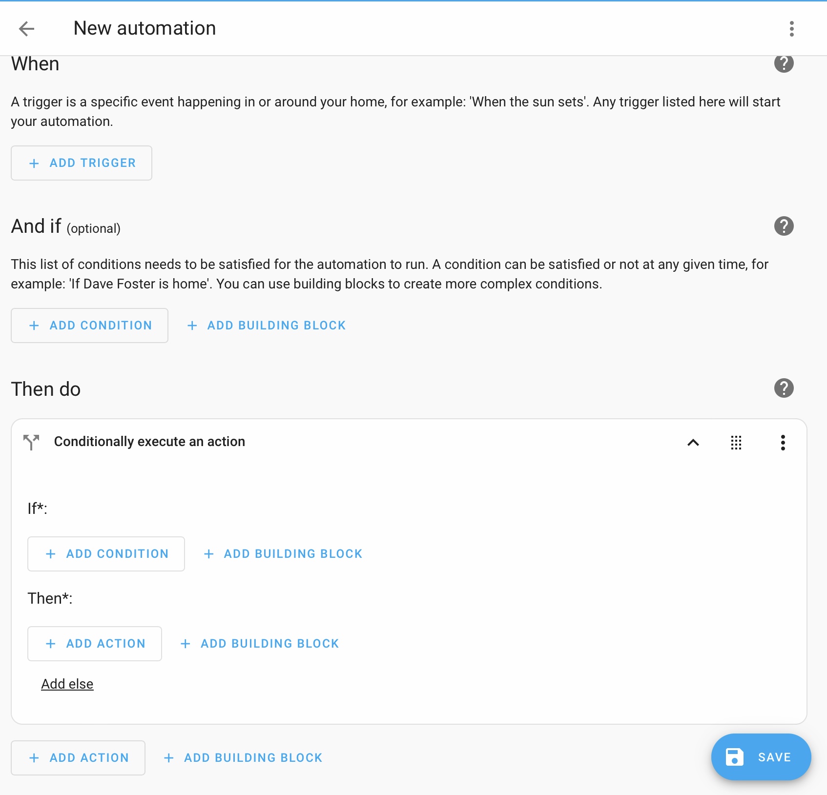

Posts: 1855
The timer state change will trigger the automation
Conditions only give you basic tests, so it is best to use the initial conditions for only the basic stop / go things like your on_off switch and minimum energy
You then do all the meaty stuff in the actions, but using the action
‘if-then’
within that ‘if then’ you set the conditions for the ‘if’ such as ‘
If the max export window duration <= (min export window duration + 0.5)’
And your actions would then be
Set max battery discharge current (number:set)
Code: Select all
action: number.set_value
metadata: {}
data:
  value: "5"
target:
  entity_id: number.force_discharge_power
Set inverter work mode to force discharge
Code: Select all
data:
  option: Feed-in First
target:
  entity_id: select.work_mode
action: select.select_option
Then ‘Add else’ to add and else to the ‘if’
And add the action to start your timer in there.
You can nest ‘If then / else’ by adding more of them within the IF’s actions as needed.
Also because single conditions don’t give you enough flexibility you can add an OR or AND conditions and then have multiple conditions within where they only need 1 to be true for the OR or all need to be true for the AND.
