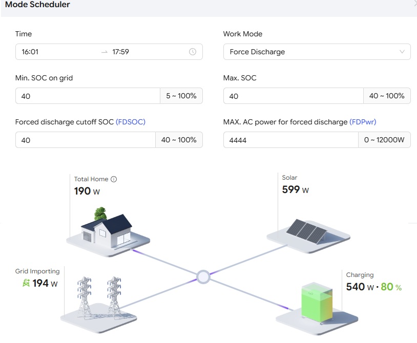

Given the sun today (yeay! :D) the battery is at 80% SoC, so I thought I'd schedule a discharge...
Something is definitely not right because the system changed from importing around 0 to 10W and pumping that and the rest of the solar into the battery to importing 194W !!! :shock: :shock: :shock: :roll:

I guess at this point you can be thankful it at least charged up, looking like a tasty bug at the moment.

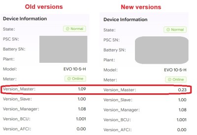

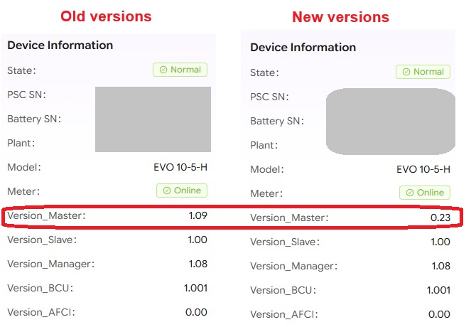

Installer just left - was on the phone to Fox for a while. The lady at Fox checked some settings her end, then conferred with a colleague and advised us that there's a firmware update which should fix the issues. She's going to remotely update the firmware now which should take 45 mins or so. Will keep an eye on it and post another update once the firmware has arrived...
Re: New EVO 10-5-H only charging at 1.06kW
Very good, are you setting up a small charge for a few mins afterwards to check?
A charge and a few other things too! :)

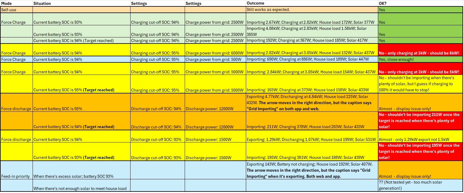

So the new version is just one change: "Master" goes from 1.09 down to 0.23 :shock:
Much better than before but still a few issues:
Force charge: now works, but only at max 3kW. It should go up to 6kW max if I'm reading the spec sheet correctly ("Grid Input Max Apparent Power: 6000VA; 27.3A max per phase") ?!
Force discharge: now works, but it imports about 200W once the target is reached even when there's plenty of solar. (Not ideal but I can live with it!) There is a display issue with it saying "import" when it's obviously exporting!
Feed-in priority: now works. There's the same display issue with it saying "import" when it's exporting.

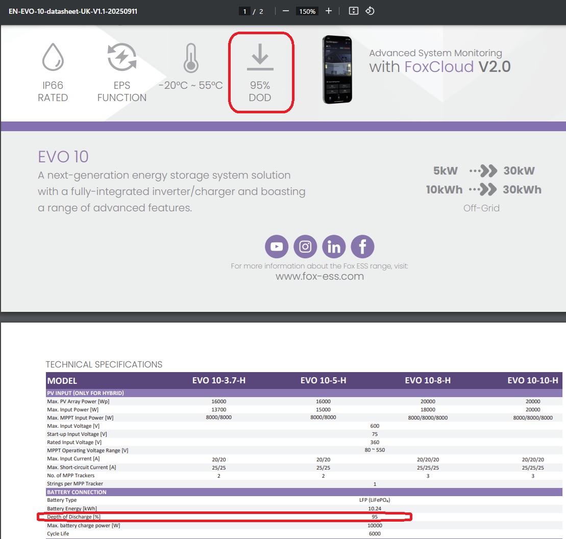

Also noticed that the system Max and Min SoC are set at 100% and 10% which gives a DoD of 90%, whereas the spec sheet says "95% DoD", so have asked the installer about that too... :(
The DoD values can be region dependant.
The same battery for the UK market can have 90% DoD, and Australian market for example has 100% DoD. Suspect it's about our much lower Winter temperatures.
That being said, if they state 96% for UK market... then add that to the bug list.

Yup, the datasheet on the UK site https://fox-ess.uk/downloads/#datasheets says 95% DoD twice!
Robbing bar stewards!
It might be blocked still if the FW is not mature enough, or they changed their minds for the UK market, but didn't update the sales blurb/spec sheets.
