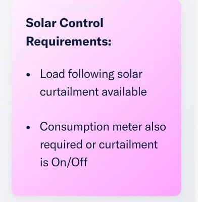

I am considering joining Amber VPP, and they said a smart meter, such as a DDSU666, is required to facilitate solar curtailment. Please see the attached image below from Amber.
I am just curious as to why additional energy monitoring devices, like the DDSU666, are necessary when a KH inverter equipped with a CT clamp appears capable of providing similar functionality.
I appreciate your insights on this matter.

I'm really not sure why that is, the KH can certainly do what it needs with just a CT clamp - the only thought I would have is that when they say consumption meter, they may not need it for KH control, rather they need it as an energy counter they can access so they have an independent figure of how much electricity you are using (which is a bit like the 'smart meter' we have here in the UK).

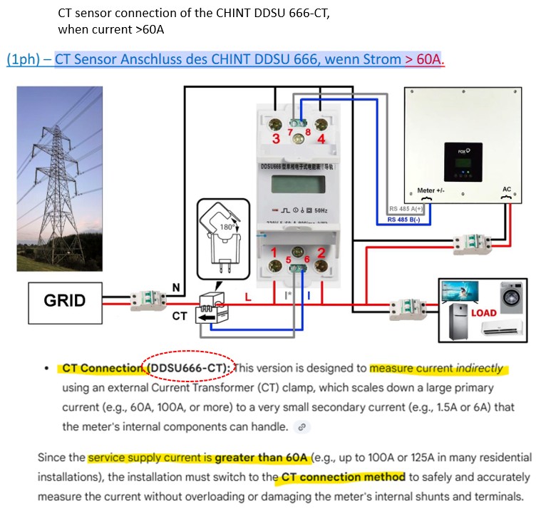

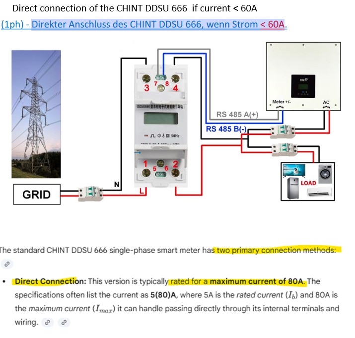

I was also searching for this answer. So I merged what I found from German notes (Fox installer?) & Gemini responses.
DDSU666 and/or CT clamps are necessary when we want to curtail our export to the grid.
The inverter is able to measure the energy (Volt x Ampere) in & out of the consumer meter box using these devices.
