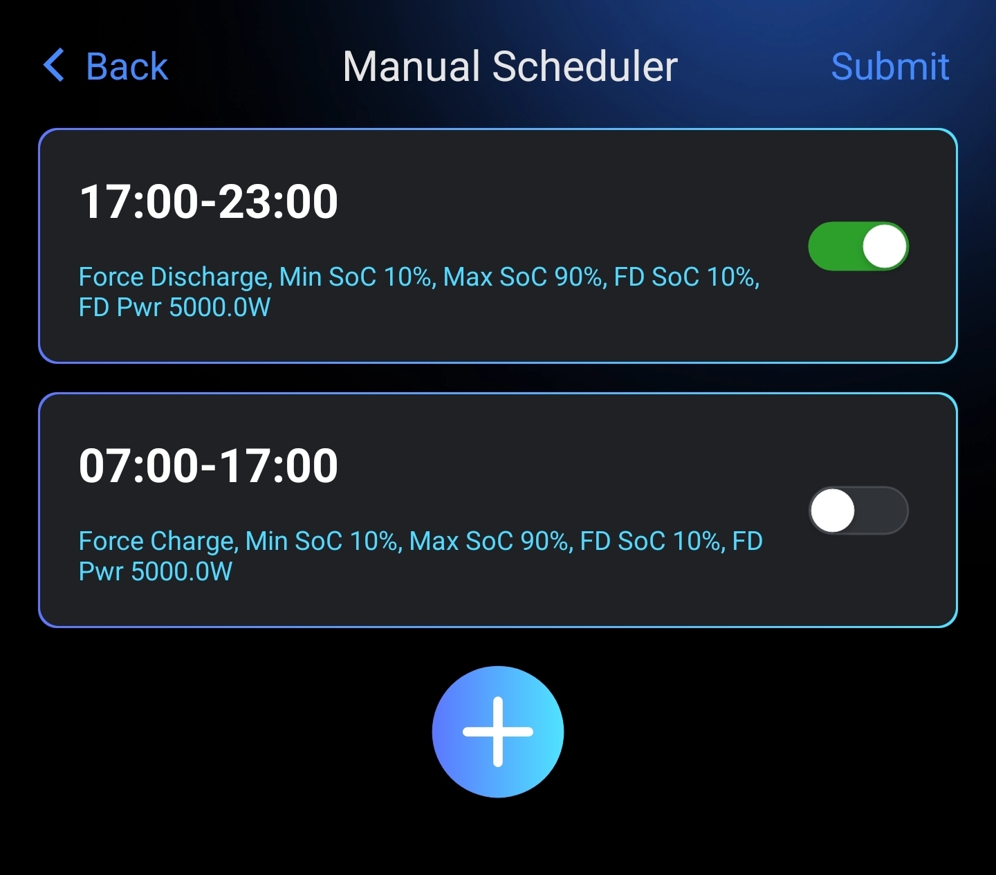

Hey guys, I was wondering if anyone else had this issue and has managed to fix it.
During those times, the household power usage is around 1-2kw/h.
I am curious to know why the batter/inverter is only providing the household the power and not exporting 3/4 kw/h into the grid.
If anyone could help, it would be greatly appreciated.
I can provide a screenshot of the issue in 5 hours or so when the parameters should be working but does not.
These are my forced discharge parameters during 1700 and 2300 hrs.Schedule looks correct, can you start by checking your export power settings - at the inverter panel go into Settings, On Grid, Export Control and check the parameter ExportLimitPwr is set to (at least) 5000 watts, and ExportLimitCur is 100A.

It's sorted itself out. I asked Fox to update the firmware which was 2 patches behind and now it's discharging into the grid.
