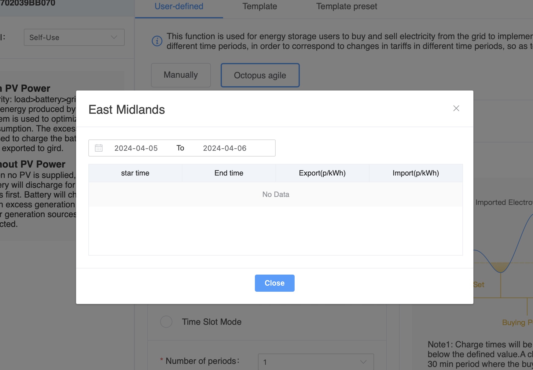

However - it doesn't seem to be picking up the Agile rates. If I click on the "View Rates" button, it returns a blank table showing my location as East Midlands rather than SE England. No rates populate and I would expect to see a set of half hourly rates.
I also get a "40257-Parameter does not meet expectations" error.

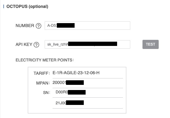

My Octopus API is set up in "My Sites" and pressing the "test" button returns the Agile tariff name, my MAPN and the meter serial number. So I think that's all correct.

I have the same issue, except the East Midlands list is populated with times and prices (not my area).

After clicking 'test' you then need to click 'edit' at the bottom of the page. Not intuitive and I suppose it should say 'save'.

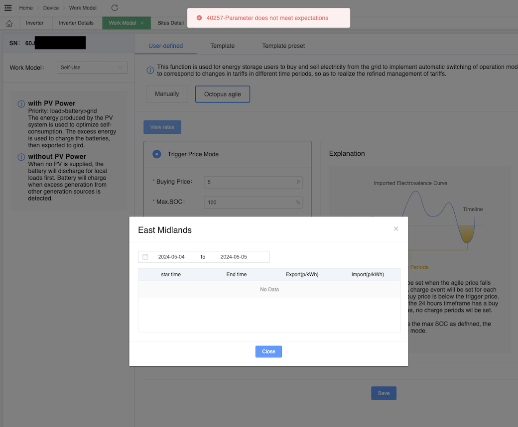

Running H1-6.0-E-G2, Master : 1.22, Slave : 1.02, Manager : 1.34. Put the Octopus customer ID and API key, clicked TEST with positive result of the tariff/MPAN/SN below. Did click the "Edit" button at the bottom after TEST. Also did shutdown whole system after upgrading to 1.22 master and 1.34 manager. Going to Work Model but checking the "View rates" still shows the error "40257-Parameter does not meet expectations". See screenshot below.
Appreciate if anyone had similar issues and found the fix at the end. The only reason I could explain is the Octopus side as I have not received the MCS certificate so Octopus may have to update my tariff to the one that Fox can understand.
