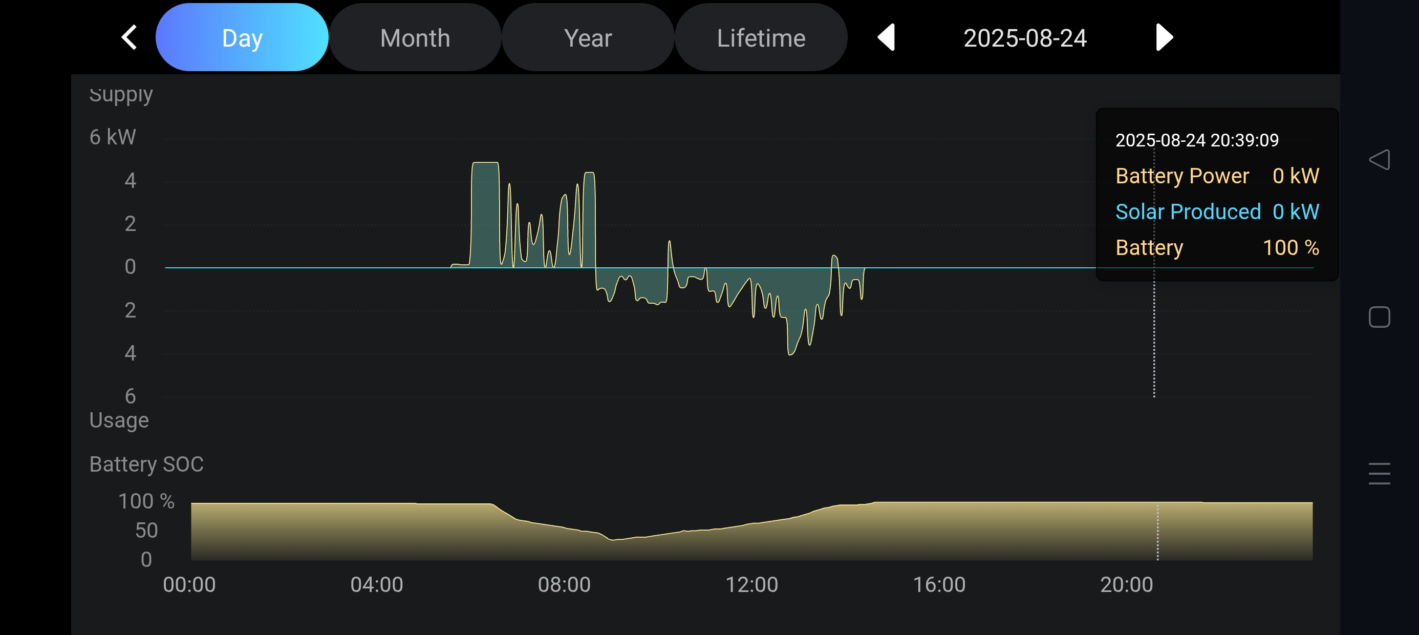

Although I only use the battery in Self-Use mode, it behaves abnormally:
Even when the battery is at 100% full, in the evenings—when I have high electricity demand—it still draws power from the grid instead of discharging the battery.

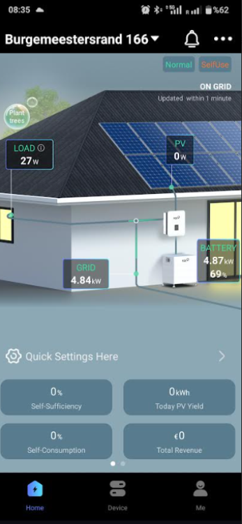

Around 8 AM, the battery suddenly discharges into the grid, even though I don’t want it to.
Then, at noon, it charges itself again from the solar panels.
I have tried many times to reconfigure the settings and restart the device, but nothing changes. Some days it works as expected, but on other days it behaves strangely (as shown in the screenshots I attached).
Please help me resolve this issue. I cannot continue with such unreliable behavior after making such a large investment.

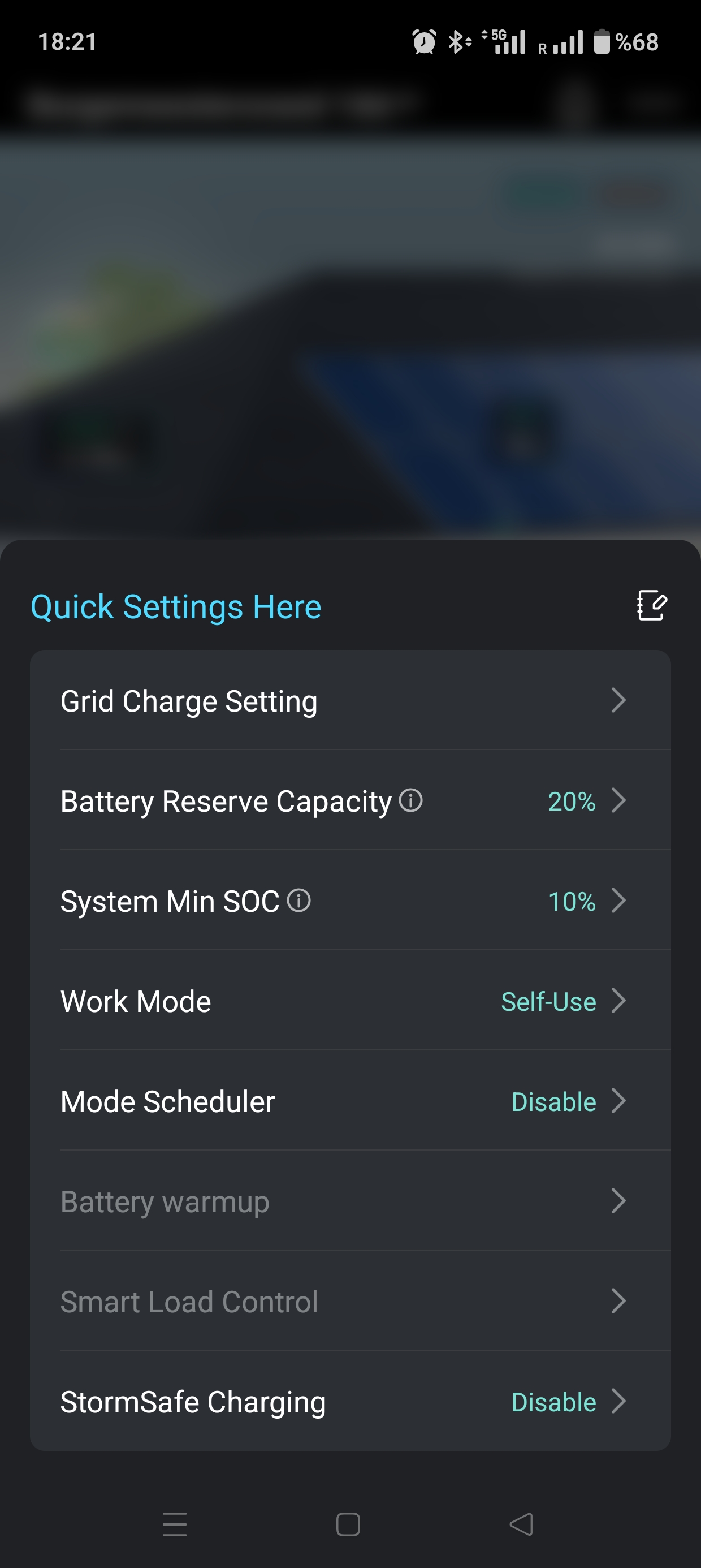

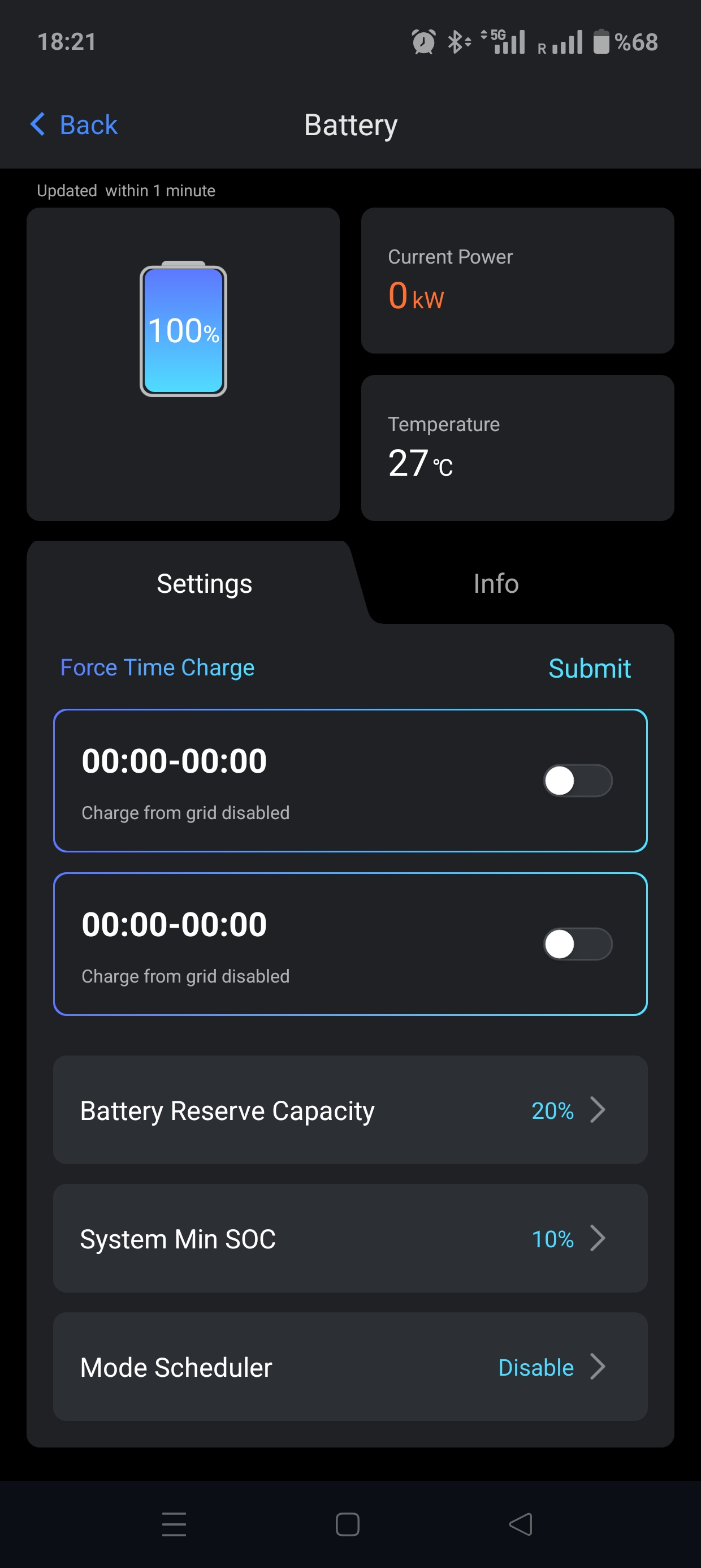

What are your min soc and reserve soc set to when you click on quick settings from the plant view?
Re: Subject: Fox Home Battery – Abnormal Operation, Urgent Support Needed
Hello I have attached the information. Letme know if you need anything else. Really appreciated your help
