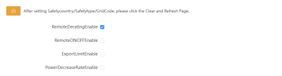

Does anyone know how to Disable Export Limit on H3
That option is available on T series
Set the export limit to 0 to disable the export limit
